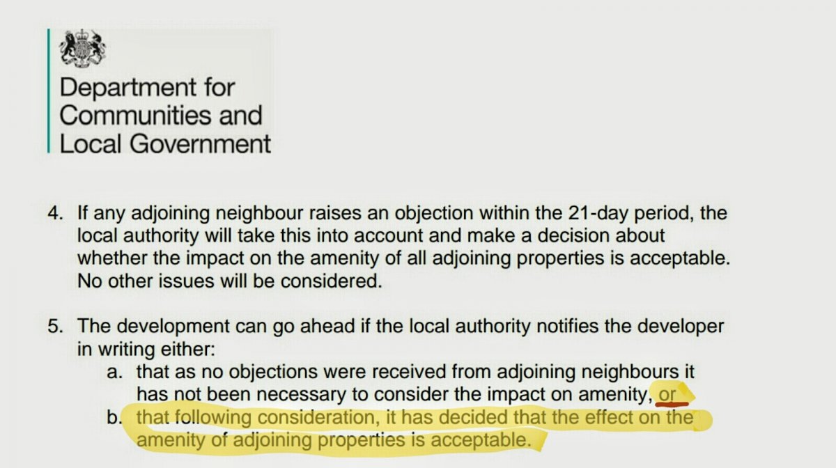

If the scheme is compliant then the LPA can only refuse prior approval if they receive an objection from a neighbour. There is no provision for the LPA to have regard to their development plan.
The LPA does consider the effect on the amenity of the neighbours irrespective of whether they get any complaints or not. It's in the guidance.
It seems the LPA can object regardless of what your neighbours say as with any planning application. Confusing for a newbie to planning like me.
No; the LPA can only state it is not p.d. if any neighbour complains (on any grounds - not just amenity) and the LPA itself thinks it does have an impact on amenity. If no-one objects within the 21 day period, it is p.d., regardless of the opinion of the LPA.
Here we go
