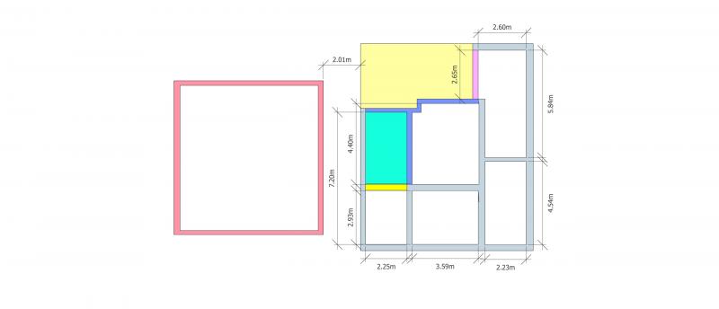

I've read carefully the advice on the planning portal, and believe that my planned extension does not need planning permission. I'd like to get an LDC for peace of mind, but thought I'd run it past you lot first.
Does this look like permitted development? My council allows permitted development.
I also believe I will run into the party wall problem. So expect the route is lots of friendly liaising with neighbour and carefully worded letter to elicit agreement. How rife is the scaremongering by the party wall brigade touting for business? And will they be able to see info for my development if all I have lodged is an LDC?
What is the recommended course of action wrt party wall here? I don't believe I will go below neighbours foundation, but of course have no way to guarantee this.
Anyway the detail.
The attached plan shows my house on the right with yellow planned extension. The pink walled house on the left is the neighbours that looks to be affected by the party wall problem.
The green area is a change of use from garage to living space.
Blue walls are coming out and are load bearing.
Pink wall is coming out and just supports existing lean to roof.
Yellow wall is new wall to split garage.

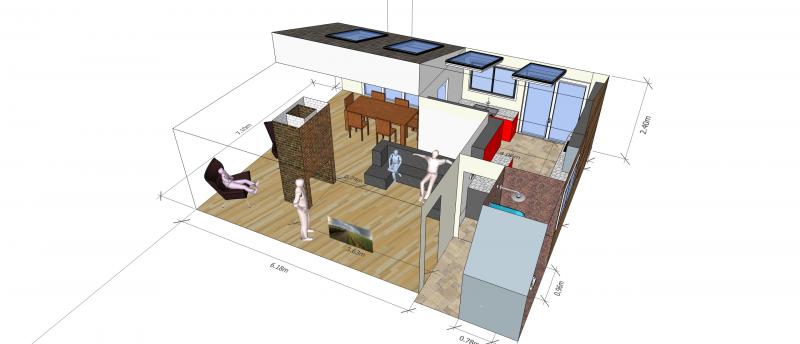

3D view perhaps gives a better idea of intended finish.

This is one of those pesky "is it a rear extension" OR "is it a side extension" conundrums.
A sneaky planning officer could argue it is a side extension and therefore too wide to be permitted development. Bloody stupid rule in my opinion.

It looks like a side extension because.....
"the enlarged part of the dwellinghouse would extend beyond a wall
forming a side elevation of the original dwellinghouse"
The pink wall to the rear projecting part of the house on your sketch looks like a side elevation. If that is the case any Planner worth their salt would reject your LDC.
Your architectural designer should have explained that to you.
As for doing the foundations in stealth mode! Great way to fall out with the new neighbours. Why don't you just try being nice to them, they've probably never heard of the Party Wall Act and do not want to make a fuss if they think you are a descent person. In my opinion the 3 metre rule is just wrong so that is the advice I always give my clients and it usually seems to work. It only seems to get messy and expensive when one neighbour tries to pull a fast one and the adjoining neighbour gets all legal or there is an existing grudge between neighbours.

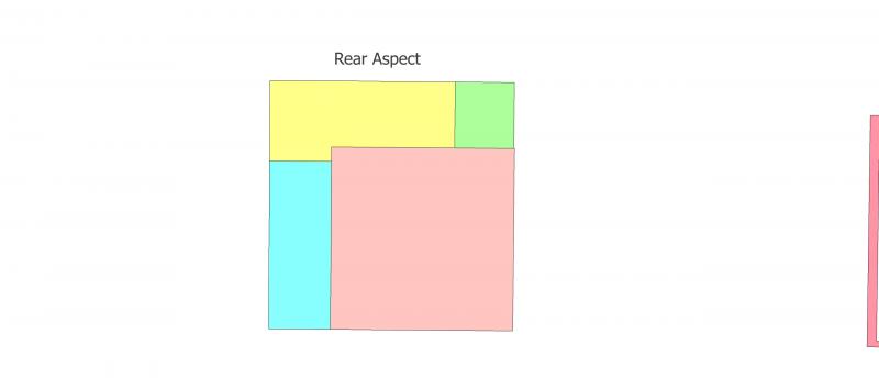

Just to be sure you have this right since the pink wall is not part of any side elevation.
On this simpler plan
Pink: Original house - 1950s
Aqua: Side garage & 1st floor extension - 1979
Green: Rear kitchen extension - 1985
Yellow: Proposed extension
I see that it is a side extension to the original house (ie if the garage wasn't there).
So the rules are applied to the original house, not as it stands now? This must be black and white, though I've seen no mention of this.
Though on rereading the PD guidelines it seems this is moot anyway, it states that side extension is part of PD up to half the width of the original house which it is well within. Or is the planning portal out of date in this respect?
No idea what I'm going to do about the party wall problem yet, just canvassing opinions.
The yellow part would need planning permission because it extends beyond a wall forming a side elevation of the original house and is more than half the width of the (original) house.
(For Planning purposes, it would also be regarded together with the kitchen extension as one large extension).
Ah I see, ambiguities at every turn. I'd thought it was just that the part projecting at the side should be under half width.
Well that clears that up, PP it is. Thanks.
Tony, would I be correct in thinking that if the yellow extension stopped in line with the original rear addition, this would be permitted development? Might not be suitable for the OP though.
