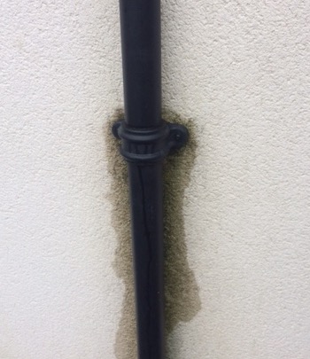

he roof has a flat 1 foot approx walk way round the base of the tiled roof part.
The box gutter is incorrect. It should sit lower so the tiles finish over the box gutter which should be deeper - exactly like a normal gutter.
Underneath the tiles there should be lead flashing or some of the box gutter material running up the roof.
Box gutters are prone to leaking during snow because they get filled up with snow drift.
Same problem with leaf build up.

The second roofers installed a membrane running from under the coping stones, down the inside of wall, across the flat part and slightly under the tiles I believe.
The debris did gather up, in summer it turned to the green slimy mess, then when it rained enough, this would flow out and down the white render because there was a slight gap between the exit box and the roof. Water would also run down the back of drainpipe, hitthe fixings and spread dirty stains everywhere. The downpipes are not straight, they are warped, touching the render in multiple places.
