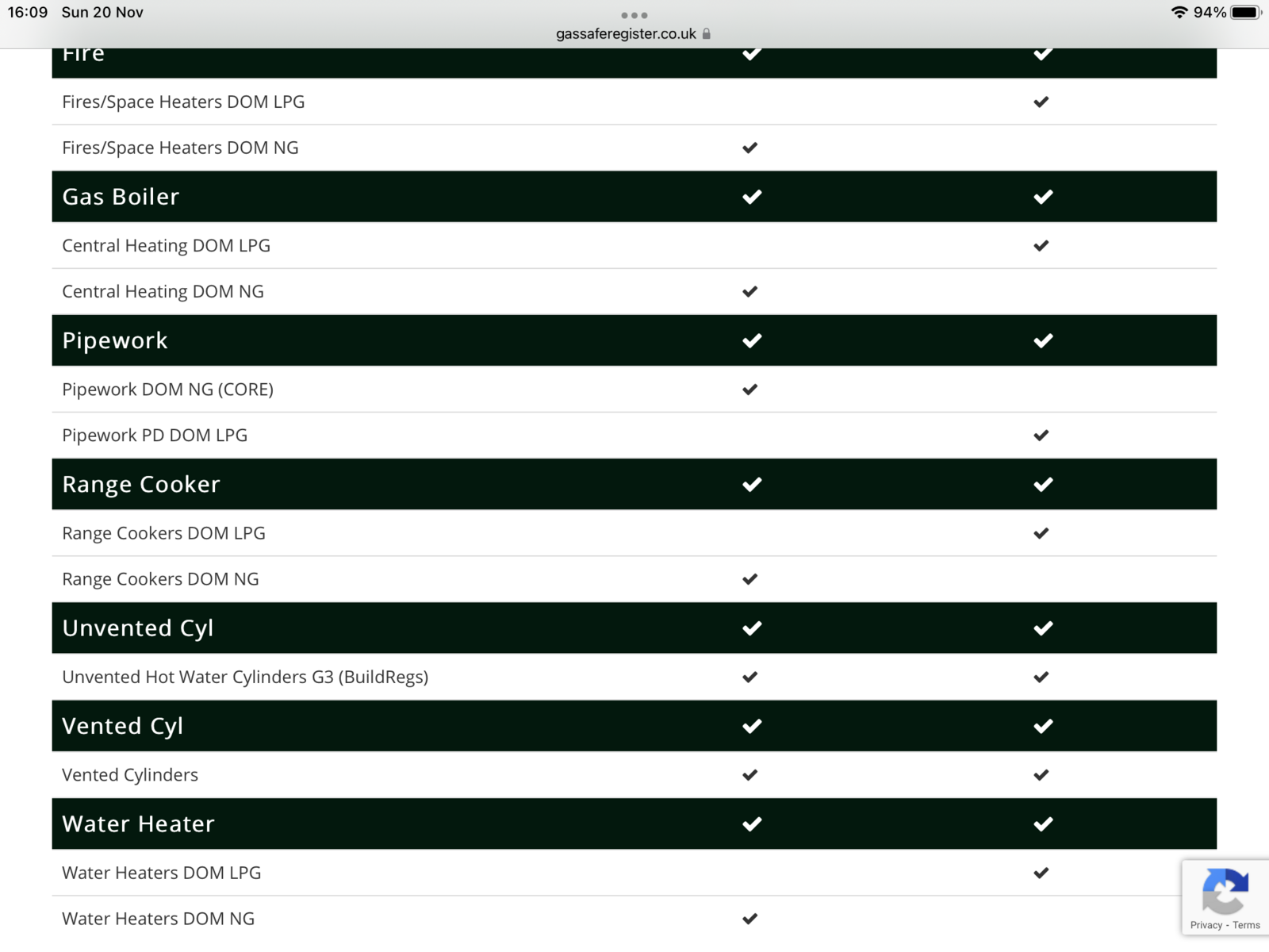

I would imagine it would look like this if an engineer was LPG qualified:

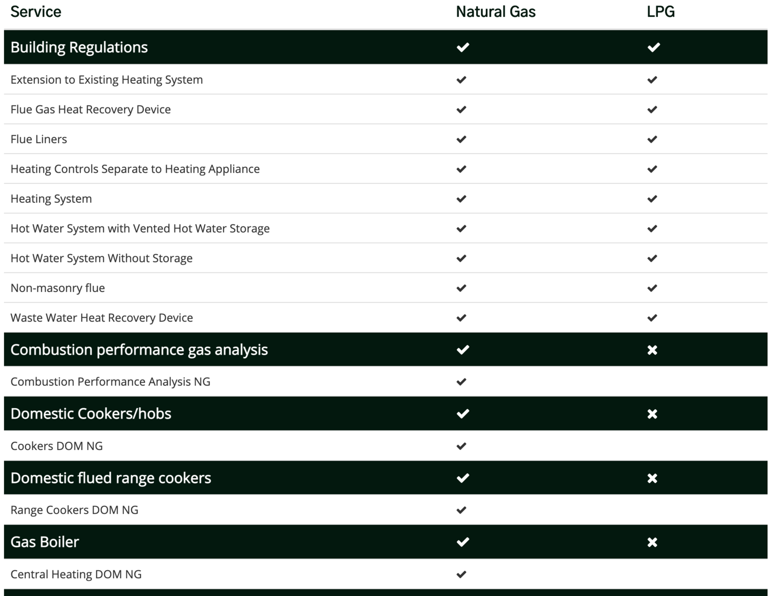

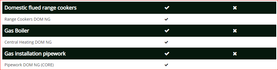

But if they are not LPG qualified or Gas Fire qualified it actually looks like this:
It is easy to see which qualifications they do have. Not so easy to spot the qualifications they should have but don't have. How does your average consumer know that gas fires require a separate qualification when they look at the above page which doesn't mention them at all. The gas boiler does have an X in the black header for LPG.
This is exactly how it looks - no qualifications for LPG.
The company are saying that John Smith (the chap on the cert.) came to commission the boiler. I wasn't home on the second day so this is possible. But neither him nor the person who installed it show as being gas safe for LPG.
I'll be contacting Gas Safe tomorrow to see where I stand and what steps I should take to ensure the boiler is safe.
Deeply confusing site. So this person should not have installed or checked/commissioned an LPG boiler?

Is that screenshot from the company's entry on the register, or the individual engineer's entry?
EDIT: I've only looked at a few, but those fields look like the ones I've seen on the company entries.
That's the guy who apparently commissioned the boiler. The engineer's page is exactly the same, as is the company's page and the owner of the company's page.
No-one involved appears to have any qualifications to work with LPG other than within the "Building Regulations" section.
I've only looked at a few firms and engineers, but those fields in your screenshot look like the ones I've seen on the company entries. For example, the firms seem to say "Combustion performance gas analysis" and "Domestic Cookers/hobs" like your screenshot, whilst the engineers seem to say "Comb Analysis" and "Cooker". But I've only looked at a few. It's very confusing.
