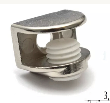

I thought of adding some Perspex strips about 85x3cm and fixing them with one of these on each end:
Do you think the Perspex at 5mm thick would be strong enough to retain books over that length or should I be thinking to have the Perspex deeper with a couple of fixings along the bottom?

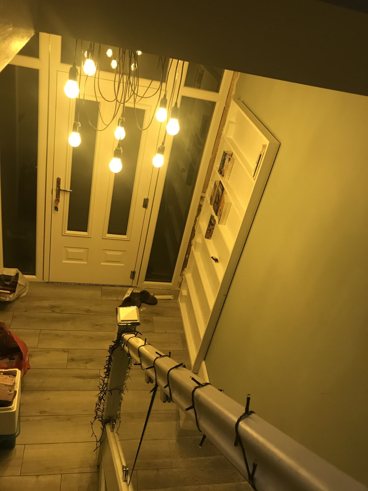

This is it:
And the Perspex would go where the metal strap is to stop the books falling forwards:
It’s 205cm tall, 86cm wide, 70mm total depth with 50mm deep shelves.

Maybe wrong. At first I was going to cut the books and glue them on but the I realised on the lower shelves you would notice they aren’t real books.
With the perspex I could slip a real book on the shelf sideways. I could also put some photo frames or something on it.

I did screw a few together but it was only after I put them on a lower shelf that it was obvious they weren’t real books. I should have got the books first and spaced the shelves so you couldn’t see the depth of the cut books.
as the shelves have ends and are perhaps 90% decorative and not in the least practical not sure why you need ends ??
if this is fully design over function then glue or stick with double sided tape to the wall otherwise put a perhaps 7 degree angle on the shelves to hold the books back
