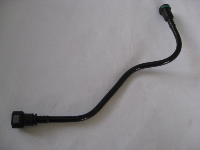

Could I just check something that looks a bit of a bodge job with you all?
The vacuum hose (plastic) from the manifold to the brake cylinder has a short piece of braded hose over the end connector (at the brake cylinder end) held on by two jubilee clips. Should this be here? Could it indicate that under the hose is a leak that someone has attempted to bodge this in the past?
Millerman - big favour - could you check your wifes, for reference?
Thats a fairly common method of joining two semi rigid pipes together, and it appears on many cars.
Doesn't mean that its not leaking though!
John :)
Thanks John.
Just did a quick check on ebay and found a replacement vacuum hose, which has push connections at both ends. So it shouldn't need the hose and clips?
Thoughts?
So long as it can plug into the servo, then there's no problem with that.
Originally these pipes had the flexible coupling to accommodate vibration from the engine.
Of course, you could try wrapping the existing pipe tightly with tape, to see if that changes things? Only personally speaking, I've never had to replace one of these due to perishing.
You don't think there could be a slight leak through the brake servo, do you?
