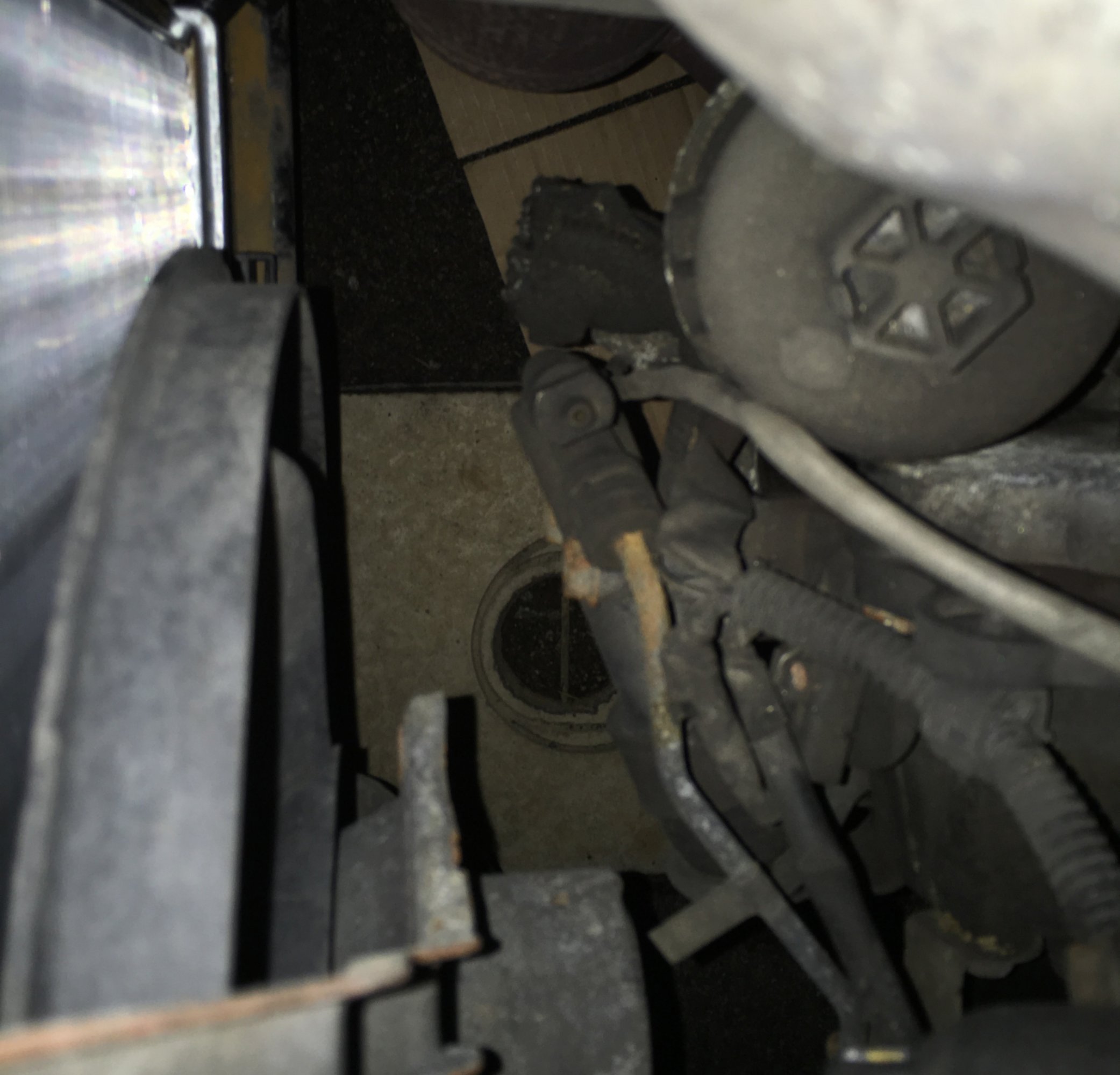

I don't think it's a bayonet connector, here's some pictures.
IMG_0180.JPG This is the culprit.
IMG_0183.JPG It's the same connector as this one.
rad.png Here is the rad where it connects to.

The round plastic thing with the moulded hexagon on it is the oil filter housing top.....the paper oil filter element lurks underneath this.

Yes I will keep an eye on it. In the picture, if you look to the left of the oil filter housing there is a black cylindrical shaped thing with a pipe sticking out of the bottom of it, it is this device that has some sort of bleed nipple on that I was referring to. Think I might buy myself a Haynes manual.
Ah, sorry Mike I couldn't see that one!
No idea what it is, really but it isn't a coolant bleed....at a guess, if it is a bleed nipple at all then it could be the clutch slave cylinder.
I doubt if Mr. Haynes would know either :eek:
John :)
