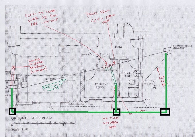

I think the old toilet exit wasn't sealed up right. We don't know where it was (due to partition wall changes) now and all we have to go on is the cctv which uncovered that manhole cover.
Really appreciate your help but I think this is the only thing left to try.

Here are the plans which include the soil pipes. You'll see that the new soil pipe goes immediately out the house. The smells are worst in the utility and downstairs toilet. I think that redundant pipe (green) is to blame. This is why I want to dig up the floor.
Repairing that pipe may work for a few years but a run of sewer pipe under a building is best removed.
If you are keen to dig then install a new run outside the house.
Hire a mini digger and it could be done in a day, two at the most. Then fill the old pipe with concrete.
If you are derrmined to solve the problem by digging inside the house then you really must locate the source of the escaping fumes. A smoke test might help to locate the leak.
Bear in mind that fumes can pass along the gap between a sewer pipe and the soil around it and come out of the ground at a weak point ( like the manhole in the cupboard ) that is several yards away from the leak in the pipe. It would be very demoralising and expensive if after all you work the fumes find another weak point to come up into the house.

We never had sewage smells before the building work was done. This why I think the green pipe where the old toilet used to be is the culprit. When it's wet and rainy the smell is worse.
if that is the case then opening up the manhole and blocking off the redundant pipes should do the trick
You'd think so. Christ I hope so. I might see if I can just seal that part of the pipe rather than trying to fill the manhole. I've got one of those rubber bung things you screw to tighten so maybe use that and backfill with concrete. I suppose it depends what I find digging.
