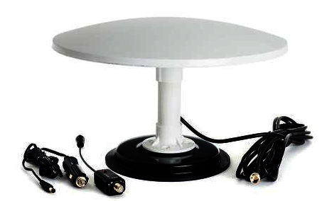

These tv aerial.jpg must be one of the worst ideas for TV aerials, omni directional so no gain, they rely on 12 volt powered amplifiers to boost the signal, but they are used with so many caravans and 9 times out of 10 work, how much they rely on the metal ground plain I don't know, but all the training I got when I wanted to sit my RAE told me they are a daft idea, however they work, even claimed as duel band VHF and UHF.
I think the fact it is omni directional helps, as so often whole reason it does not work, is aimed wrong.
These View attachment 194335 must be one of the worst ideas for TV aerials, omni directional so no gain, they rely on 12 volt powered amplifiers to boost the signal, but they are used with so many caravans and 9 times out of 10 work, how much they rely on the metal ground plain I don't know, but all the training I got when I wanted to sit my RAE told me they are a daft idea, however they work, even claimed as duel band VHF and UHF.
The motivators for the caravanning crowd are different, IME. There's more weight given to aerodynamic designs that can survive a motorway journey to a site, and that need no adjustment once the 'vanner gets to their pitch.
In some respects I think 'vanners are taken for a ride by the accessories stores and dealerships they visit. There's quite a bit of "ooh, it's special, just for the caravan market", so they end up paying £90 for a tiny omni in a plastic cowl. Of course, it's a hobby, and with hobbies we tend to overindulge a bit. There may even be some one-upmanship; having this or that caravan aerial stuck to the roof being used as a status symbol more than anything. :LOL:
I've done bits for the caravanning crowd, but mostly it's been narrow boats in my local area for the mobile crowd.
They both have similar problems: The aerials have to be suitable for travelling. With boaters, it's the low bridges. They can't have anything sticking up too high. The other issue is that a lot of mooring sites and marinas are away from residential areas, so they're in signal black spots relatively. This is the case with many caravan sites too.
Log Periodics are great for both crowds. With vanners, a jockey wheel clamp, pole and aerial works far better than the omnis. Amplification can be added if required. With a flat aerial, it can be laid on the floor of the van when travelling. It's simpler to manage than something with large reflectors. Additional amplification can be added if required, especially where the site has a 240V hook-up.
I'd recommend a small Log Periodic for anyone in need of an indoor aerial on a similar basis. More metal, and pointing all of it in the right direction, is going to work better than some tiny omni where at best there's a 30 degree arc of metal kind of pointing at the transmitter. That's just 12% of the aerial's catchment area.

I also have a motor home and carry a wideband 12 element yagi, a 2 piece ali pole and ground stand. One site I went to in Dorset the site manager said if I wanted TV I would need a big high gain aerial and amplifier. I looked around and could see people were struggling. Most had omnis, some had directional aerials in the direction of Stockland Hill. Funny that I thought nearby houses seemed to have aerials pointed the other way (Rowridge). I tried and could get signals (no amplifier) from both transmitters but Rowridge worked well and Stockland Hill was blocky.
For the few days I was there I had the best TV reception on the site.
