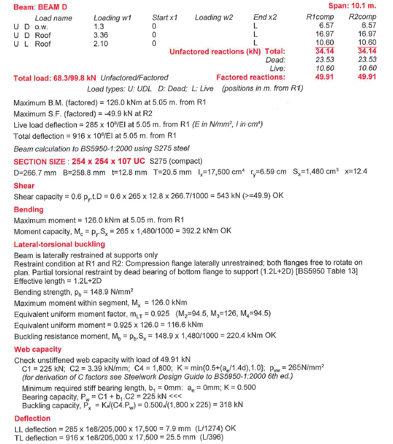

I have an old farm building that I want to re-roof with a load bearing steel ridge beam. Currently the roof comprises a few beefy king post trusses, approx. 8x5 (?) purlins and 4x2 rafters, all have had it. The building is around 5.5m wide and 10.2m long. I intend to support new 6x2 rafters off the steel and the walls to give me a fully vaulted interior. Roof angle is 45deg it it makes any difference. I will tile with modern concrete tiles like Marley Mendips.
I had the calcs done a long time ago by an SE, he determined a 254 x 254 x 107 UB.
The two end walls of this span are both solid 9" brick, except that one end has two windows that will need bricking up as I go that the pier at that end could be tied into. The other wall is an internal partition wall.
Can someone detail the internal piers I should build to support the steel and how I would tie it in to the two end walls, they would need to be around 5m high from FGL. Bricks, blocks, hollow blocks whatever.
No BC or planning, I just need it to be of sound design.

Regards your query about the UB or UC, the calcs state UC but the associated sketch he did says UB, I never noticed that before:
Ah okay I'm with you. The UC makes sense as it's a 10.4m span. Seems a shame to get rid of king post trusses but is what it is.
Those calcs look like they are from Superbeam. If so, I'd suspect the person who used that was not a proper structural engineer.
