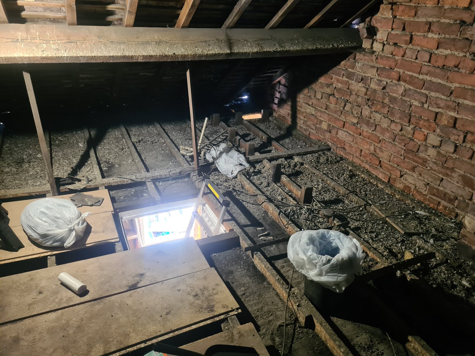

Cheers Pete, they were getting in through a missing tile on the roof, now replaced.
The insulation was packed tight to the eaves, good tip re ventilation, will have a think about that.
I might get pest control back in when it's all clear and get them to fumigate it again as well.
Did the final push today, another 5 hour stint.
All shovelled up and bagged up, just need to go back in with vacuum cleaner and get the dust up.
Took a before picture but by the time I'd finished I just wanted to get out!.
