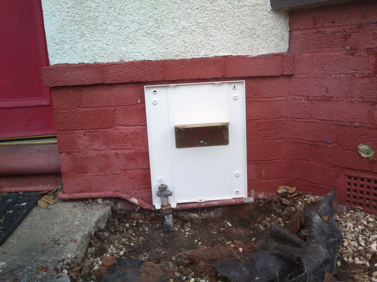

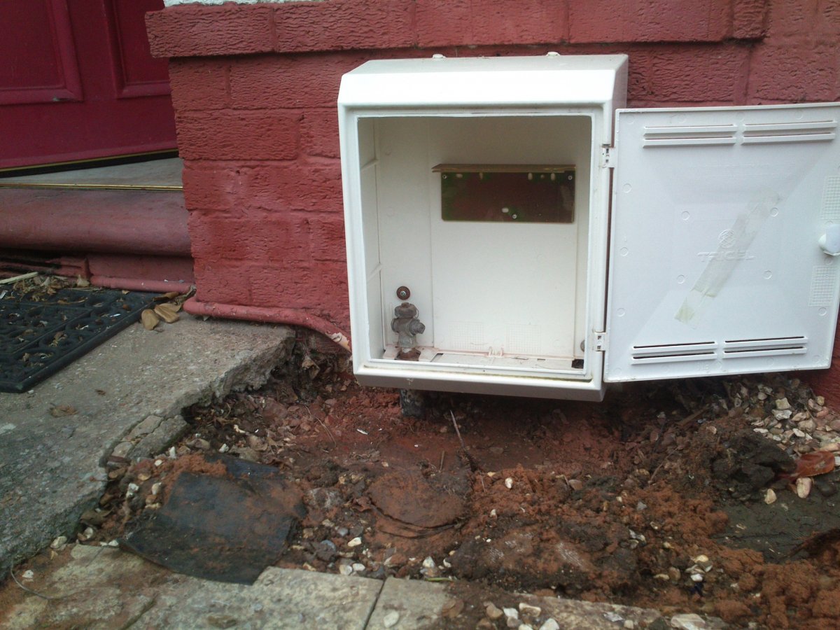

OK, I've gone with FiremanT's suggestion of putting the white box on the ground although I haven't had time to do any masonry. For the moment I've lowered the ground level by about 9" and reassembled the meter box so that the ECV is sticking up into it. If BG are happy with that and will fit a meter into that box then I reckon I've saved myself £400 :)
(Note that the ground slopes away from the front of the house slightly, and on the other side of that wall is my under-floor crawl space that is about a meter deep so I highly doubt that water will collect in the bit I've dug out, but I'll keep an eye on it)
View attachment 104607 View attachment 104608
Anyone see any major problems before I ring BG to put a meter in it?

looking at your pic the main tap fitting is exactly the right one for a box to be positioned back onto it .
Big snoopy amuse me why ??? was the box too close to an air vent ????
@gas112 Glad you said that about the fitting. I thought the fitting might be designed to go through a box, even seems to have a rubber washer on it. Trouble is the large nut that looks like it's designed to hold the box (not the one holding the ECV on!) is rusted solid, and one thing I am NOT going to do with a gas main of unknown age, condition etc is put a spanner on it!
pipe exiting ground below main tap is grey fibre glass ? ,That case the service is actually plastic and that is just a protection sleeve around it .
Yes, the bit you can see in the pictures appears to be a protective sleeve. If I hold the ECV I can wiggle it side to side slightly inside the sleeve.

In case anybody comes across this thread in future, I now have a gas meter installed. They were unhappy that my ECV had no handle on it when they arrived and he had to call Wales & West to come and fit one, but as for box\ECV placement they couldn't seem to care less.
