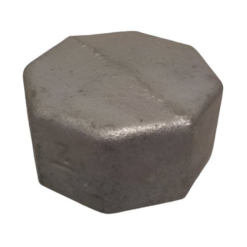

I expect it will be nominal half inch
(This is almost the internal diameter). From memory the external diameter is about 3/4"
I forget the usual length of pieces. They were made to fit on a builders van. Maybe ten foot? The ends are threaded and there is a screwed coupler to join them, about one inch O.D. or a screwed female elbow to change direction (leaks are common at the elbow due to cavitation corrosion).
The first and last lengths in a run are usually shorter as they were cut to fit.
Nominal depth 750mm (2 foot six) but frequently less. 18 inches is common.
Thanks for confirming, so what fittings can I use to cap it off if I don't have access to the screwed coupler? I want to be prepared too in case I need to join it back up.
You can buy screw-on caps, but if you are not used to this work, look for a wrinkly old plumber.
I inherited a set of tools for clamping, gripping, threading and cutting steel pipes, but they are not common now.
I redid the copper piping in the house a few years ago with solder and have used compression fittings on copper pipe. It's the pipe I am not sure about. Could you please share a link to the type of screw on cap you are thinking of?
It will only go on a pipe which has already been threaded at the end
It might, but I still think you would do better to find a wrinkly plumber.
