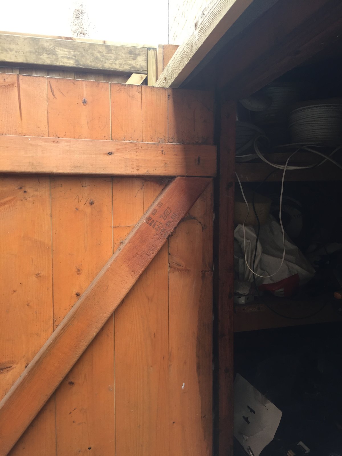

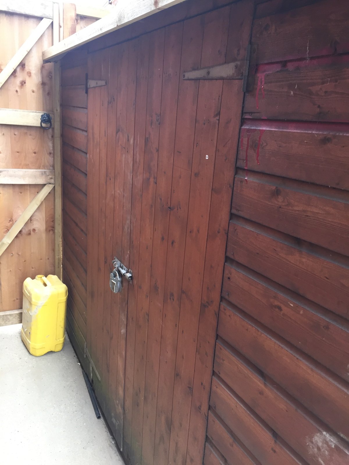

This is all depending on the door fitted to your tool shed ! A picture of the outside and inside of the door would give a yes or no
here you go:

There will be loads of movement in that type of door , standard contacts no chance , heavy duty With large operating gap MAY work if back of door has packer/ support fitted to top of door and door tested to see how far it can be pulled open when locked !
look at what you are buying, each contact has its own gap tolerance, but be aware taking a shed roof off wont activate the door contact.

hinge side no good to be honest
why?
I suggested this as I am certain that there will be minimal movement here and talking to the manufacturer of the heavy duty door contact, they reckon it can cope with up to 30mm. I am not adverse to the DT but Texecom have told me categorically that a spider will trigger the DT PIR.

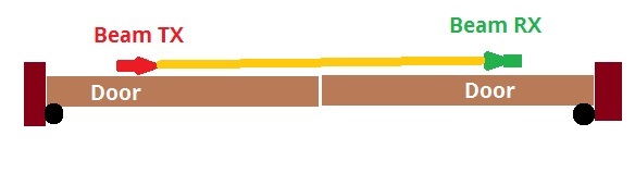

Double doors can be protected by a break beam sensor ( narrow beam ) with the TX on one door and RX on the other door.
Moving the door with the TX will mean the beam is no longer pointing at the receiver..
Moving the door with the RX will mean the receiver is no longer looking at the transmitter

The answer to why, its not the best practice to put them there, if the operational gap of reed is 30 mm, then the door when locked needs to move less than 30mm, when the door is opened for use properly the gap needs to be greater than 30mm for it to activate.
don't forget they don't need to open the door all the way to get in so the balance looking for optimals, which in this case:-
must activate when door is open the bare minimum to get in and out but wont activate when the wind is pulling door backwards and forwards.

Ok, you fit the contact to the hinge side, give me your address then I'll visit and tell you who is correct.
Bet I could get in with it fitted there. (y)
With these doors you either have to fit one contact to each door OR contact to one and magnet to the other.
An alarm company would fit one to each.
