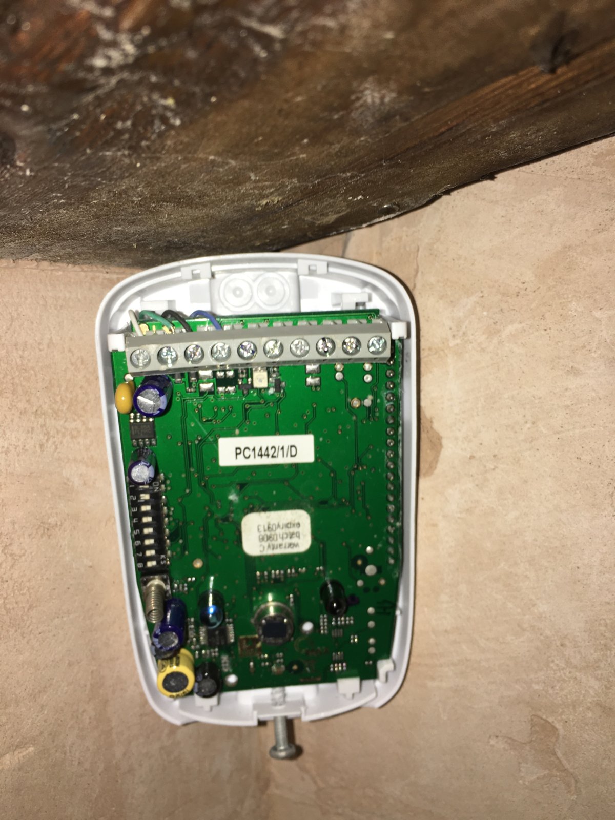

You have it connected to the tamper in the pir instead of alarm ?
Post picture of pir wiring inside pir
51AEE763-E9C3-4CD9-BA3E-615F7A21B52C.jpeg EE689B9D-9AF0-4C01-9CF5-6351E29CFFF5.jpeg

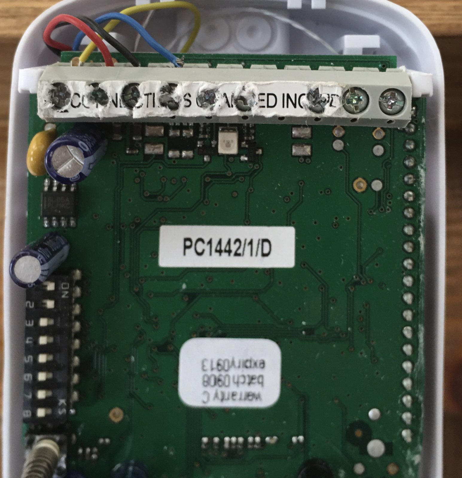

Does this help?
Looks wired wrongly to me. Shouldn’t it be red, black then yellow and blue (or blue and yellow) ?
Colours used isn’t important, what they are wired up to both ends is.
usually power pair alarm pair tamper pair

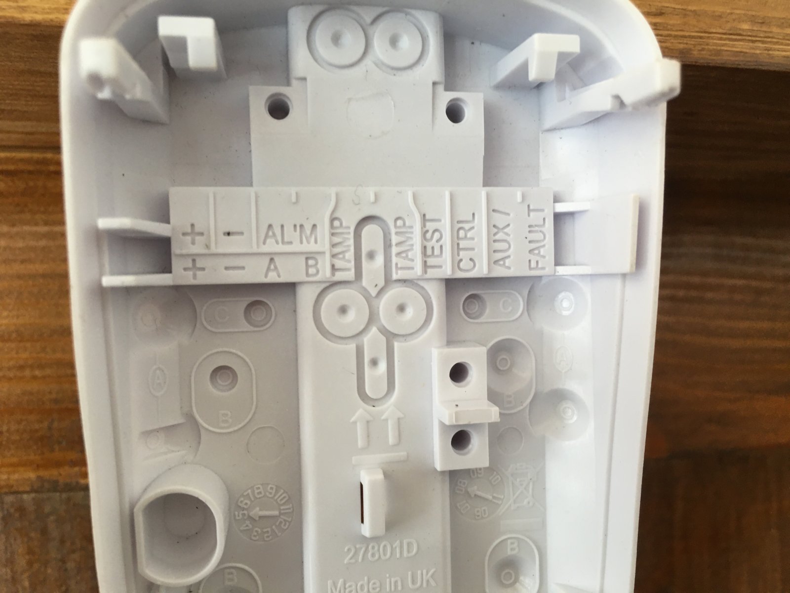

why is the terminal labels over the terminal screws.

That what my pirs are: power pair alarm pair tamper pair although I have no tamper wired.
All tamps looped out.

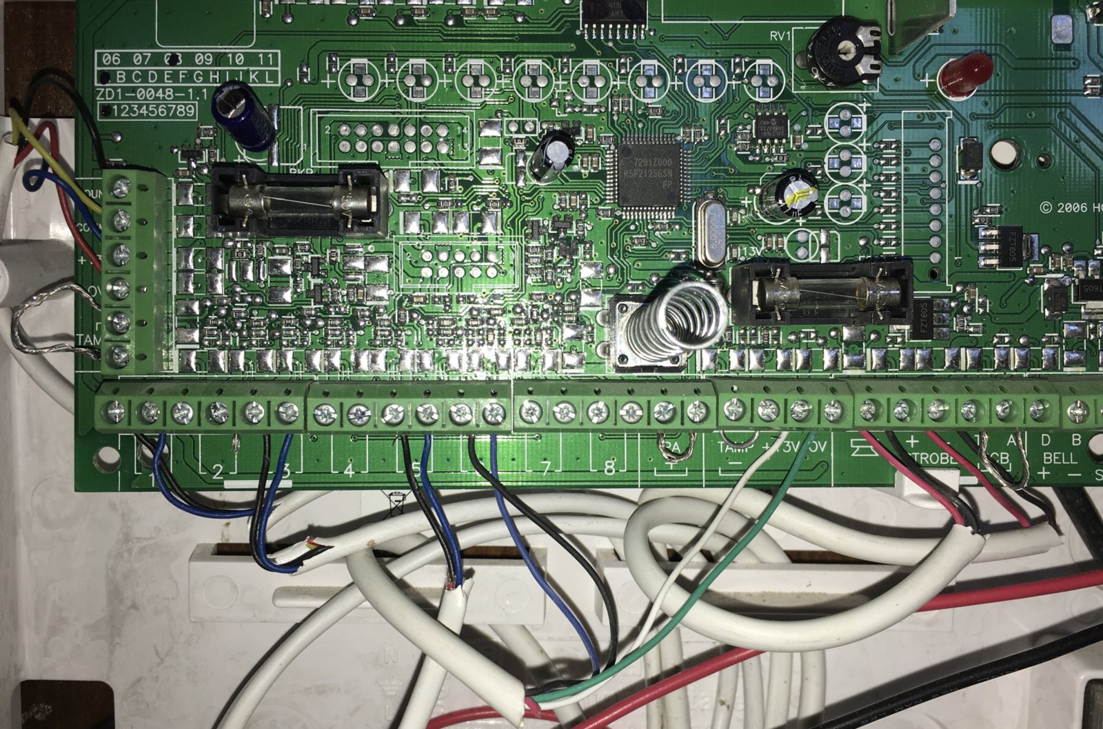

The terminal labels were like that when I opened the box, I’ve also got an Accenta G4 with these pirs in the main house, have checked and although the wires are indeed different colours they go to the same terminal in the second Accenta G4.

pir is using zone 6.
It’s not a faulty pir as I swapped a known working one in.
It’s wired the same as the main house Accenta that works!!
The plot thickens.
blue and black are in the zones
I see you have white and green in power and not sure what your doing the bellbox end.
so where is the power for the detectors actually coming from?
do you have joins somewhere else ?
Not using a bell box, have a sound bomb on the speaker.
White & green go to 13v & 0v in panel.
No joins
Sound bomb will not work in speaker output.
Labelling the cables might help
Why are you not using the zones consecutively ? Link out spare zones not used this will help in fault finding if control panel not programmed correctly.
