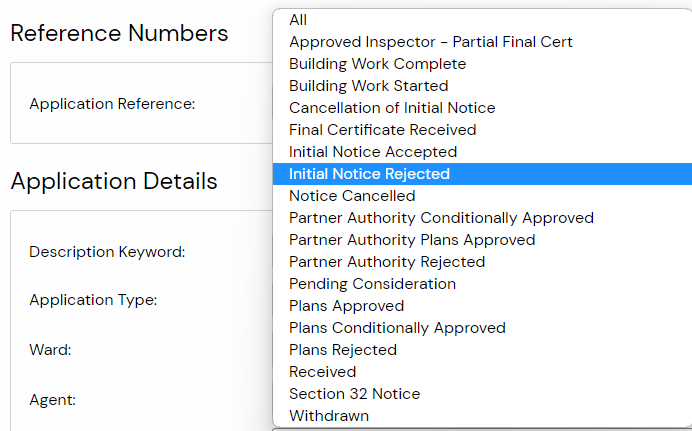

Does this mean 48 hours after notice is received by the council, my roofing works has been given 'consent' and I have that long period of time to do whatever necessary (insulation etc) to pass the inspection?
What happens if I fail the inspection e.g. insulation not thick enough, or inspector is not satisfied with some timber in the loft - will I be given the chance to remediate the situation, or is there some kind of permanent record of rejection?
From a quick look at council website, the following statuses are there on the Building Application:
Apologies all for the amount of questions, I want to do things right! :)
If things aren't quite right, discuss what the inspector wants and (presuming what they want is reasonable - it isn't always!) get that done and arrange another inspection.
Thanks a lot! I have filed the notice and will get the interim inspection arranged
