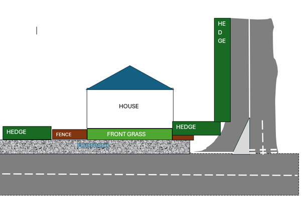

Am having first looks at a Plan B property (see my other post about access rights for another property). It's a rural refurb, cosmetic condition looks ok (roof, walls, floors ok, no obvious damp) has two obvious issues: it only has pedestrian access from the road, and it's listed (grade 2) but not very "special".
On a decent sized plot, and has a large frontage on the boundary with the highway on two sides and there looks to be a small grassy space for a possible unofficial pull-in right along the front of the house, but that space is shallow (only looks like about 3m deep), the curb must be 6 or 7 inches and there's a public footpath running in front of that along the road.
Apart from right in front of the house, the front boundary is marked mostly by a hedge, with a small bit of fence either side of the house, something like this (pardon my cr*p drawing):
Questions:
- the house is just at the turn at a junction of two rural 40mph A roads. Is creating car access at a junction very likely to be blocked by highways?
- is listed status likely to affect opening up car access?

So, you are considering a property with right of way access rights problems, is listed, and has no vehicle access (and is very unlikely to get drop-curb permission so close to a junction).

You will probably be unable to get access directly off the main road. It may be possible to do it from the lesser road.

Thanks all, this thread was just looking at a listed property with no vehicle access, and very cheap, basically a sanity check to see if there was some possible way for access from the road to be granted. My guess was there wasn't likely to be, and your replies and further googling around confirms that it would be very unlikely. A bit of asking around locally showed that the guy who lived had been there many years had a car spot a few minutes walk away that's not part of the sale. I don't think he wouldn't have had a serious go at getting access all the time he lived there if it were possible.
No car access and no nearby parking (or even just pausing) probably accounts for most of the cheapness.
