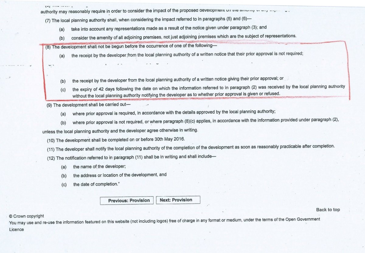

The only course for the neighbour would be to make a complaint to the council for maladministration.View attachment 112553
As before, the architect is an idiot, and should have told the council "sorry guys - your mistake - no time extension".

The law is crystal clear that, in the absence of any refusal by the LPA after the 42-day period - whatever the reason - then the work can proceed by default.
As previously, OP's architect should have taken a tougher line with the LPA.
