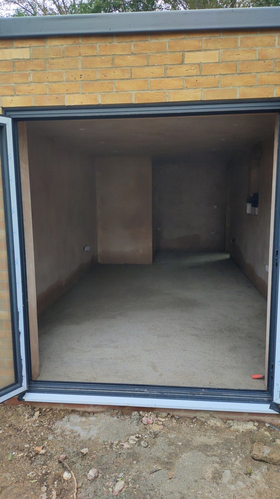

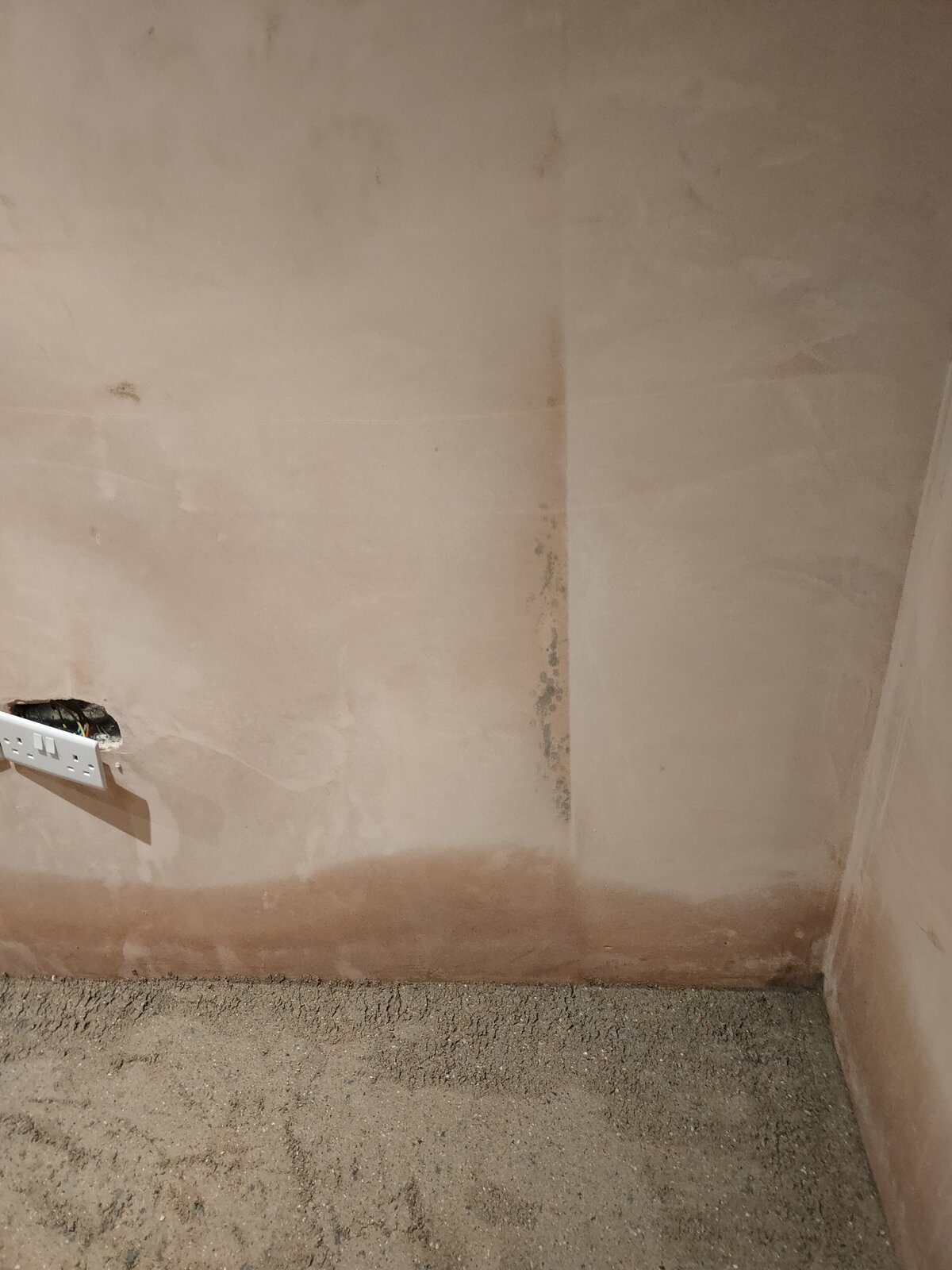

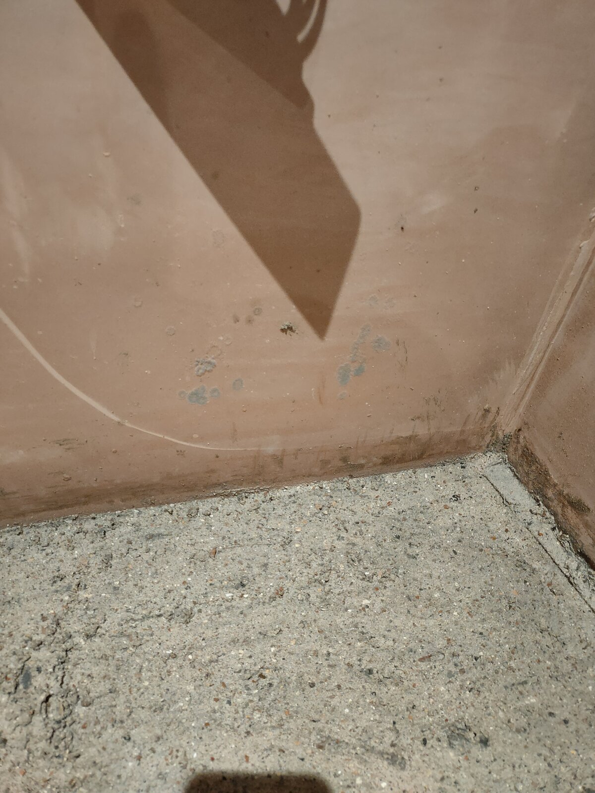

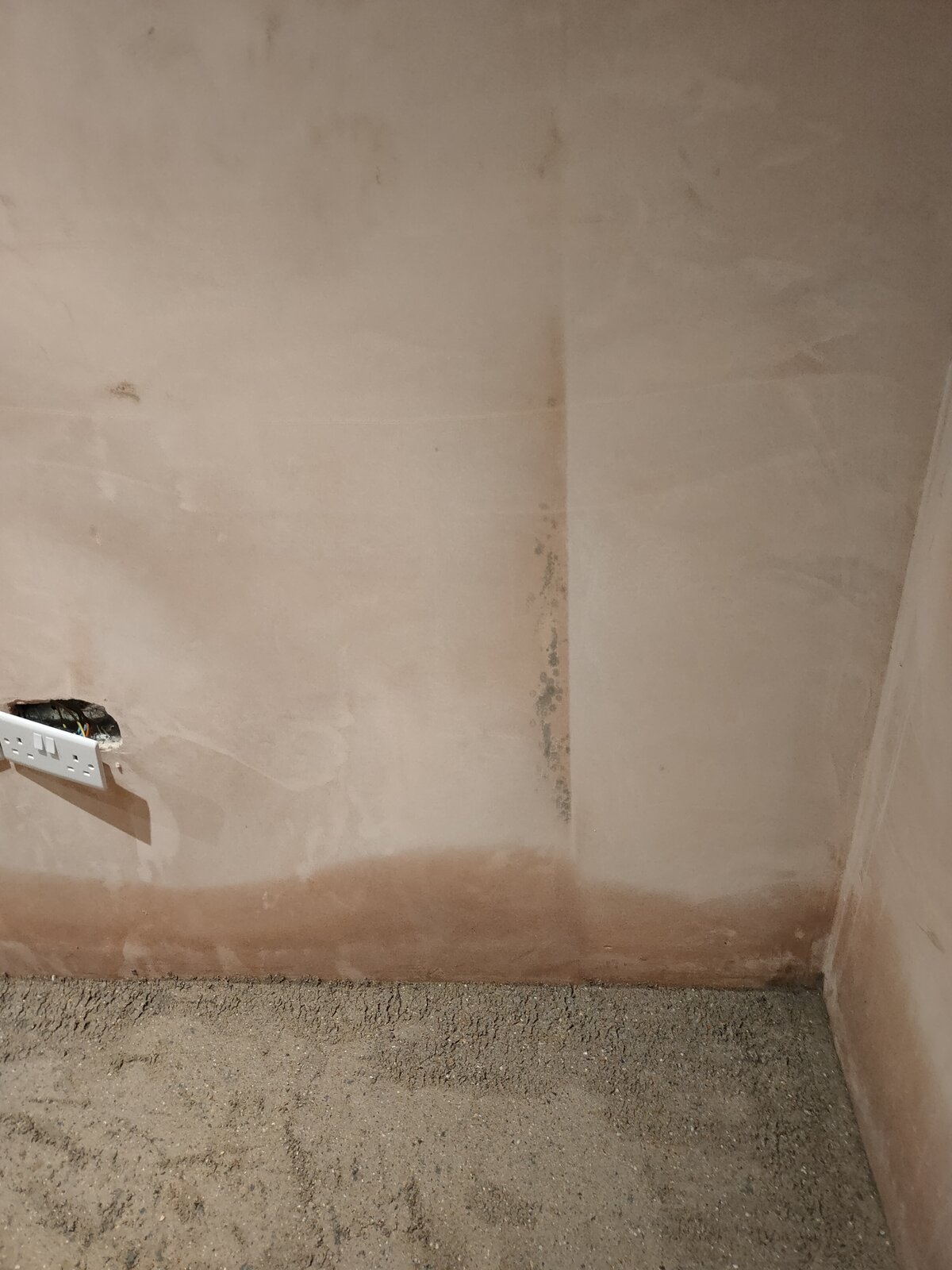

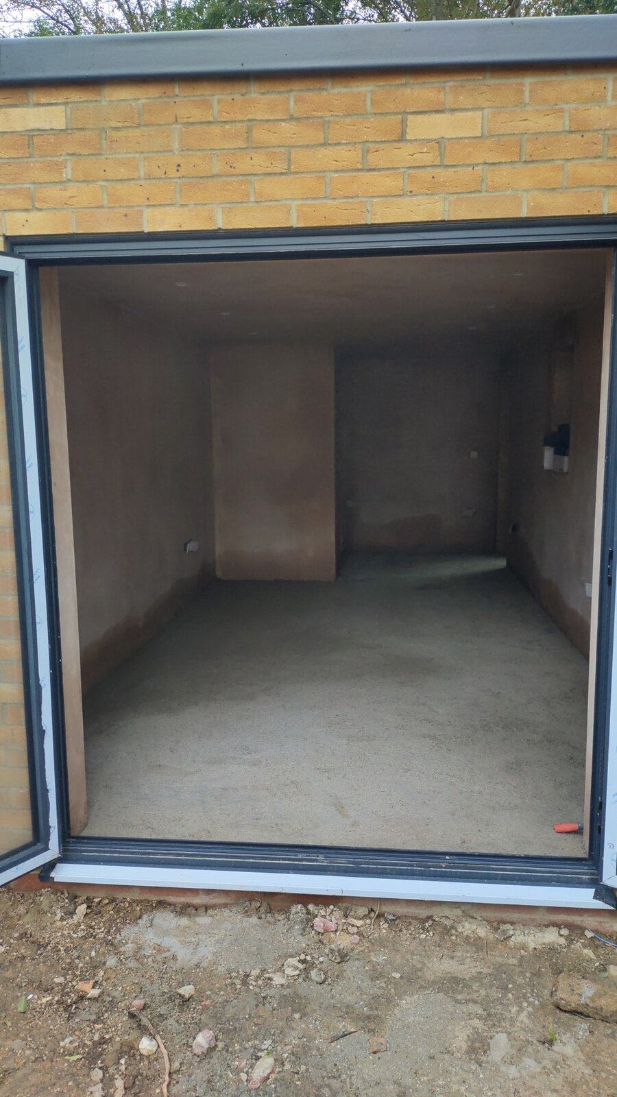

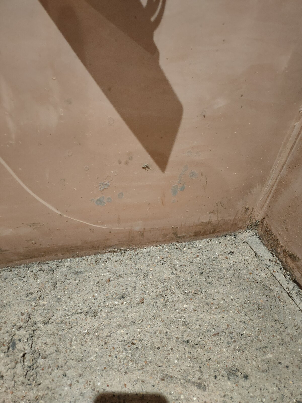

It will all dry out in the next few weeks and as long as the screed hasn't a dpm problem what is the actual issue?
There was no need to have plaster behind skirtings 150 years ago when ventilation was essential and rising and penetrating damp was the main consideration. fillers and modern techniques were unthought of.
removing say 150mm from the bottom of a perfectly good new plastered wall to say replace it with battens and say a 150mm skirting sounds nonsensical to me and flies in the face of modern best practise .
take an inch off the bottom to prevent the chance of any damp or moisture rising from the floor and bond or pin your nice fresh new modern skirting to your nice new flat plastered walls.
i have seen similar happen when their was a leaking pipe in the floor.
are the walls lightweight foamed blocks? And in contact with the floor slab?
