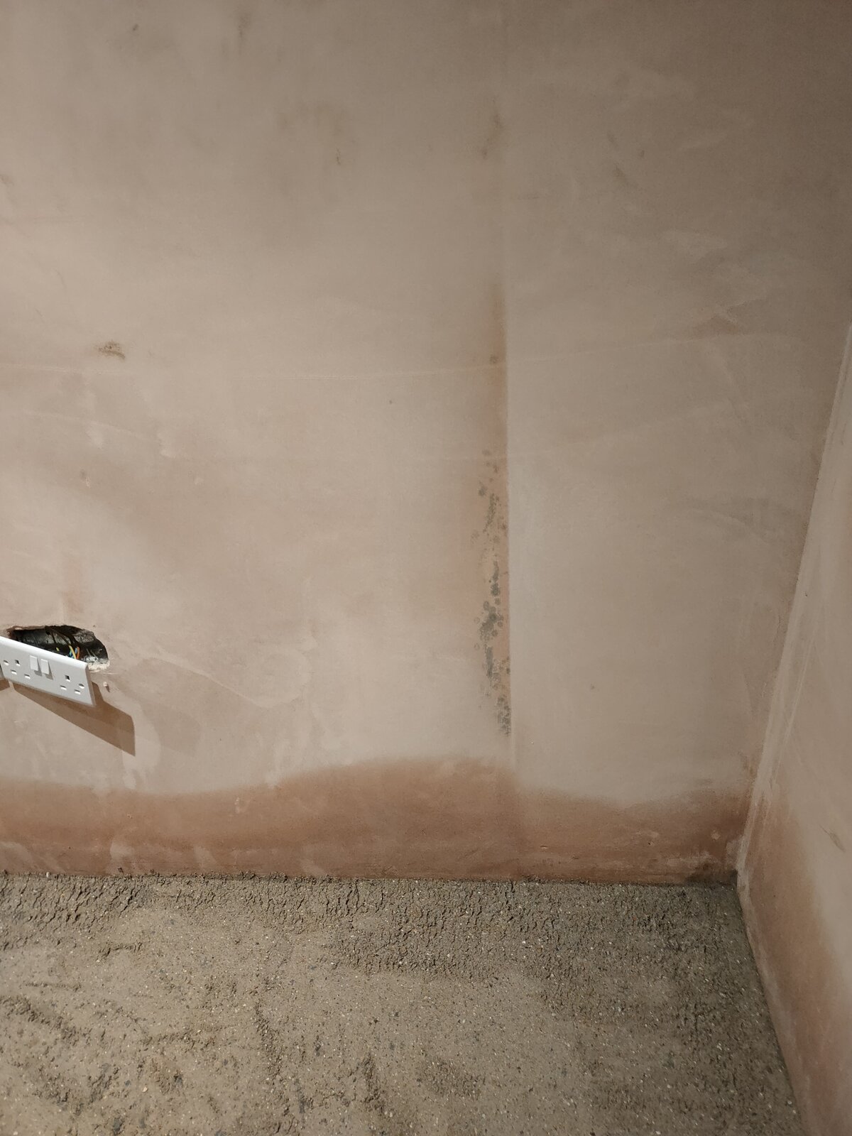

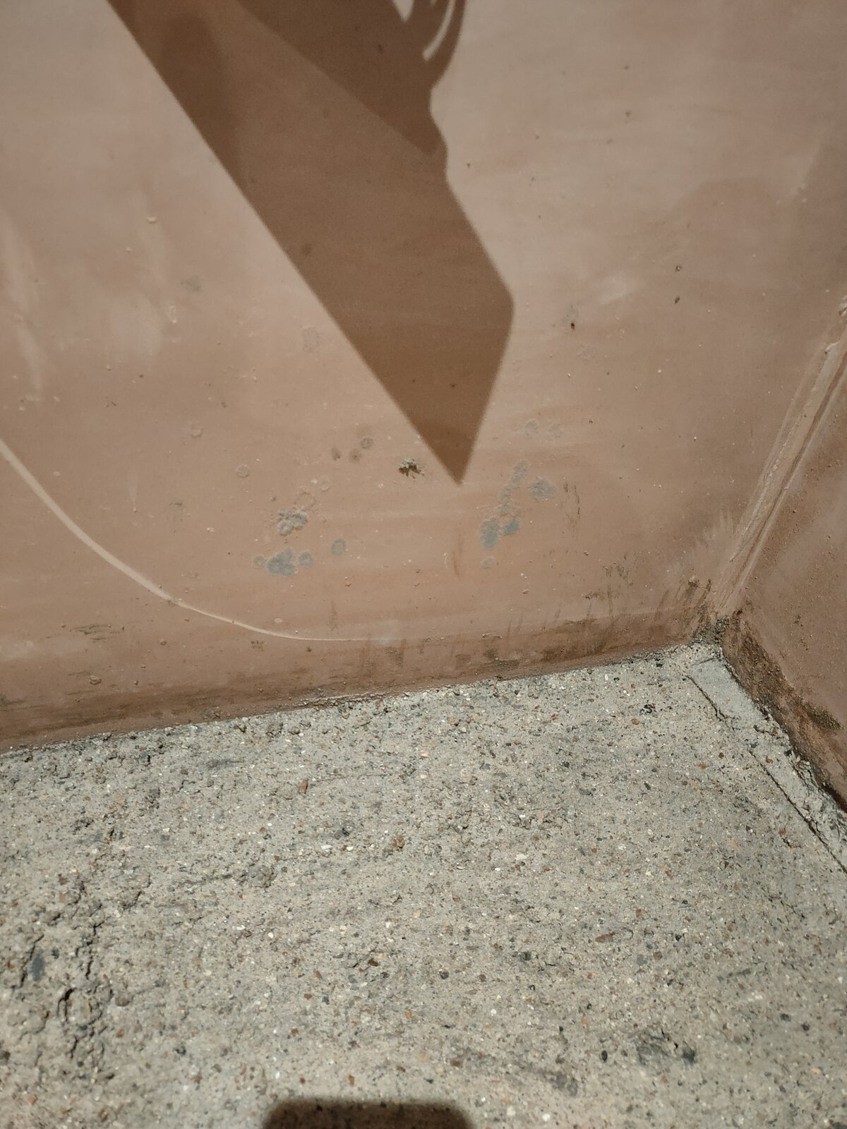

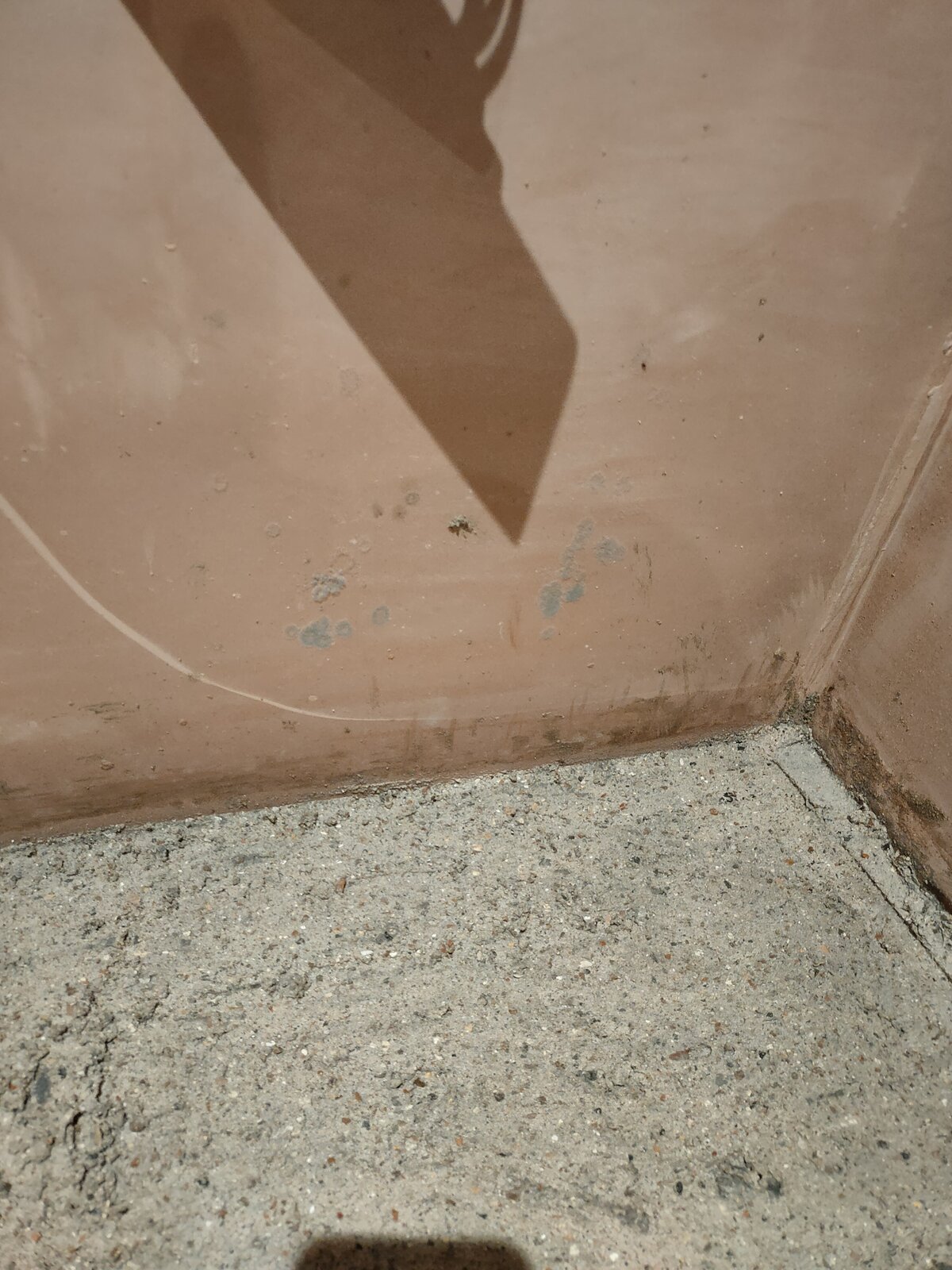

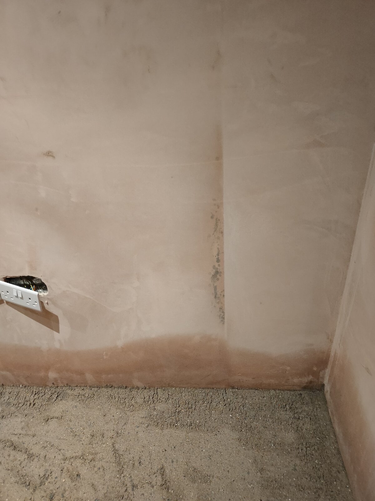

Plaster absorbing Screed moisture
there is still no "need."
What benefit does it bring?
what ‘benefit’ could a builder or plasterer get from dry lining a room and trying to suspend the plasterboards say 150mm from the floor for the sake of later installing batten to fix a say 150 mm skirting to.
the benefit of boarding down to within an inch or so of the floor is clear. a uniform flat plumb surface to bond or screw / pin a skirting to, as stated previously, and as per modern recognised best practice.
I shouldn't be getting damp patches though should I? Or is that due to the moisture being released?
I'm getting rather worried!
View attachment 248401 View attachment 248402
why worry , it’s a poor job. clearly carried out by inexperienced ‘trades’.
run a multi tool around the bottom at floor level and again 1” up . job done. be careful not to damage any dpc dpm or cables.
lay a wood board or tile lath aginst the walls and use it to mark a pencil line around the room. Useing a knife, like the one used to cut the boards, cut the board at the line and then break it out.
Then again you could leave it like it is and if it dries out everything is ok, if it doesn't then you have a rising damp problem, cut off the bottom inch and least ways you will be unaware of it for a few more years
and the benefit of making the walls wet?
can’t think of any . similarly I can’t think of any benefit in needlessly incorporating 150 year old techniques into what is clearly a modern project.
