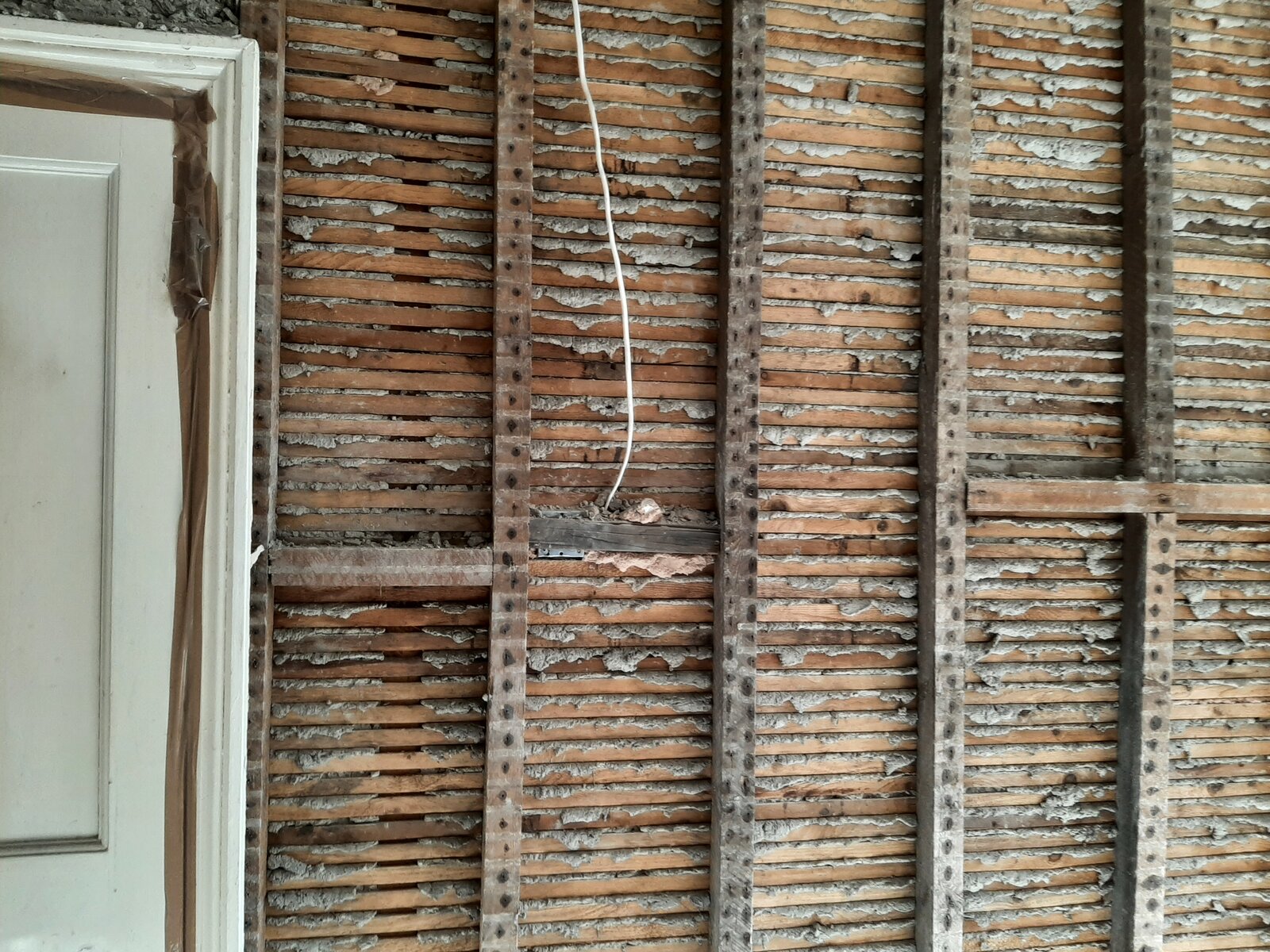

Hello guys,
My walls have Wattle/Laths.
I am considering just to remove the plaster only and nail/screw plasterboard over the Wattle/Laths.
Thin skim plaster on.
I am of the opinion that, leaving the Wattle/Laths will give a more solid backing.
Thanks for any advice.
You can if you want or remove.
Fit cross timbers will make it more solid. I don't think laths add much strength.
You can also board wall with wood ply sheets then plasterboard over as this makes fitting stuff to walls easy and adds strength.
Thank you for advice. I have removed the laths.

I have ordered 5.5 plywood as backing for the plasterboard. These will go horizontal. Plasterboard vertical.
I plan to use only a few screws to hold the plywood, initially, since longer screws will go through the plasterboard, plywood, and then the studs.
Any recommendations, please?.
Thank you.

From the info in your opening post there was no need to remove anything - plaster laths provide excellent strength to a partition.
Perhaps all you needed to do was skim over the existing surface.
In your last post:
You dont need to use a plywood backing for plasterboard. Standard plasterboard is 12.5mm.
Plasterboard over studding is fixed horizontally to the studs.
Ok.
I already paid for the plywood and planned to lay them horizontal, plasterboard vertical.
However, you suggest lay plasterboard horizontal.
Since they are all 8 x 4s, they cannot take the same run.
So, plywood will need to be vertical ?.
Ply can be useful if you intend to hang heavy objects on the wall, for example a kitchen or workshop, but it would need to be thicker.
In most rooms it is not necessary.
Thank you.
Save the ply for something else like a decoupling layer for tiling. Or get a refund. 5.5mm ply is far more flexible than 12.5mm plasterboard. It would only offer any meaningful support to the PB if it were bonded to it
Think I might have just boarded over the L&P, take the sound blocking win :)
