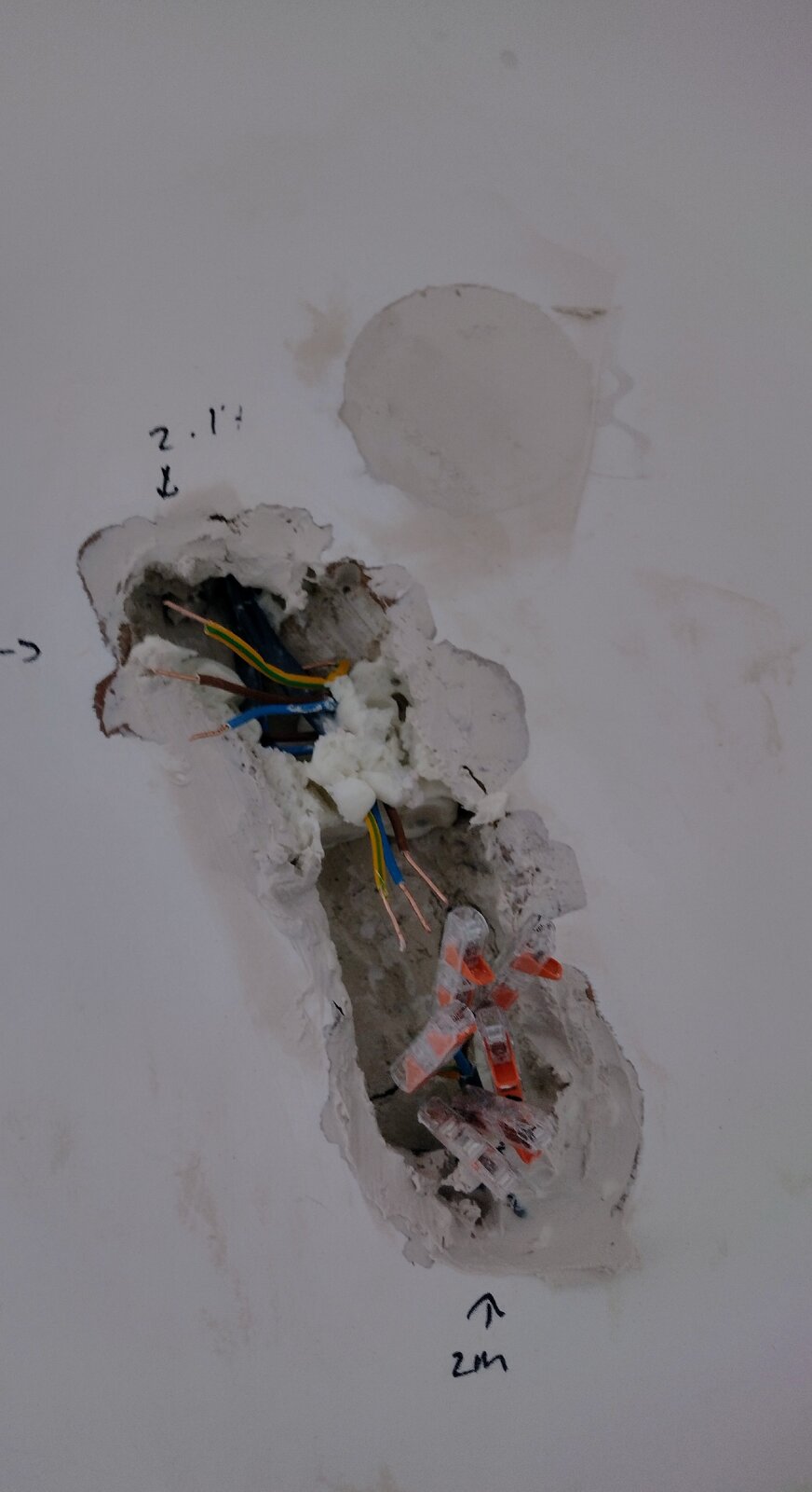

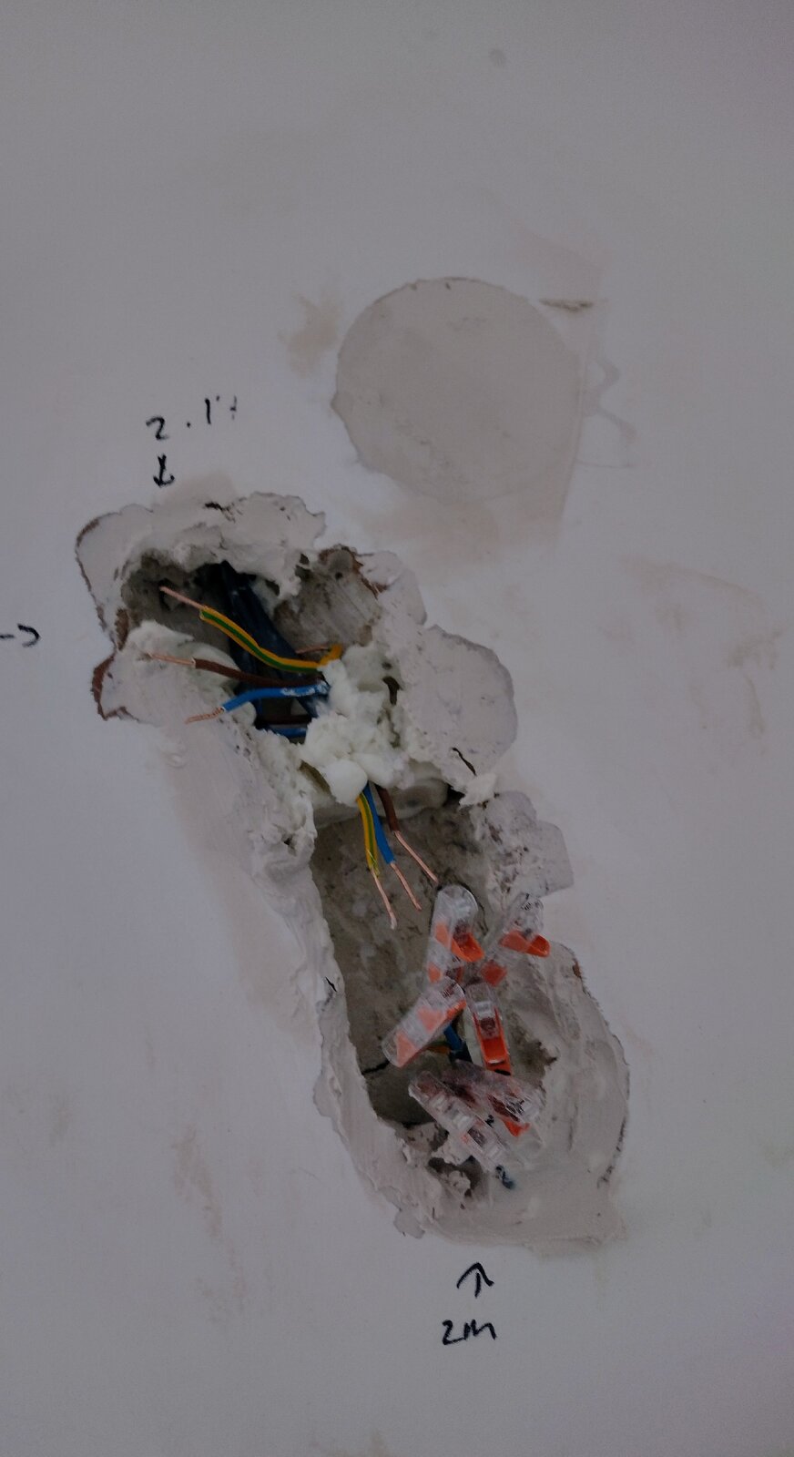

Plasterer went through a cable which runs straight down to a light switch.
The wall is dot and dab.
Is it okay to simply join the wires with a maintenance free junction box, then plaster over it? Do I need to take any extra precautions?

Better to replace the cable/s
Can I ask why?
Hopefully I can avoid this as it will be too much palava. The wire travels through a boxed in metal beam, then insulated ceiling with Pir.
Can I ask why?
Yes you can,
My answer is that a concealed junction box is never a good idea.
As the plasterer did the damage then he should agree to re-plaster the area after a new cable has been installed.
I recall an area of plaster in a house that gave a "tingle" when touched. There was a cable repair joint buried in the wall. Plaster that was damp from condensation was in contact with a Live terminal.
How on earth did he "go through" the cable? What exactly was he doing, was it the edge of he trowel?

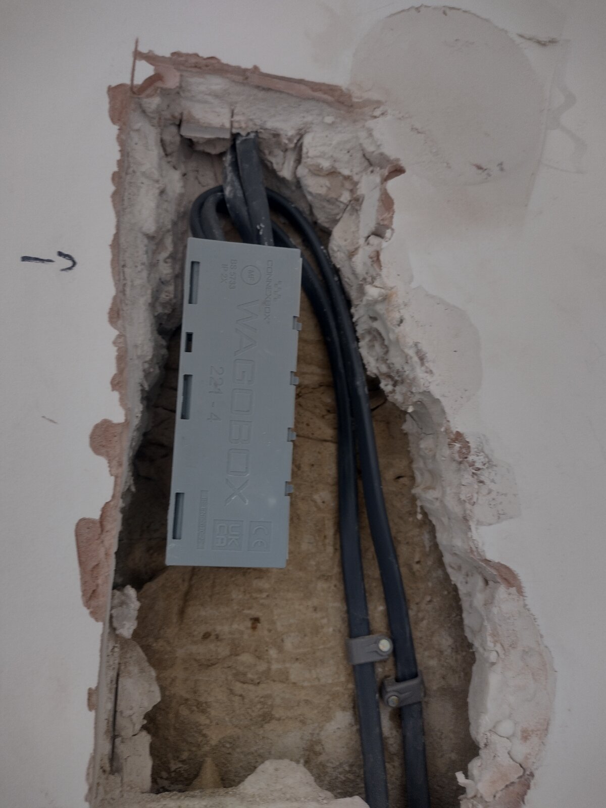

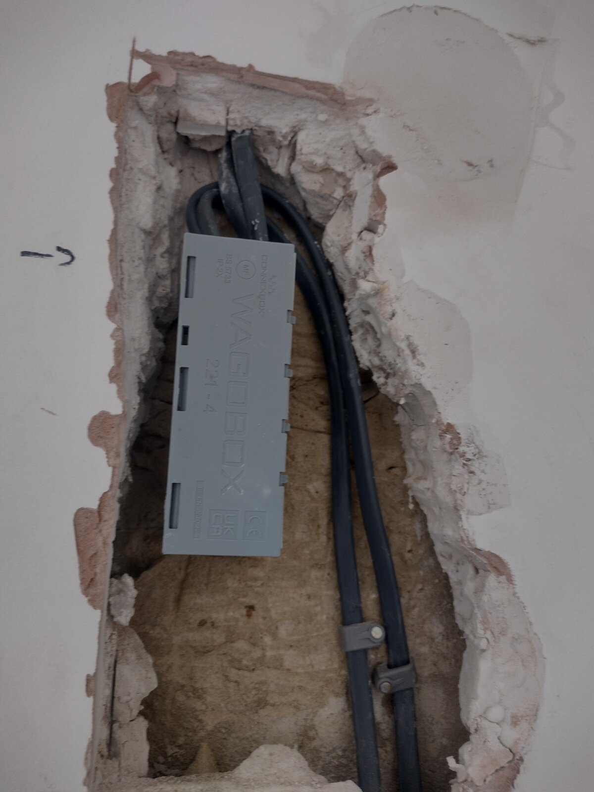

Maintenance free junction box. All wire were neatly tucked into the 221 slots and all earth were sleeved.
Can we plaster over now?

Maintenance free junction box. All wire were neatly tucked into the 221 slots and all earth were sleeved. Can we plaster over now?
Strictly speaking, I suppose the answer is yes. However, I'm sure that many of us would feel that 'plastering in' any junction box (even if 'maintenance-free') is far from a good (or 'nice') idea.

But why?
Is it because, potentially the wire may come lose in the connection. Thus breaking the electrical connections and your light fitting/switch no longer works?
But why? Is it because, potentially the wire may come lose in the connection. Thus breaking the electrical connections and your light fitting/switch no longer works?
Yes.
As you imply, there is not really any significant 'safety' issue (although some might say that if a connection became 'loose', it could overheat and cause a fire!), but it just doesn't feel 'nice' - a bit like 'papering over cracks', I suppose :)
Kind Regards John
Because it's a bodge. How much this offends one's desire to do a good job is highly variable to the person
I wouldn't do it; plasterer on hand means you can rip that wire out in both directions as far as needed to renew the length, put the junction somewhere accessible and only take a few minutes more to plaster over..
(which, incidentally, isn't supposed to happen in an MF joint)
Indeed. As I said, it's just 'not nice' - even though I could not really justify my concerns particularly logically (in terms of 'safety' etc.).

How on earth is someone supposed to know that that lot is in the wall when they come to put up a picture etc. ???
