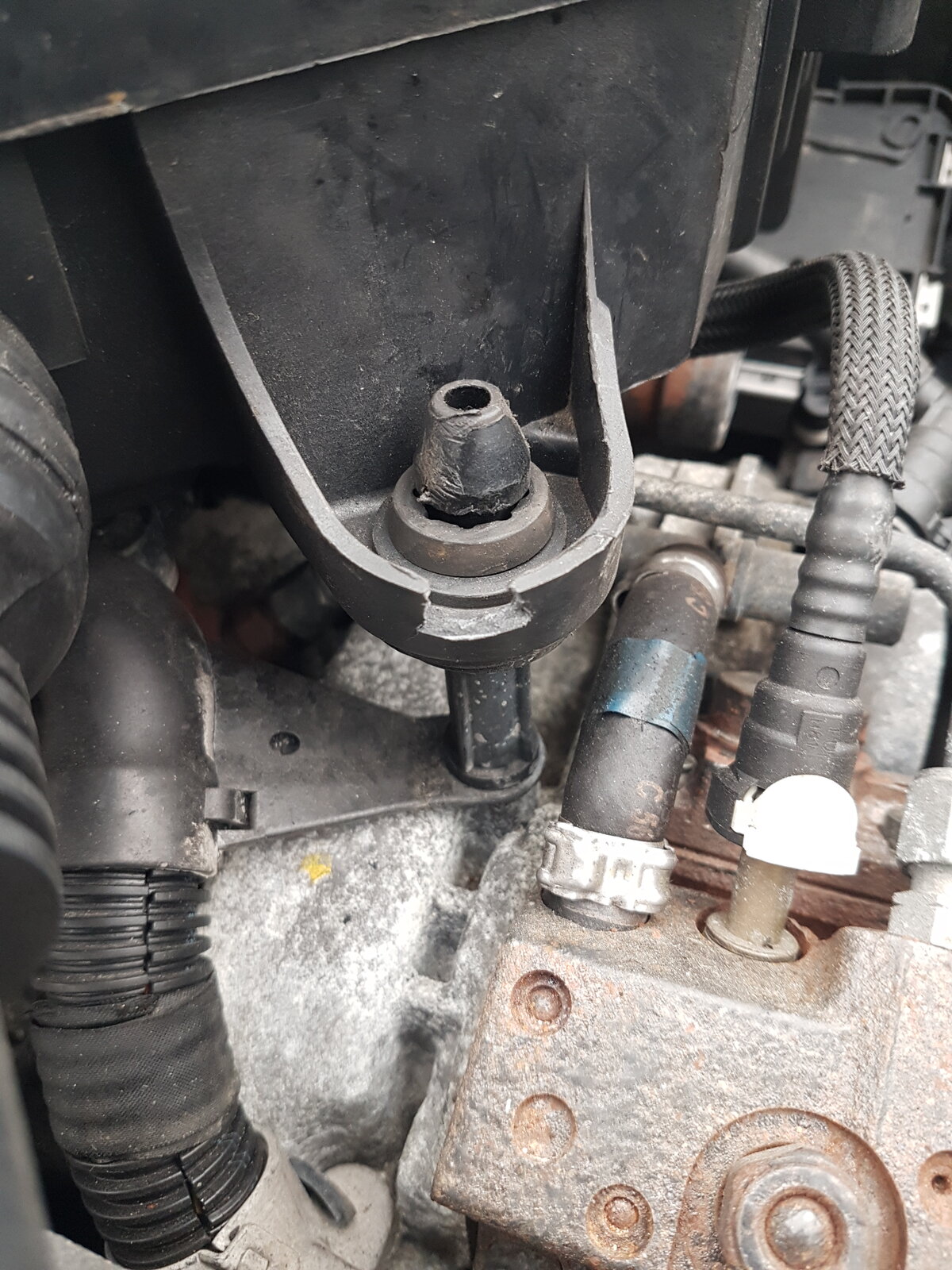

plastic cone fasteners on my airbox
1 Feb 2023
6
no clue how to get these off, please help
no clue how to get these off, please helpView attachment 377208
I'm assuming it's the airbox you want to take off? If so, I think the rubber bushes just pus over the barbs, so you have to carefully prise it off, as Burnerman suggests. Just be careful, as the rubber bushes have got harder with age, and the plastic spike they push over, might have become more brittle.
thanks I pulled from the airbox and it came off, leaving the cone etc in place on the engine. Cheers!
