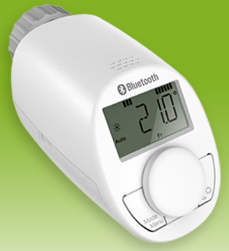

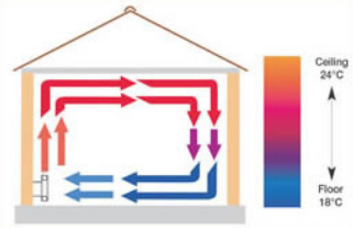

However there is a problem fitting the TRV on the return, we want the air to circulate circulation.jpg so the TRV is sensing the cool air returning, but it also senses so heat direct from the radiator, better versions have two sensors one for air and one for water and the latter compensates for heat from the radiator, so on the feed side it senses the temperature faster than on the return side, so on the return we want the flow to be slower than on feed side to give the TRV chance to adjust.

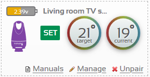

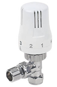

I fitted electronic heads in mothers house, and slowly bit by bit adjusted the lock shield valve on the supply side so the TRV recorded temperature did not over shoot, Flat Battery TRV.jpg since the TRV showed both target and current it was easy enough to adjust, but when we came to sell the house, and fitted the non electronic heads back on, we found now lock shield set, the standard TRV head worked very well. However when setting we found those on the supply side were far easier to set to those on the return side, with this house many of the TRV heads only show target, this head 61dmtMm13BL.jpg works well, but since it only shows target you also need a thermometer to set the lock shield valve, these TRV.jpg as said do work, but the *12345 does not really help when trying to set up, as your not sure if the TRV or lock shield needs tweaking a little.
