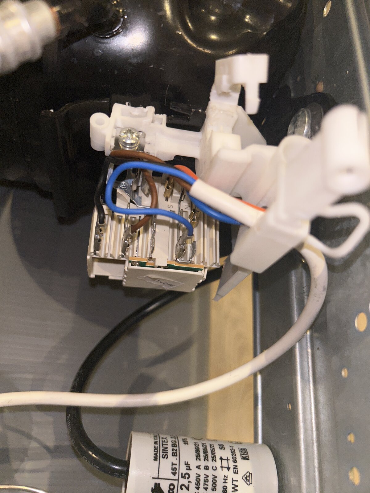

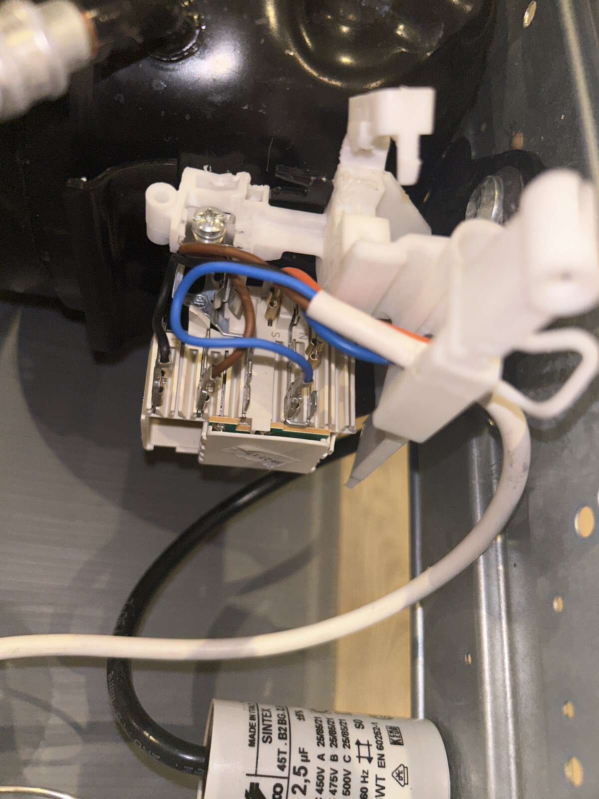

Hi, after having to investigate a really bad smell which I’d presumed was the drip tray at back on integrated fridge….the wire pulled out of the fridge while I removed it and now I don’t know where to put the crimps on the plastic thing (is it a relay)
Thanks I’m advance for any help

The wire that comes from the mains socket has been pulled out.

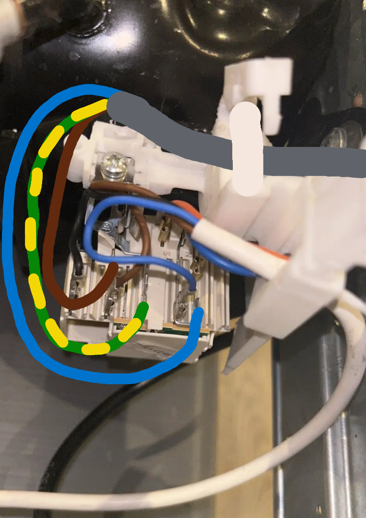

It looks similar to a TX1CB relay module.
The power cord simply attaches to the terminals.
Brown (L) sits on the same terminal bar as the existing brown wire.
Blue (N) sits on the terminal bar with the blue wires
Green/Yellow (Earth), sits on the terminal bar marked with the earth symbol.
I.e.
...and be sure to secure the cable back under the cable clamp.
