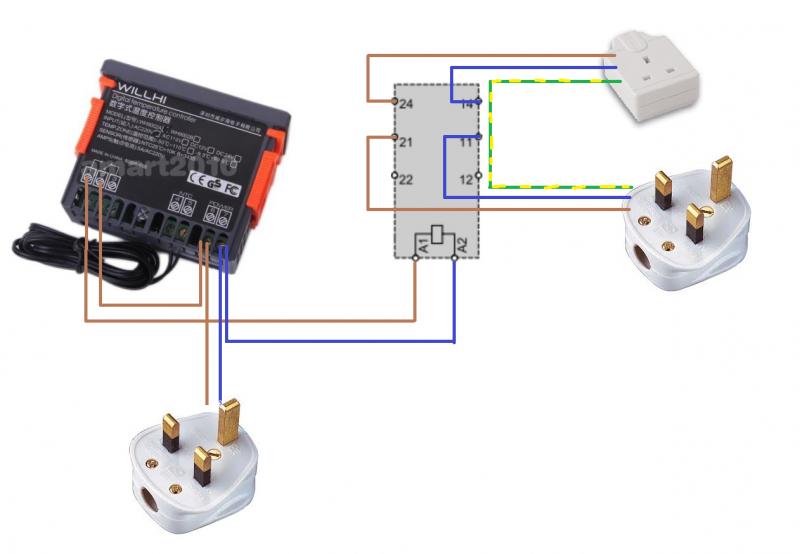

You could look at the wiring diagram you have:
And/or you could read the post where that question has already been answered:

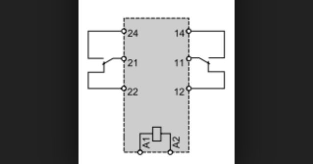

The pic of the relay however. A1 is switched live in from the controller. A2 is your neutral.
Then 11 and 21 are live and neutral in, and 14 and 24 live and neutral out to the load.
And/or you could look at the answer from Gareth:

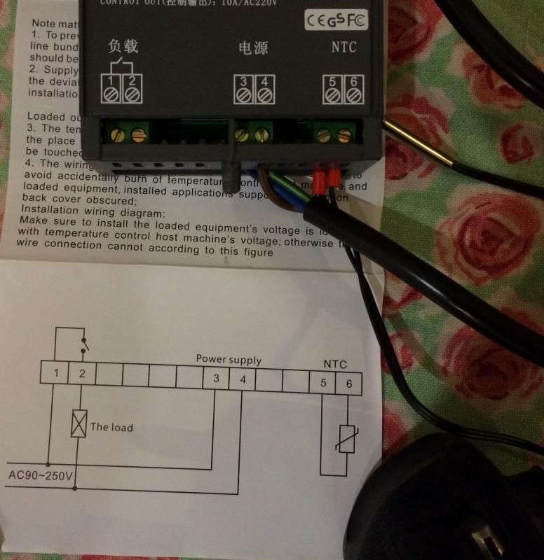

The relay from eBay: ... The description is "Pro 220V Coil Power Relay 10A DPDT " which means The coil needs 220volts to energise
That's certainly what one might think. However, as others have noted, the description says that it has a 12V DC coil !
As others have commented, at £2.49, including free shipping (not to mention the cost of shipping from China in the first place), this item is almost certainly a fake - and therefore quite probably will be unsatisfactory or unreliable, if not also dangerous.

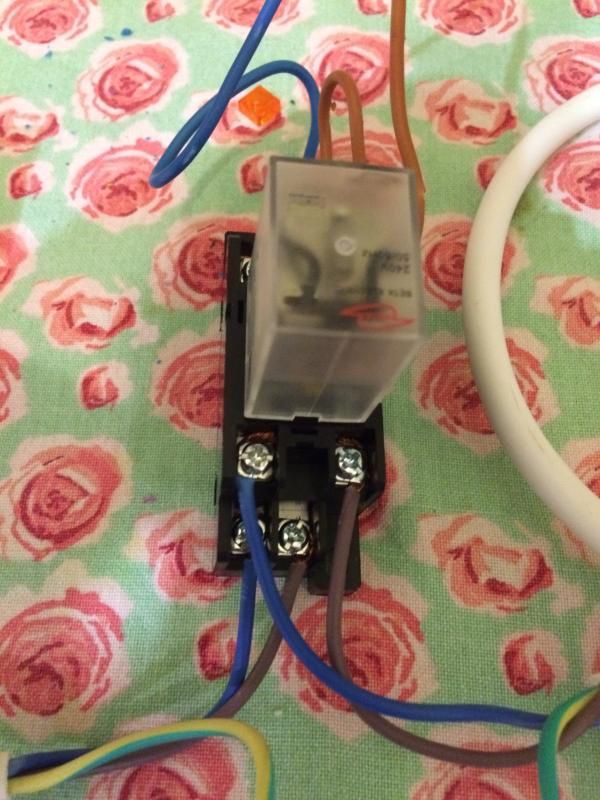

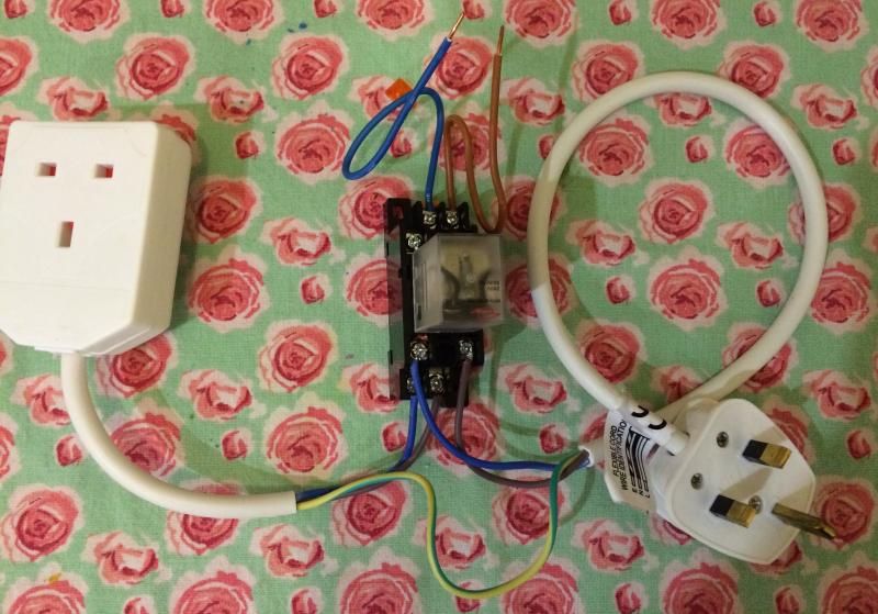

I need to pick this up again, could I ask those that WANT to help please assist, thank you to those who have advised I don't continue, duily noted although I still want to try and resolve this.
This is where I am so far:
Could someone please tell me what does where in very simple terms, (relay and relay holder have been replaced with maplin components).
Many thanks,
FHS - you have had Gareth's diagram for almost 4 weeks.
What is it that you still do not understand? Because understanding is essential.
You must, you absolutely MUST, understand what you are doing. You must not, under any circumstances, start following instructions to 'insert this wire in that hole' without a full and genuine understanding of why.
No lesser level of knowledge is remotely acceptable.
