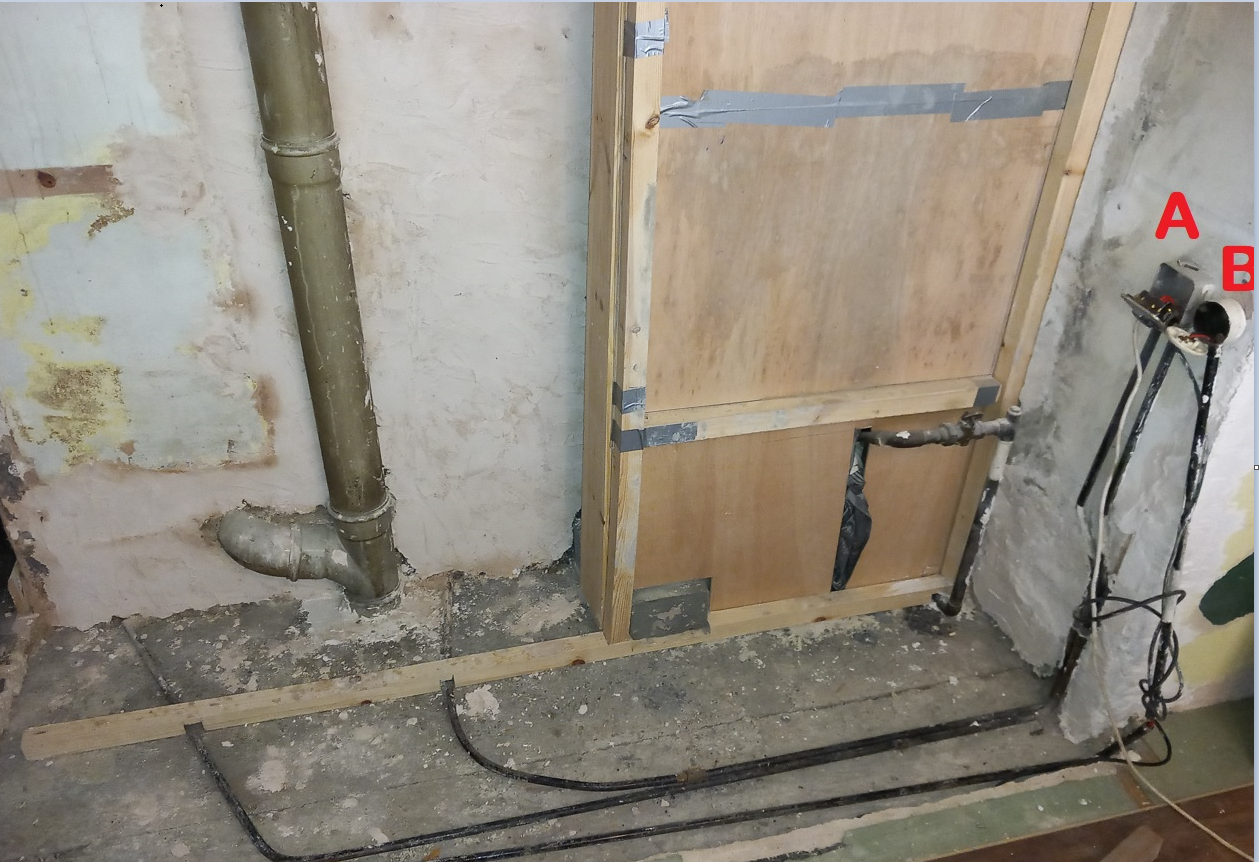

I'm hoping to convert this into either one or two plug sockets
these were previously connected to an old boiler, which was inside the now demolished cupboard
Ideally I would like to re-route the wires in terminal "B" to my bedroom to create a plug socket in there, and use the terminal "A" to create a plug socket in the position it is in picture
It would be great to know if any part of this plan is possible.

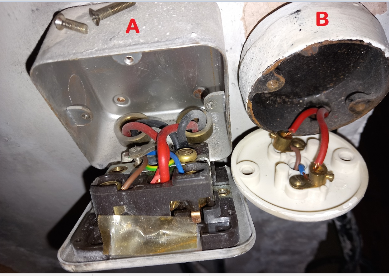

Please see below pic for close up of the wiring:

It may be possible, but not a DIY job, it seems to be using the conduit as the earth, and that earth could be easily lost, so it will need testing, and the test gear is too expensive to be worthwhile doing as a DIY job.
With Item A, the moment you have loosened off that faceplate, you have lost the earth connection. It is a far better job to run a short length of earth wire between the metal back box, and the faceplate.
Not sure what Item B actually does, or did.
Assuming you will be disconnecting the outgoing flex at Item A, you could 'probably' connect a relatively unlimited number of socket from the load side terminals, with a 13 amp fuse fitted.
Of course, it all needs testing and looking at properly before you do anything.
If your fuseboard is of a similar vintage to that installation there, then no sockets can be added until RCD protection is added.
And as others have said, if you want to alter that, you will need someone with the equipment to work with steel conduit
Agreed, there is no need to continue in steel conduit just because the existing is in steel conduit.
There *IS* however, a need to validate that there is a usable earth and fix the situation if not. That means not just making a solid connection at the current box, but inspecting the rest of the circuit.
There is also a need to validate the circuit more generally, is there enough spare capacity for the new loads you plan to add? (the fact there are two cables in the box suggests that the boiler is not the only thing on the circuit). Is the overcurrent protection suitable for the cable size? (I suspect the wire may be imperial sized, which may make working this out harder) Is there RCD protection? (probablly not if the supply has the same vintage as the
There *should* be a flylead from that box to the FCU and there isn't one. When you see one corner cut, IMO you need to assume that others may have been cut too.
