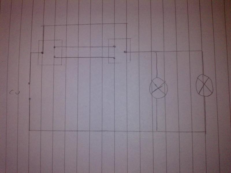

Heres two rough diagrams for the other 2 cicuits i mentioned above - any comments or help is appreciated

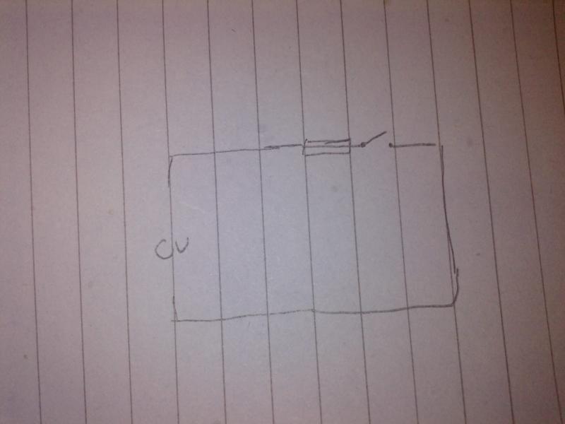

Unless I misinterpret your diagram, when you close the switch you have a dead short across the supply?

The second shows a dead short, as Owain has said.
You need to draw them showing live and neutral cores. If you dont draw the earths, you must state "earths omitted for clarity".

In a nutshell it is just the same as having a normal 2 way light arrangement with the lamps in parallel.
Why on earth you have drawn the correct diagram and then linked the commons together on the lights so they are on all the time is anyones guess, maybe you are getting confused with the alternative method where C, L1 and L2 are linked (aka strappers) between the switches and the permanent live connected to L1 and sw live to L2? You still need to be able to follow the wiring diagram through the switches to see how they work, do you see why the light will be on all the time in your drawing?
Both of these are drawn in the wiki here: //www.diynot.com/wiki/electrics:two-way-lighting

jamodo - it is not the college's shortcomings which have left amcevoy unable, after 2 years of studying, to work out how to connect 2 lights instead of 1, to know how 2-way switching works or to thinking that wiring an FCU to create a L-N fault is a good idea, and in the long run you do nobody any favours, least of all amcevoy, to go along with the idea that it is.

Were all of those 12 teachers so incompetent themselves that they taught you that this:
is the way to connect an FCU?
