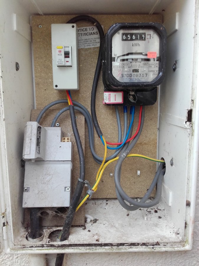

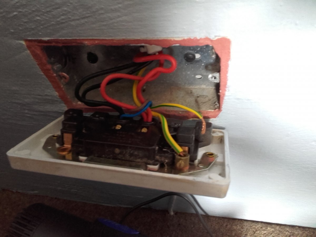

Oh well, at least he didn't connect the little flex into the back of a socket like I found during a T+I last week, or connect it directly to the meter without over current protection. This work was carried out by a previous owner who was a BT engineer. :LOL: The wiring in the outbuildings ranged from awful to bloody dangerous, and it was obvious the switches and lights had all come from 'phone boxes (or the BT stores!)
Wow. Just wow. You must have more pics.

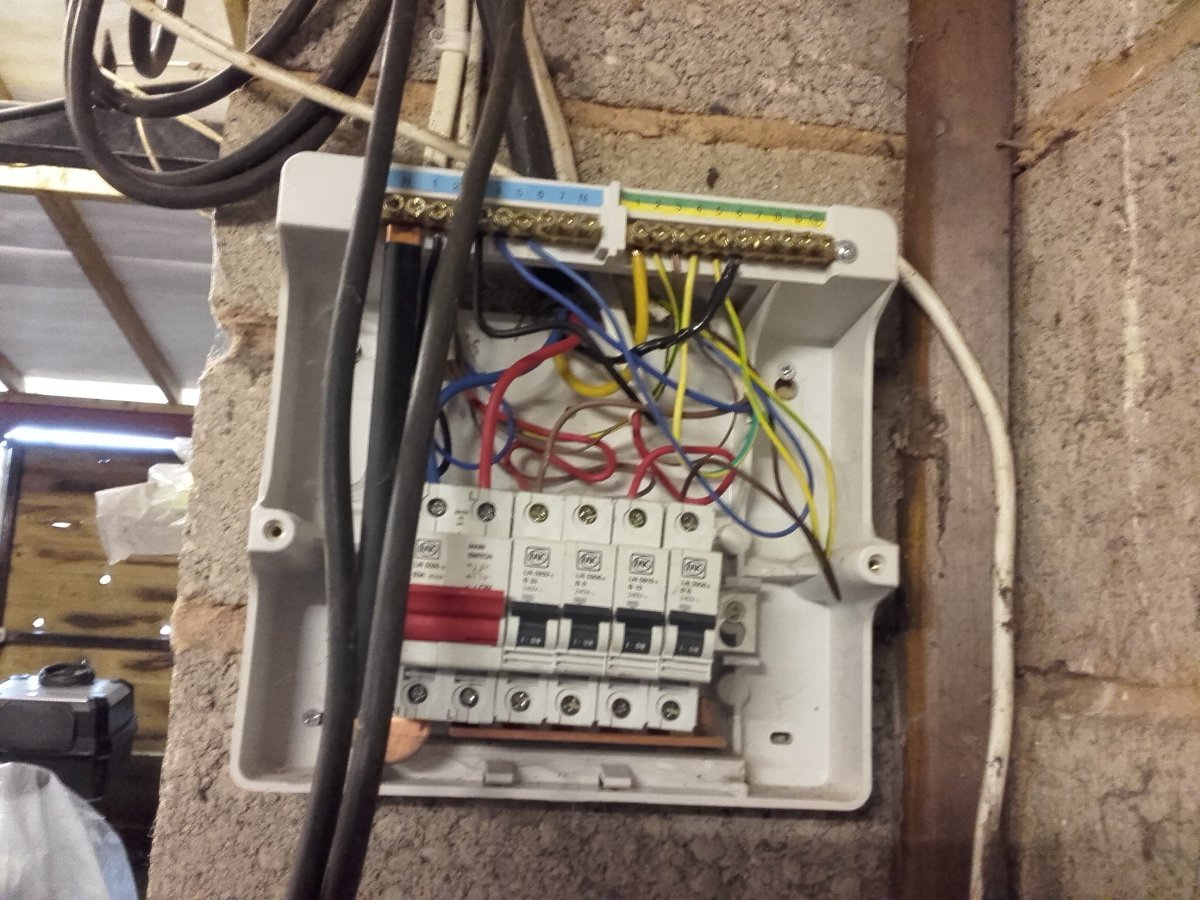

Yes TT, the earth connections to that armoured cable were made by twisting the conductor and a few armour strands around the cable to the earth electrode. 5M later the cable is jointed in a plastic box, the armour is not connected to earth after that point. The supply was originally correctly terminated at the house DB via a 32A MCB, and 100mA RCD and must have been re-routed at some point.
It's not a clear photo, but there are flexes everywhere in the DB, the 32A mcb has a 4 gang extension lead wired directly to it.

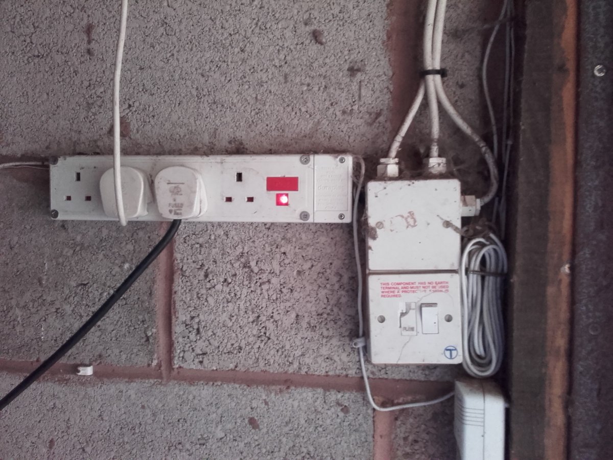

Most of the wiring is just wrong, the socket pictured has no earth connection, there are open holes on enclosures and unsupported cables.

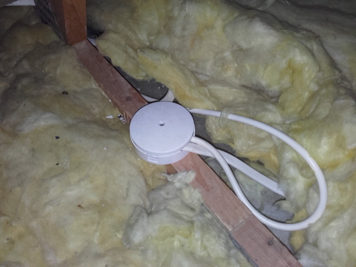

Here a bathroom fan heater is connected directly to the electric shower cable via a 30a JB, I take it the shower cable was not cut to get it in the JB, I didn't open it to find out in case it all went everywhere.
