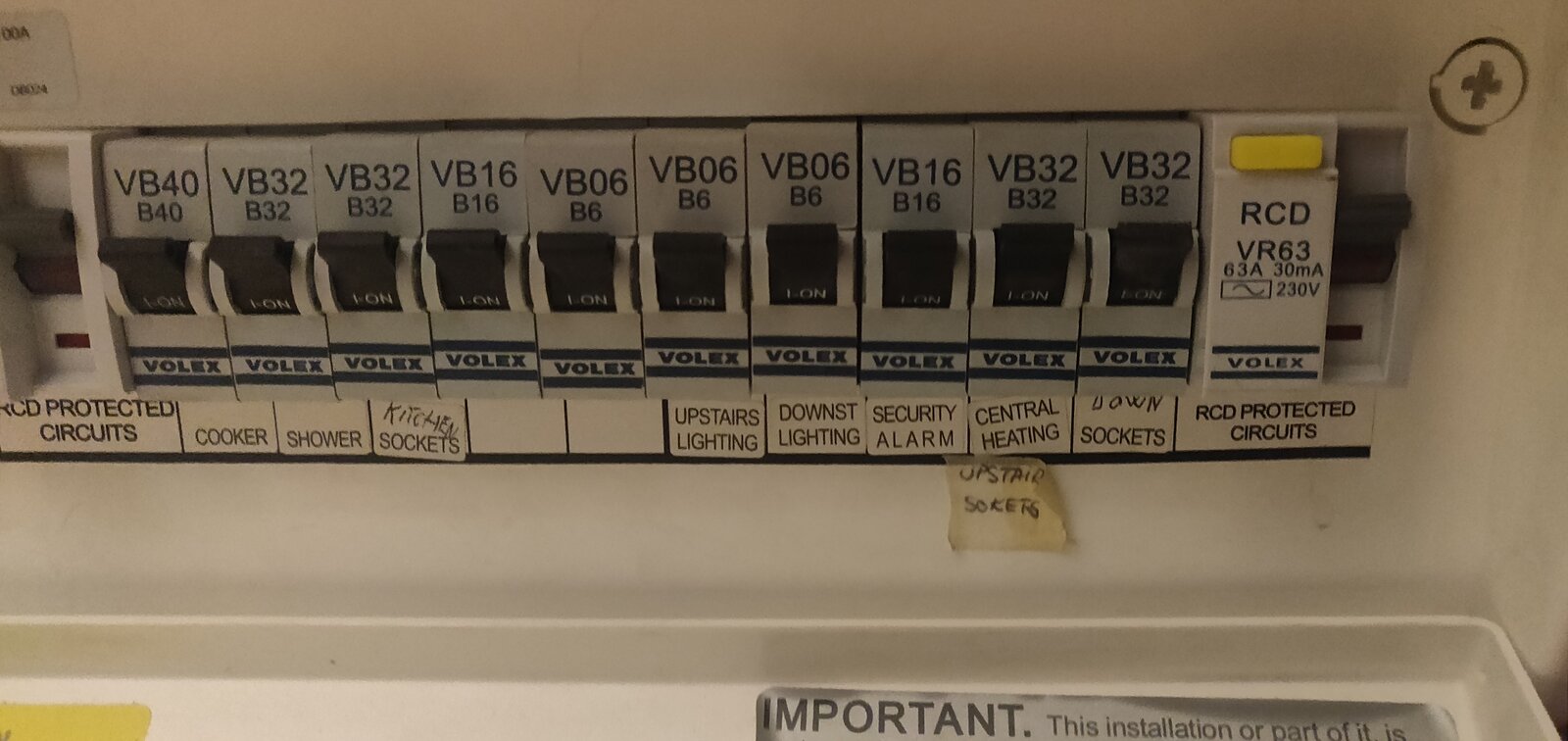

Let me get this right... when you unplug it, the power comes back on to the rest of the house without you having to reset any circuit breakers or similar?
Can you post a picture of these circuit breakers that all trip?
So yes as others have said you should probably discard the heater - but if it makes all of the circuit breakers trip, that suggests a problem with the wiring that should be investigated.
I'm pretty sure I had to reset all of them including the big one as I heard various things coming on as I fired up each switch.
All of these (attached) were down
it’s quite hard to imagine how that could happen... any ideas anyone?
