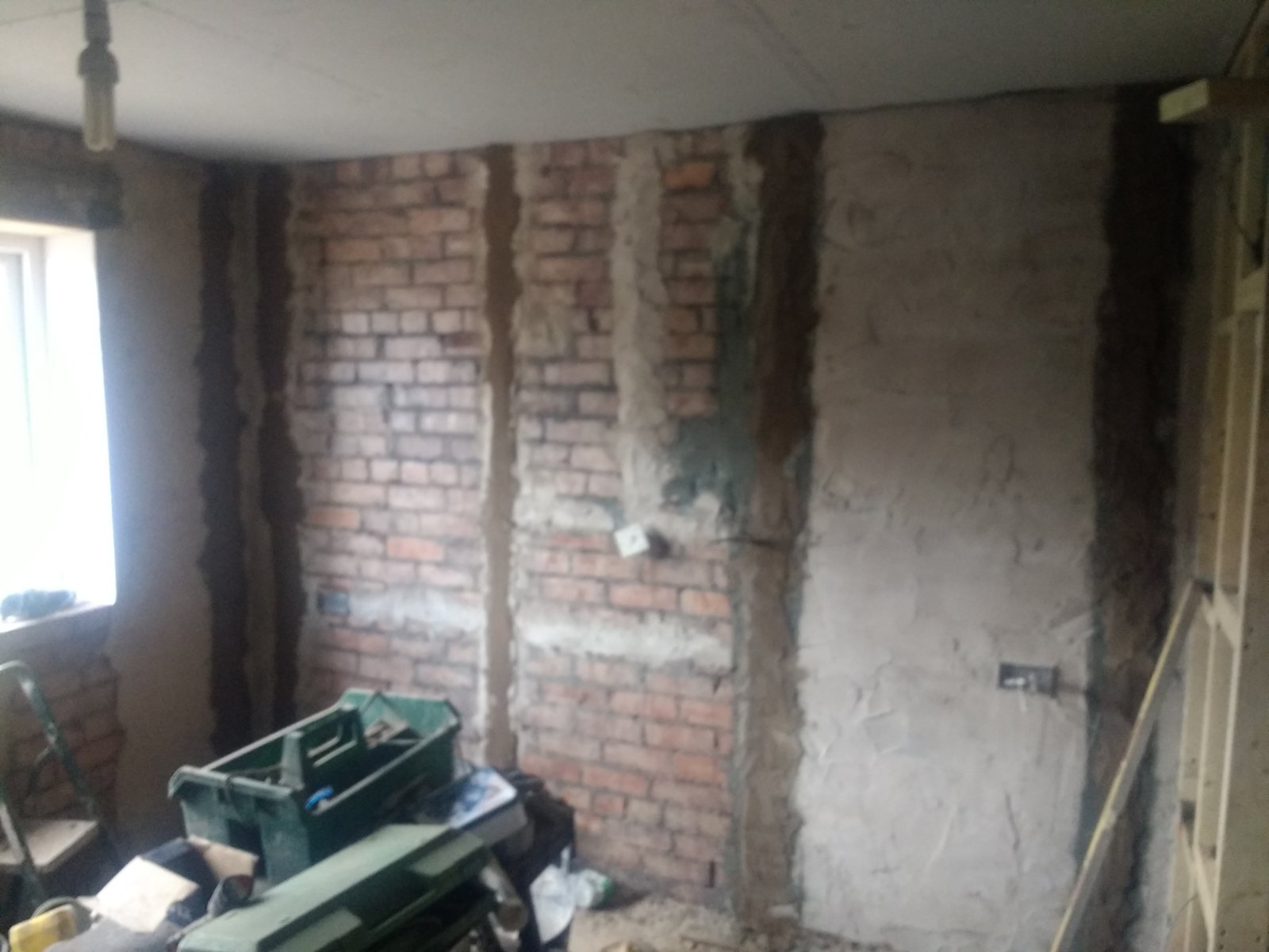

I do it with screws and plugs - 3 per screed, plumb with level (adjust screw screws in and out). Across with string for the middle ones.
I'm doing my bedroom at the moment - slow but doable by a DIYer and millimeter accurate with paitence. Think about using render as it's a bit easier to work with and cheaper - but you'll need to build up the deeper areas in layers.
cdbe, well done, your on the right path so to speak.
keep your corner screeds about 300mm from the corners.
space your screeds about 1200mm to 1500mm apart.
be accurate plumbing down from your "dots" - a perfectly flat an plumb screed to about 50mm above the floor - use a 6' level or a short level an straight edge.
when you have to return on an abutting wall, use some kind of right angle device to set the next two screeds on the return wall - that way you will have perfect right angled inside corners.
cutting the machined corner off a piece of 4' x 8' ply will give you a true right angled, say 4' x 4' template.

Your job is looking good, cdbe but my job is much bigger and it unnerves me. Though it's probably the only way I am going to get any plaster on the walls before Xmas is to do it myself. I'd rather pay a decent plasterer to do the job to be honest and have a go with a small area in another part of the house at some later stage.
