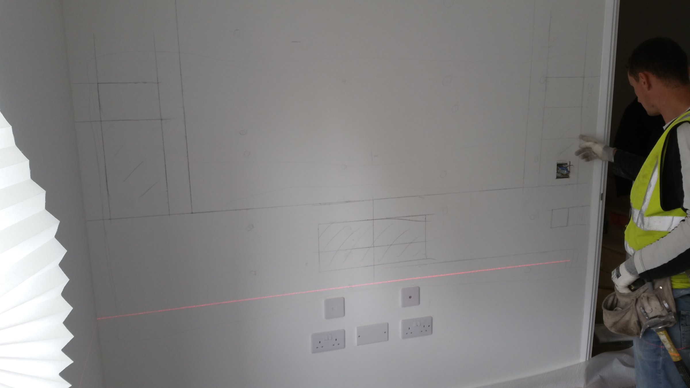

This is my first project in my first house. It's a new-build property and I'm planning on putting a basic cinema system in the lounge. It'll include a 65in TV (21kg), an IKEA BESTA cabinet 180x40x0 (upto 50kg) and a 5.1 speaker system (6kg/ speaker) when I can afford it.

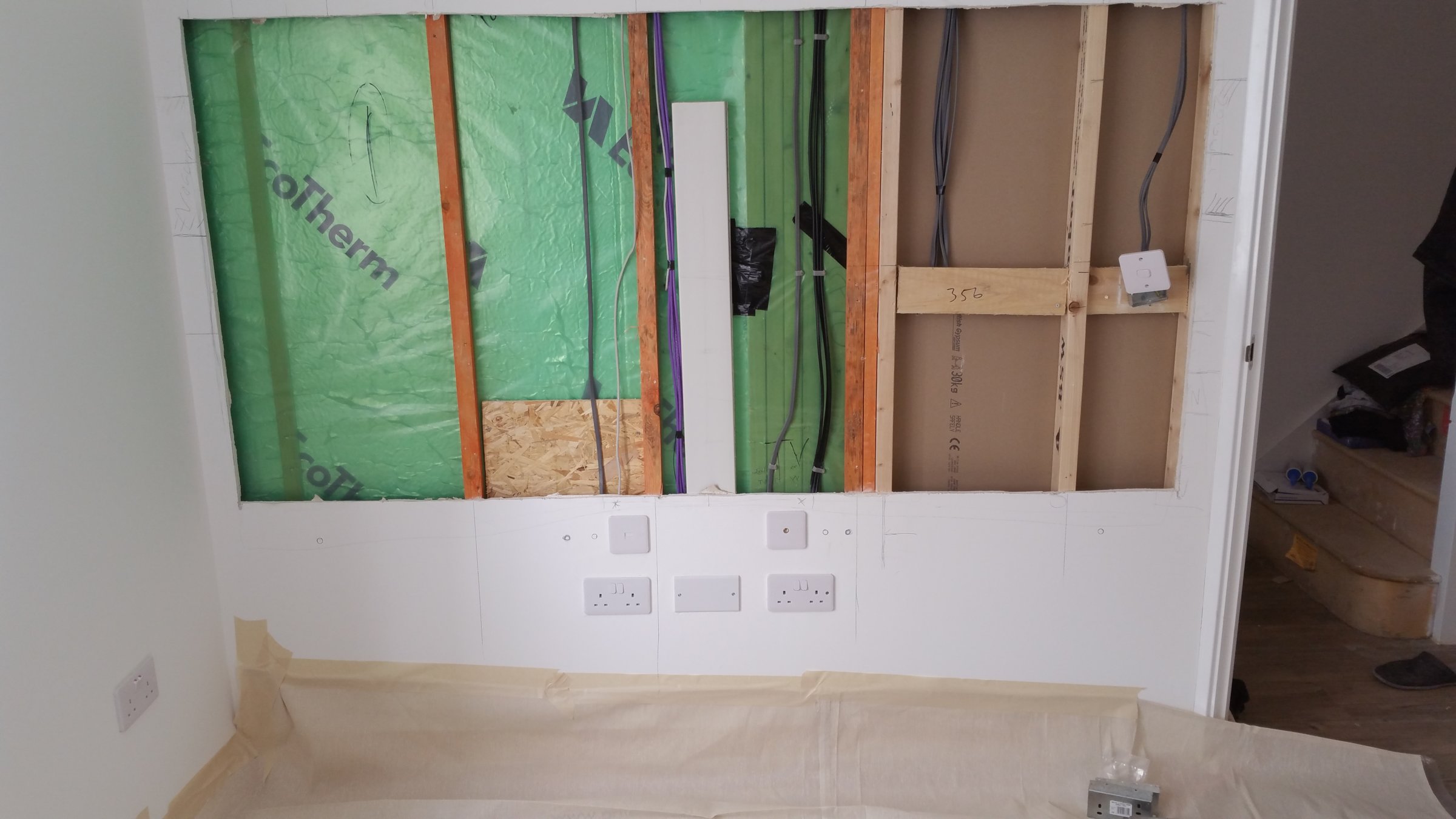

I was able to get one of the contractors on site to cut a hole in the plasterboard, and affix some 12mm (maybe 15mm) plywood with steel angles, and then reapply the plasterboard. What's not shown in the photos is the OSB behind where the TV will hopefully be mounted. The white plastic is a conduit for cables.
BEFORE
AFTER
Owing to the mount I've bought, I can only get the brackets across 1 stud. But behind the rest of the mounting holes, there is OSB.
So I wanted some advice as to how to mount the items. I was thinking about using cabinet hangers for the IKEA BESTA.
But for the speakers and TV, I'm a little lost. I was planning on using snap toggles or spring toggles, but I don't think there will be enough space behind to get them through. Any other advice is really appreciated.

Woodscrews into the studs or the OSB. No need for e.g. spring toggles behind the OSB IMO, unless it’s very thin. I mean, that’s why you’ve put the OSB there, isn’t it?
I think the more conventional way to do this would have been to put large sheets of ply/OSB over the front of the studs over the whole wall and then plasterboard over that. No need for metal angles etc.
Thanks for the reply. Indeed the whole point of the OSB/Ply was to screw directly into that. Would I need to drill pilot holes? And what size would you recommend? The depth of the plasterboard and ply is about 25/30mm (I can't remember off off the top of my head), with a gap of around 30mm to the thermal insulation. The studs are actually batons (slightly orange uprights) on top of the studs and I was planning on drilling a pilot hole in these, and screwing all the way through. 90mm was my plan.
And if I were to do this again, I would've just screwed a large piece of plywood on top of the plasterboard and painted it, as you suggested!

Evening all,
I've started this project and put up one of the 2 bars which will hold the TV. I've drilled pilot holes for the large 100mm screws, and screwed straight in with the 45mm screws. The concern I have is that they all spin when all the way in.
I've tested the 45mm in a bit of OSB & plasterboard around 35mm thick, and whilst it holds, it still spins.
Any advice?
I am a bit lost as to what you're doing but a 45 mm screw straight into osb shouldn't spin.
Short and fat is fine
Hi Tigercubrider,
I've attached a TV wall mount plate to my wall which comprises of OSB fixed to wooden studs (as per some of the earlier images), and then plasterboard on top; around 30mm total. Along with 45mm wood screws, I've placed washers to spread the load of the screw. I think it's the washers which are allowing the screw to spin. The screws without washers are 100mm which are in the studs.
I have to attach an identical bracket a few inches underneath and I'm thinking of using Rawlplug Hollow anchors instead. What would your suggestion be?
Possibilities include:
- You’ve massively over-tightened them, so they’ve stripped out the holes. (How did you screw them?)
- Pilot holes too big.
- Screws have too much unthreaded shank, so all the actual threads are all sticking out behind.
Nothing to do with the washers.
Experiment on a bit of scrap before you do the other one. It looks like you can fit more of the smaller screws for that bracket, but you might want to move it up or down an inch or so and re-do the stud screws.
I didn't drill pilot holes for the 45mm screws, only the 120mm ones (of which there are 2) and they don't spin at all.
So I've either overtightened them or left unthreaded shank. As the thickness of the substrate is 30mm, there will be 15mm of screw sticking out the back.
My plan for the 2nd half of the bracket is to use 2 Rawlplug hollow wall anchors alongside the rest of the fixings, and this time just screw the 45mm wood screws in. Would you say that should be ok?
