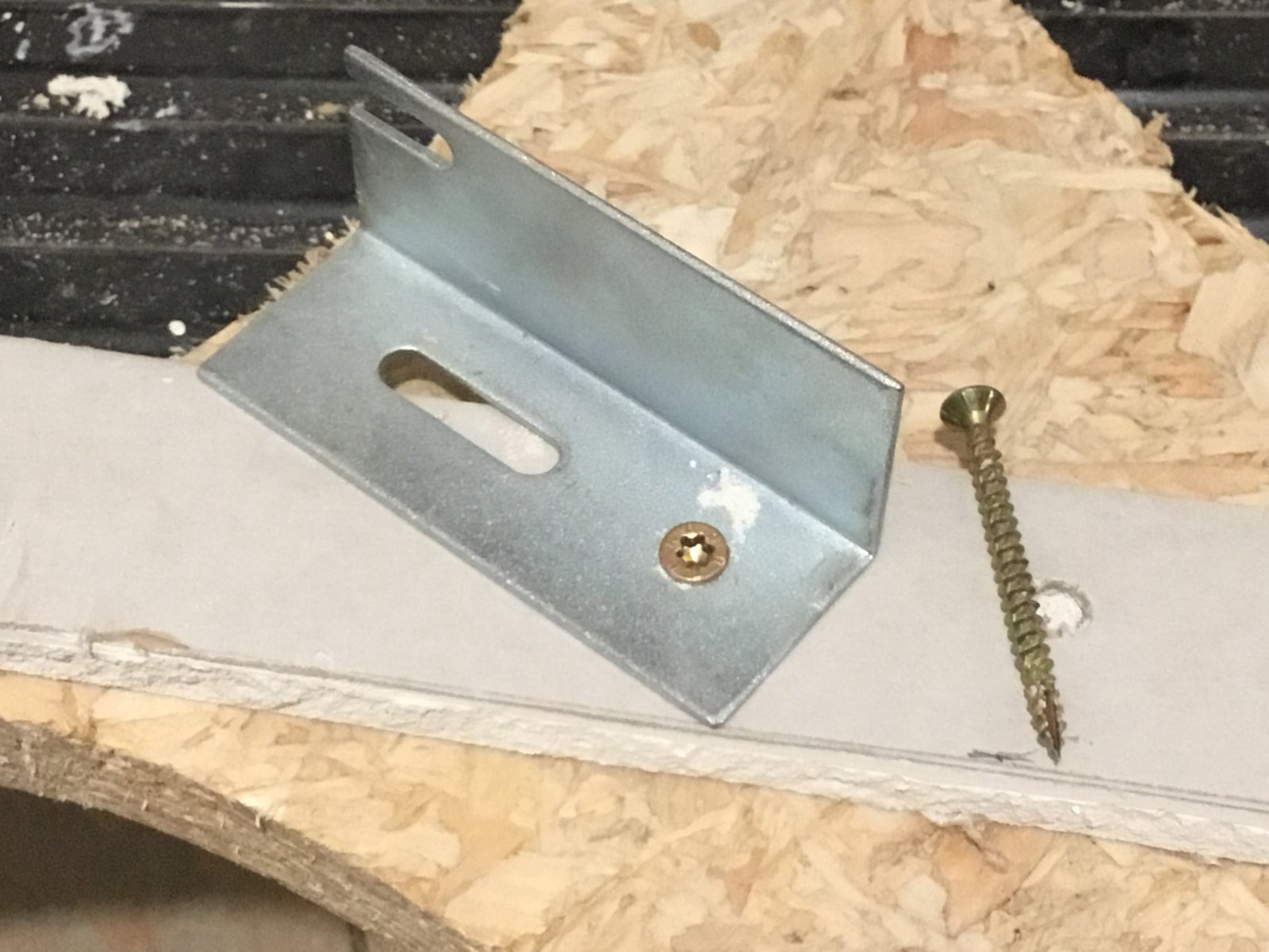

The 4x45mm were screwed straight into the plasterboard & OSB with a washer. If I try screwing these, they continue to spin.
For the 6x120mm, I drilled a 3mm pilot hole then drilled the screw into the wall which is Plasterboard/ 20mm baton/ Wooden Stud these don't move.
I have to attach an identical bracket about 3 inches beneath the one already affixed. I'm going to be using the same method to screw to the studs, but want some advice on the smaller screws.
If you look at the picture of the bracket, the screws without washers are directly in the studs.

I’ve just tried an experiment with a 4x50mm screw into a piece of plasterboard and OSB, and it’s solid. No spinning. See photo.
Is it possible that the screws have gone through the plasterboard and then just pushed the OSB away?

First of all, thank you very much for taking the time to do that and upload a photo.
Directly underneath this bracket, I have cut a square to allow for cable access. I can access a part of the plasterboard/ ply and have tried screwing into that, and it still spins.
I'm at a loss as to what has happened. I'm going to have a look this weekend then will report back.

What are you using to screw? An impact driver set to a high torque setting?
It soesn’t matter how slowly you do it if you don’t stop when you should!
Try again and use the torque settings. It should be just enough to make it tight but no more.
Having said that, I’ve gone back to the screw in the picture and tried my driver’s drill setting and it jumps out rather than stripping the hole.
Perhaps your OSB is more crumbly than mine.
I would use the screw setting, use short pulses to drive the screw in, not one long blast
