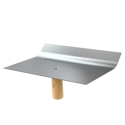

I use a bent plastering hawk and force mortar in using finger trowels,and also use a mix slightly wetter than damp.and don't buy a pointing gun useless.
Make your own using old aluminium hawk.
