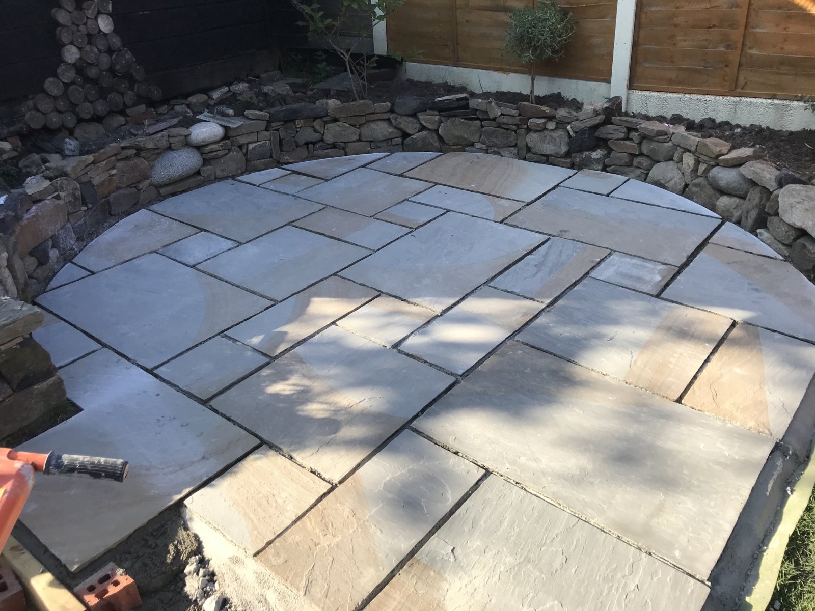

Mines got a bit wrong.

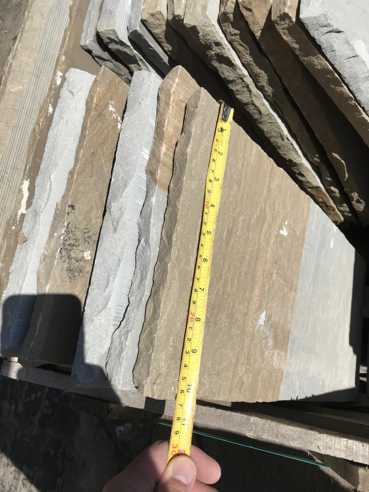

The slabs were 900x600, 600x600, 600x290 and 290x290 with the pack saying 18.9mtrs coverage with a 10mm gap.
I put a 900x600 down first then lined up a 600x600 and 600x290 along the edge of that. That gave me a 20mm gap.
Turns out the sizes of the slabs were off by upto 20mm so now I have gaps of upto 30mm in places. Only solution I could have seen would to have cut them all again. It’s just a bit of paving near my shed so if I did some near the house I’d get a more expensive/accurate slab.
Will the Geofix do upto 30mm joints?
This is a 290 measured at 265, I’d done half before I realised :LOL:
