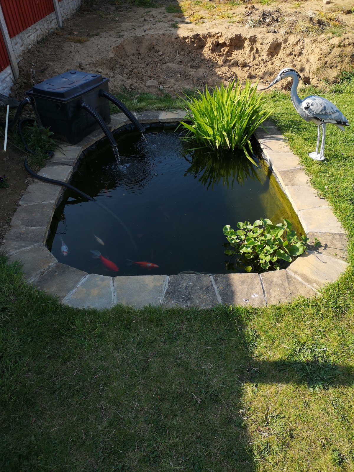

I built a pond in my garden last year. It is ground level and I have kids so I want to build a fence around it. The fence needs to be sturdy yet allow kids to put their hands through to feed the fish. I've seen some metal wrought iron stuff at b&q which looks ideal but it's a bit pricey and the posts are too thin to offer any real strength to it, they just hammer into the ground.
I am pretty handy and can build a fence from scratch so wondered if anybody had any ideas on here that I could knock together quickly and cheaply. I'm thinking a picket fence or even sturdy trellis panels would work. I'm open to ideas.

I've attached an image of the pond. As you can see the garden isn't finished which makes it harder to do anything permanent right now. I've looked at that wire mesh and rebar before but I know it rusts which isn't ideal.
I think I will go down the route of a home made picket fence. Maybe with a couple of perspex viewing windows in it. I might do some drawing tonight.

It needs to be non-climbable, which means no horizontals. Try searching ebay for “Railings”.
For gods sake Steve , DO NOT TAKE ANY CHANCES. I laid a sheet of road mesh over my pond which I painted with Hammerite first, it did not rust and I could stand in the middle of the pond with a bit of flex but was totally safe.

This is what I opted for. Its not the strongest fence granted but if we have any failure incidents I will beef up the posts with timber. Very pleased with it myself. Total cost for the fencing was £140 from b&q.

I'd still go for a road mesh over the top, you can never be too sure they will not climb over that especially when a lost ball is concerned.
