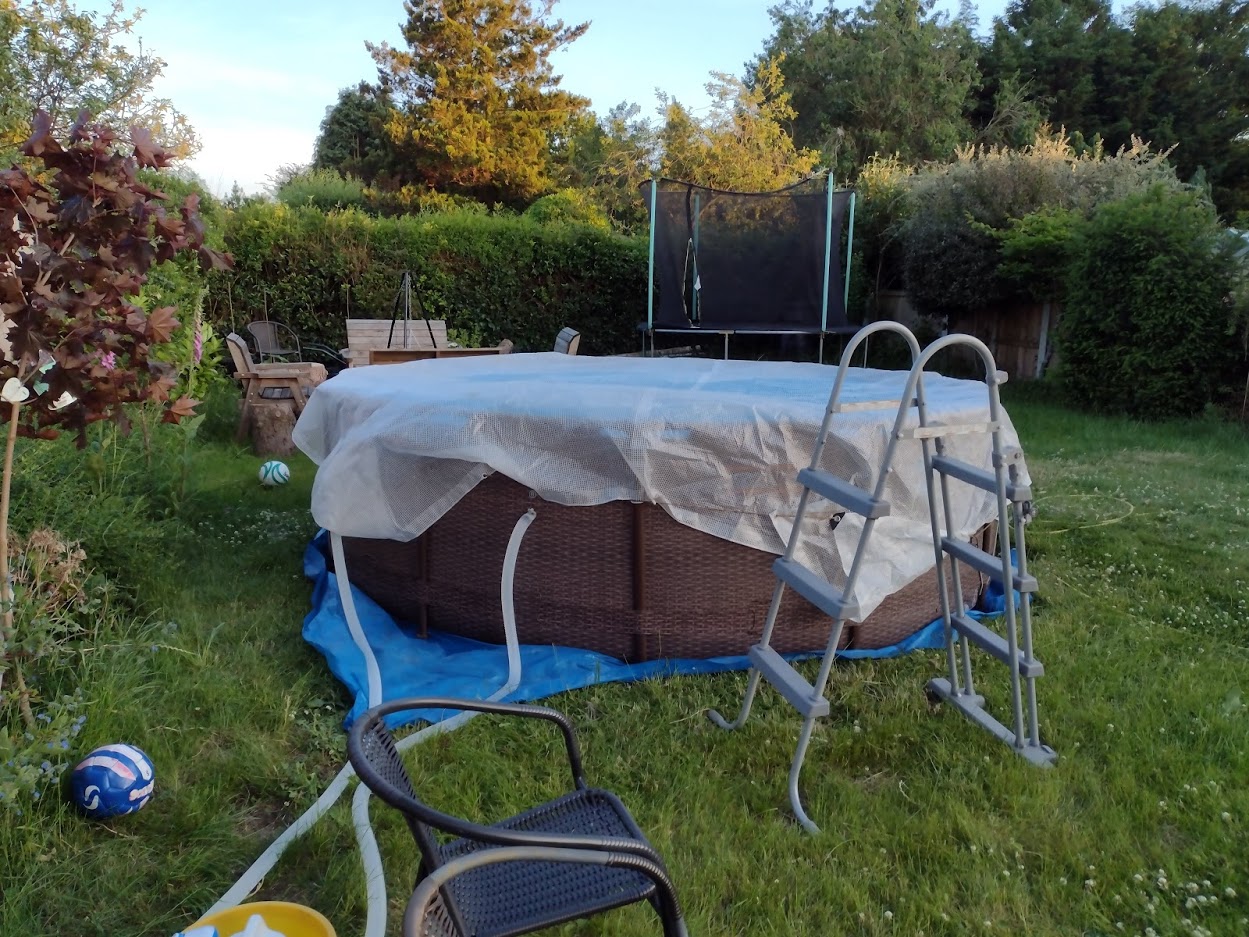

So, how long should it take for a 4Kw heat pump to raise the temperature of a 9000L pool by 1 degree C on a day like today?
Temperate not moving. I am probably being impatient. Well, it went from 14 to 15, then back to 14 ... must have been on only an hour and a half ish ...

It is about 20 degrees out there tonight, and the pool has a bubble cover on the surface, and a tarp over to reduce airflow. It really should seem warmer after 12 hours ...
The problem with these type of pools is that both the hot water coming in and the 'cold' water going out are located at the top.
So basically, as heat rises, what happens is the 'hot' water is pumped in at the top, swirls around on the surface and is then drawn into the skimmer compartment which naturally returns it to the heater. The heater is sensing the return flow as quite warm so doesn't heat up any more until it feels it is needed, but in actual fact the main body of water is quite cold so sits below the return outlet.
A pain in the backside but try going out each hour and giving the whole body of water a good stirring with a canoe paddle, if you have one, of a soft bristle sweeping brush. This will make the return flow much cooler so the heater will kick in and begin to warm it more often.

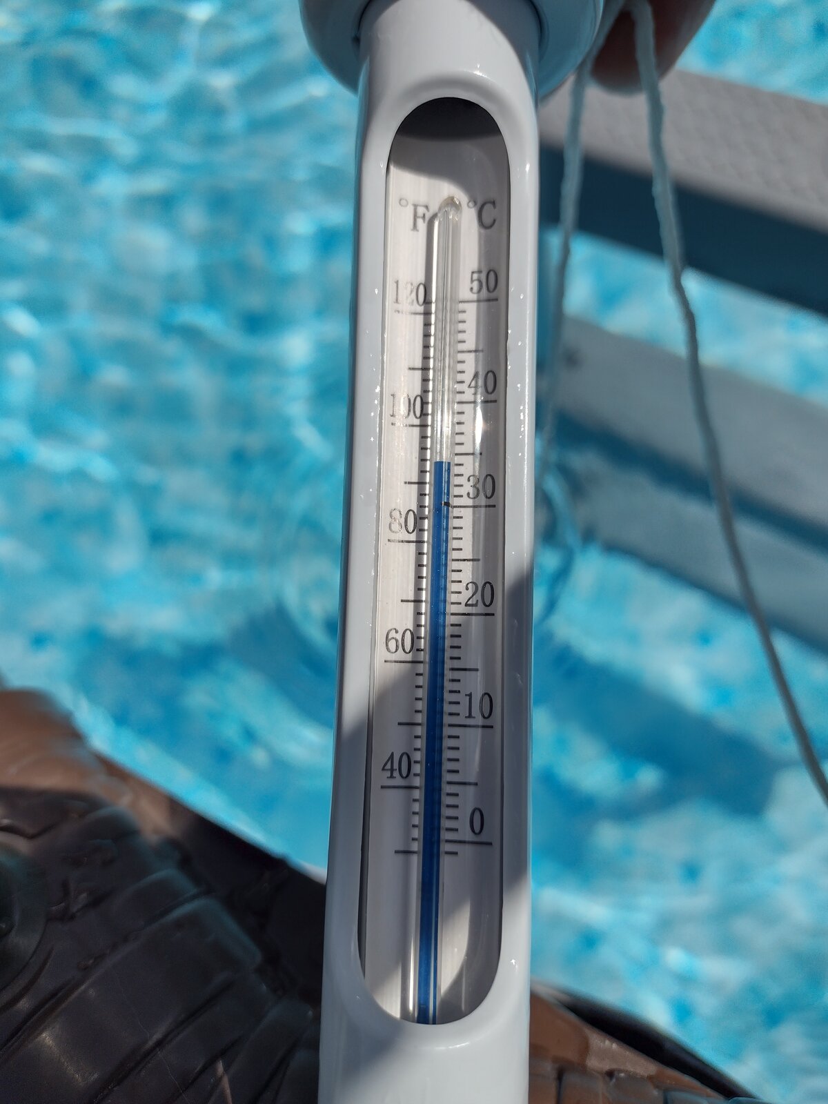

Well, the weekend was a success. Water temperature on thermometer in the pool was 31 degrees all the way down, but the temperature on the heater peaked at 21 degrees. But there is no way it was only 21 degrees. So heater works, but I suspect the heater's thermostat, or just the display, is not. Will speak to supplier today.

Was this taken near the top of the water or at the bottom of the pool? As heat rises you may find the top layer of water is warm but the lower levels are quite cool. A good stir up first will give a truer reading.
no, this is fully heated. I put the thermometer at the bottom and just as warm. Was too warm really!
System is a bit annoying. The heat pump thermostat does not record correct temperature at normal pump flow, says it is cooler, so warms too much. I reduced setting to a lower temperature, but if the filter gets clogged and flowrate slows, the heat pump thermometer records a more accurate temperature, and cooling stops. Pool was a bit cooler today, still OK, but not warm.
