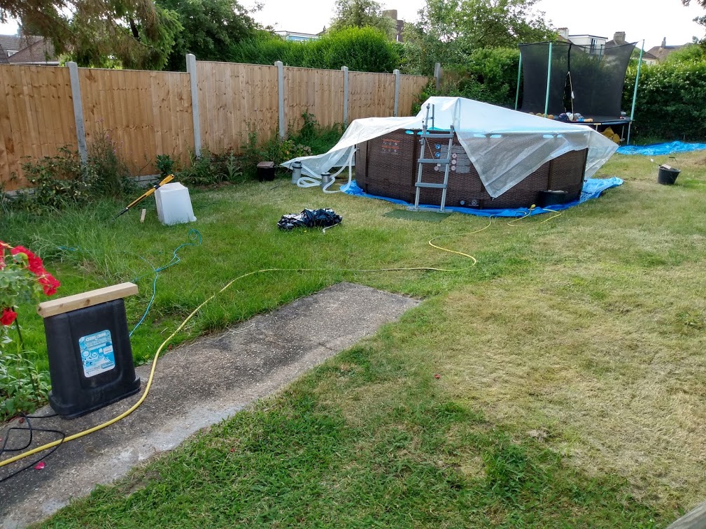

Plan is to heat for weekends when my wife and I might join the kids.
The current set up - 2 15 metre extension cables (only need 20m) on bricks, under some plastic boxes.
I doubt the thermostat would ever kick in to turn the heater off, if thats the case it could cost around £7.50 a day to run:eek::eek::eek:
You might be able to help save some money, using solar. A long dark coloured hose, laid /snaked where it will receive maximum sun. One end placed at the bottom of the pool, other at the upper level. Filled with water it will collect heat and self circulate the heat into the pool for free.
I would be cutting those hoses shorter to reduce heat loss to the air and ground.
If they need to stay long, lift them off the ground (or reduce contact area).
Wrap them in 'wrap pipe insulation' or even old towels/clothes (not sure how to keep this dry from rain though)

Will look into that. Cannot see how they can be cut and still have a good seal though,

I think you will have a problem fitting the hoses if you shorten them. The ends have a smooth inner and outer surface so if you cut them you would be left with a ridged inner as well as outer and you would not get a good seal with the small plastic clamps. If you can get some pipe insulation around them then all well and good, but do not attempt to modify the actual pipes.
