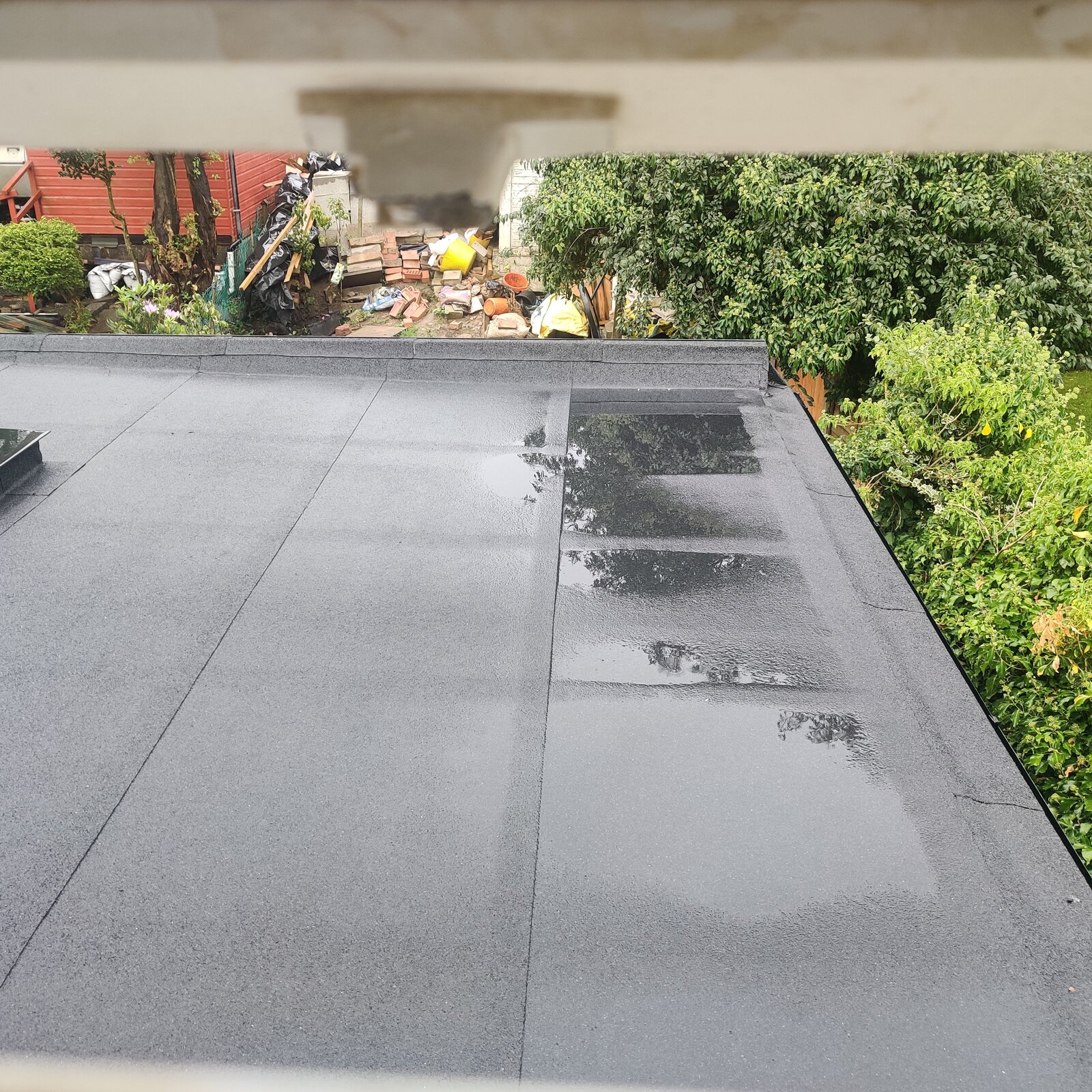

Hi everyone,
I'm back again needing some advice on my extension roof. We've got a felt cold roof installed, but the firing strips are too short, leading to an inadequate slope and water pooling.
Initially, I thought adding a channel at the edge would drain the water into the gutters, but one roofer thinks this won't work and suggests overboarding with EPDM.
This essentially means building a new roof on top of the existing felt, which would leave the felt roof acting as a vapor barrier, but the cost is around £3.5-4k.
I'm a bit confused about the best solution here:
- Would a channel actually be effective in addressing the pooling issue, or is it a temporary fix at best?
- Is overboarding with EPDM the only long-term solution?
- Are there other options to improve the drainage without completely rebuilding the roof?
Any thoughts or experiences you guys have would be greatly appreciated!
I've attached a couple of photos to give you a better idea of the situation:

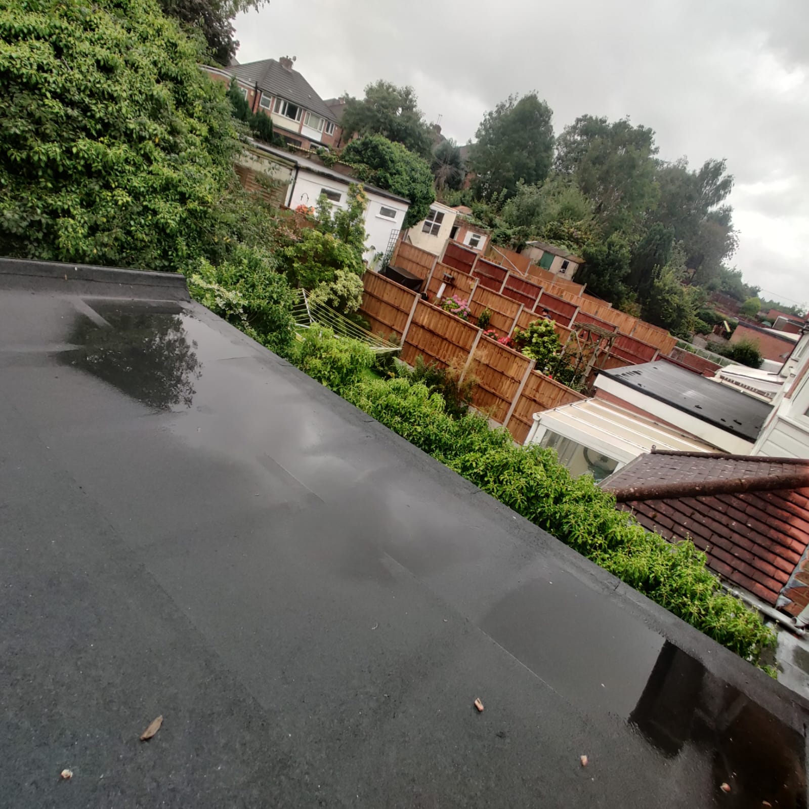

I'm not a roofer, but to my eye - that looks absolutely fine, for a flat roof. You cannot expect all traces of water, to instantly drain away, unless you have a very steep slope on the flat roof. Then it wouldn't be flat.
I agree with you to an extent about flat roofs in general, but this looks like 'significant' pooling to me though, and it looks as though the weight has slowly began to cause the roof to sink overtime. The roof is approx a year old.

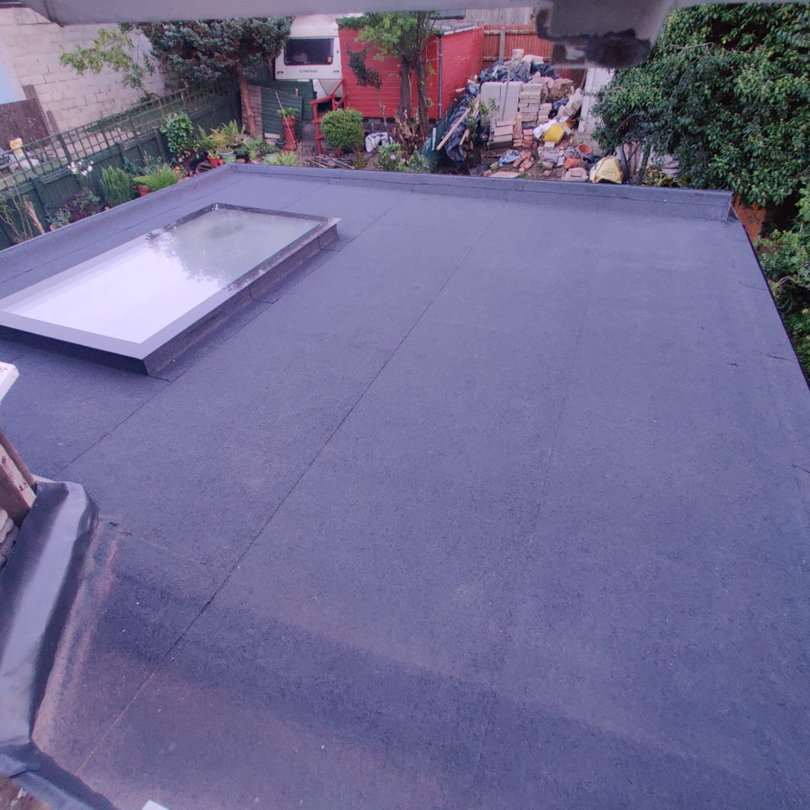

Here is an image of the roof on application of the first layer of felt. Note: we initially wanted to do a parapet roof hence why the external wall was above the roof. However, neighbours were understandably not too happy.
You can see from the image, the slope is perfectly fine until the point that sinks in and then levels off.

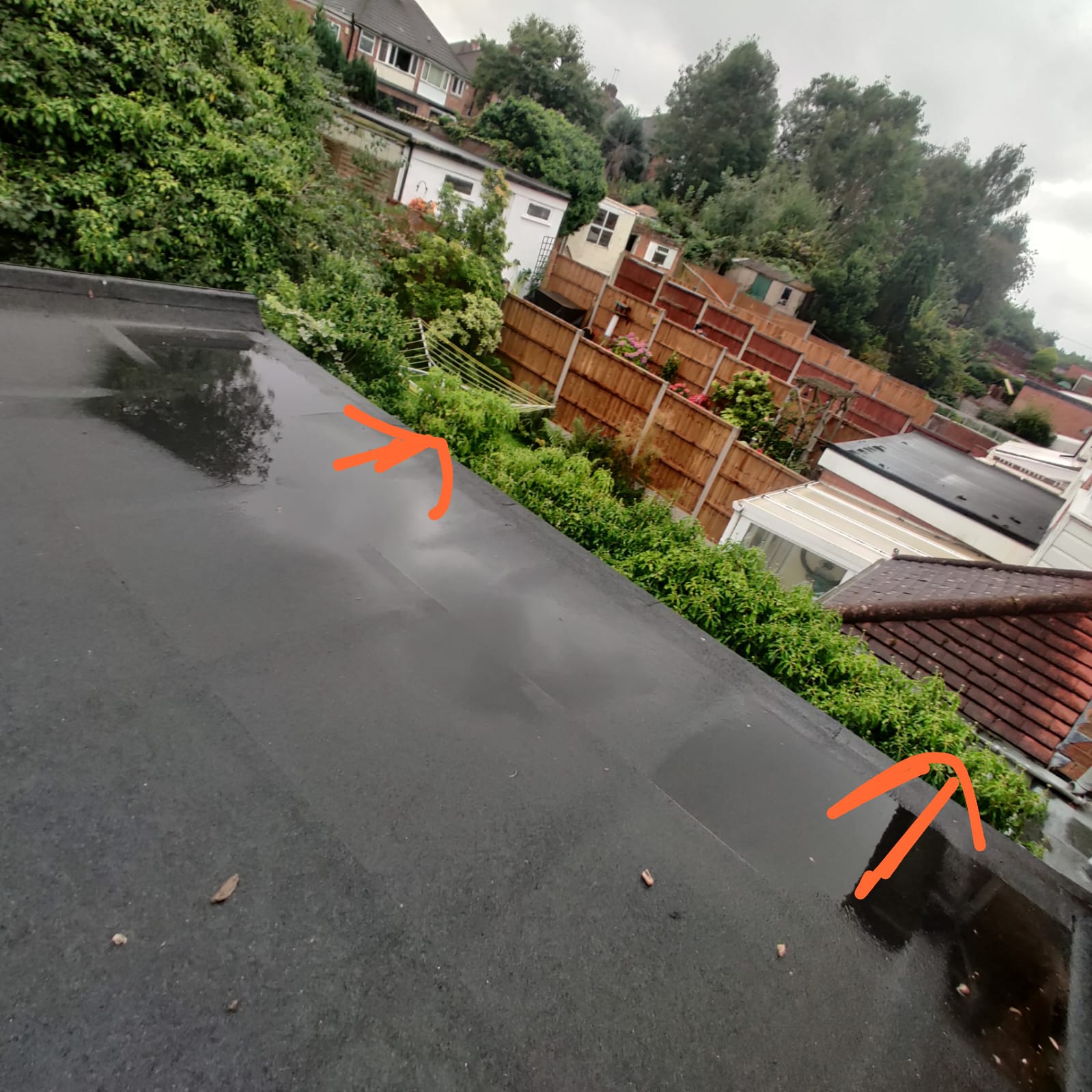

No a flat roof that has standing water has inadequate falls, whilst a roof may be called a flat roof it must still have adequate falls, minimum 1:80. The definition of a 'flat roof' is one with a pitch that has a pitch of 10 degrees or less. There is such a thing as a Zero Falls Flat Roof where you might try to achieve a dead flat roof or one with less than a 1:80 fall but this is not one of them and you would never build one in this scenario.
Nevertheless @Kingo206 I wouldn't worry about it, at least the laps are going the right way.

Thanks for the feedback @freddiemercurystwin.
Are the laps actually going to right way though, this is the final position of the roof in the image below for clarification.
So you wouldn't be concerned re: the standing water, particularly given the amount of pooling that's there?

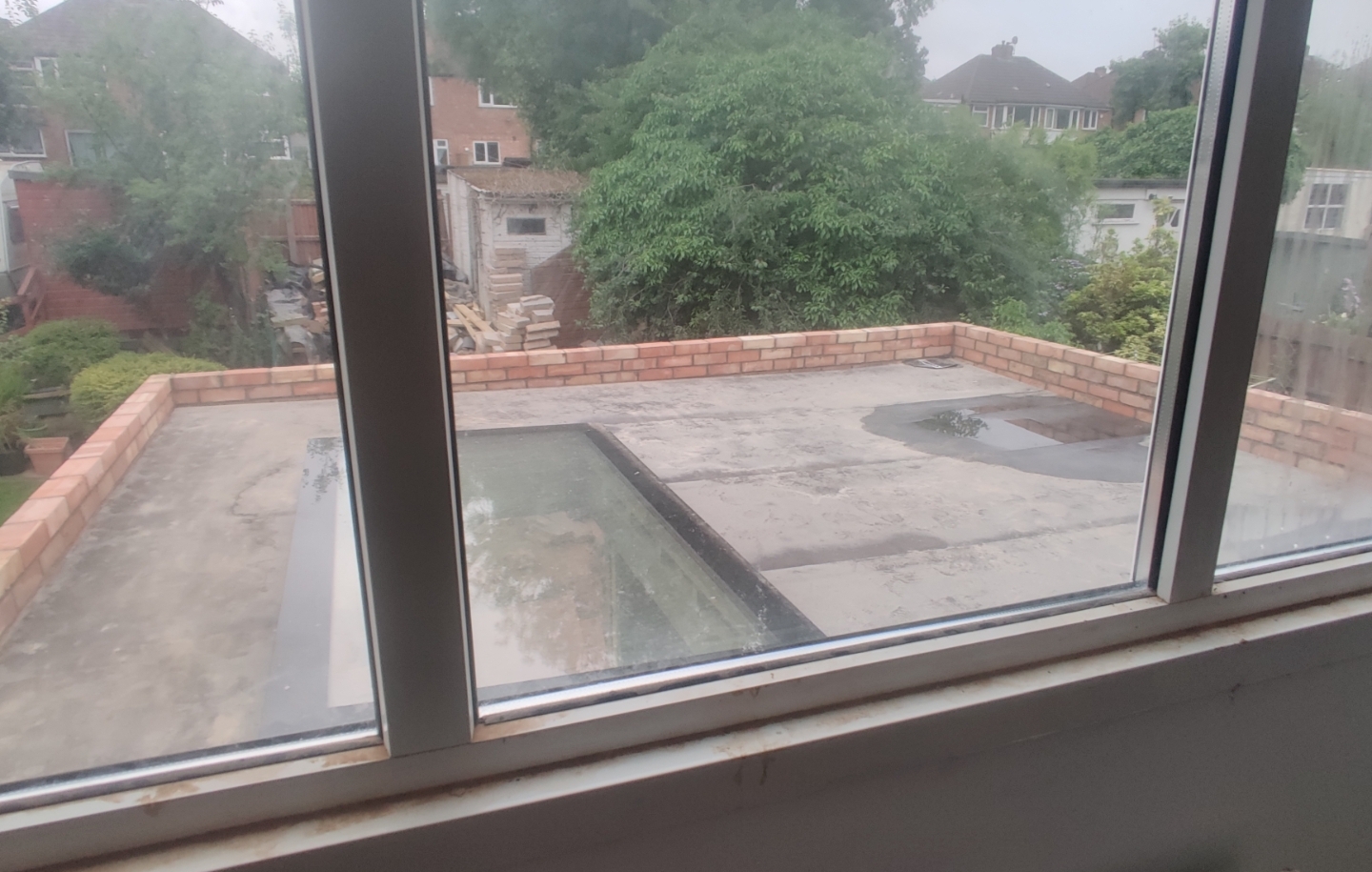

Although it is worth mention, in the original post, the roof with no water is when the roof was newly finished.
The roof with the standing water is a year or so after installation. The standing water has progressively increased I feel, but I will keep an eye on it.
