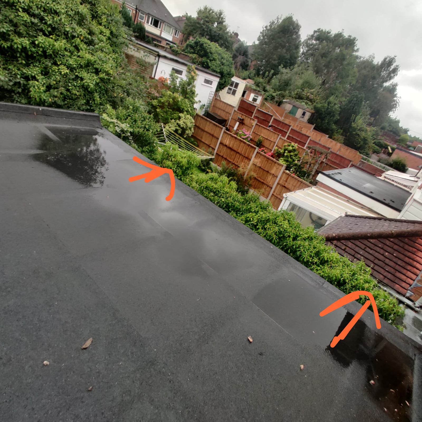

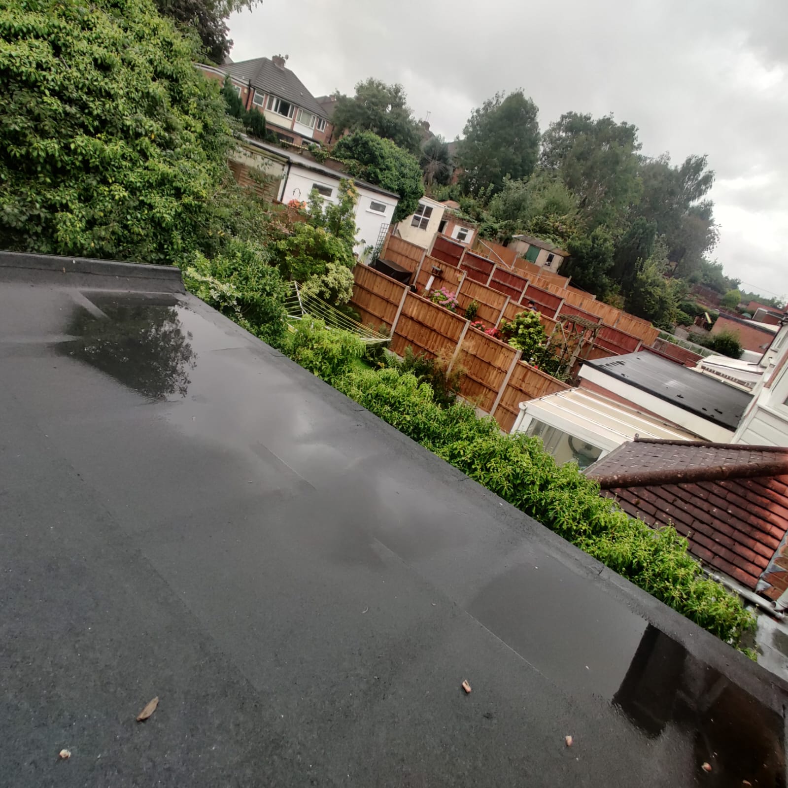

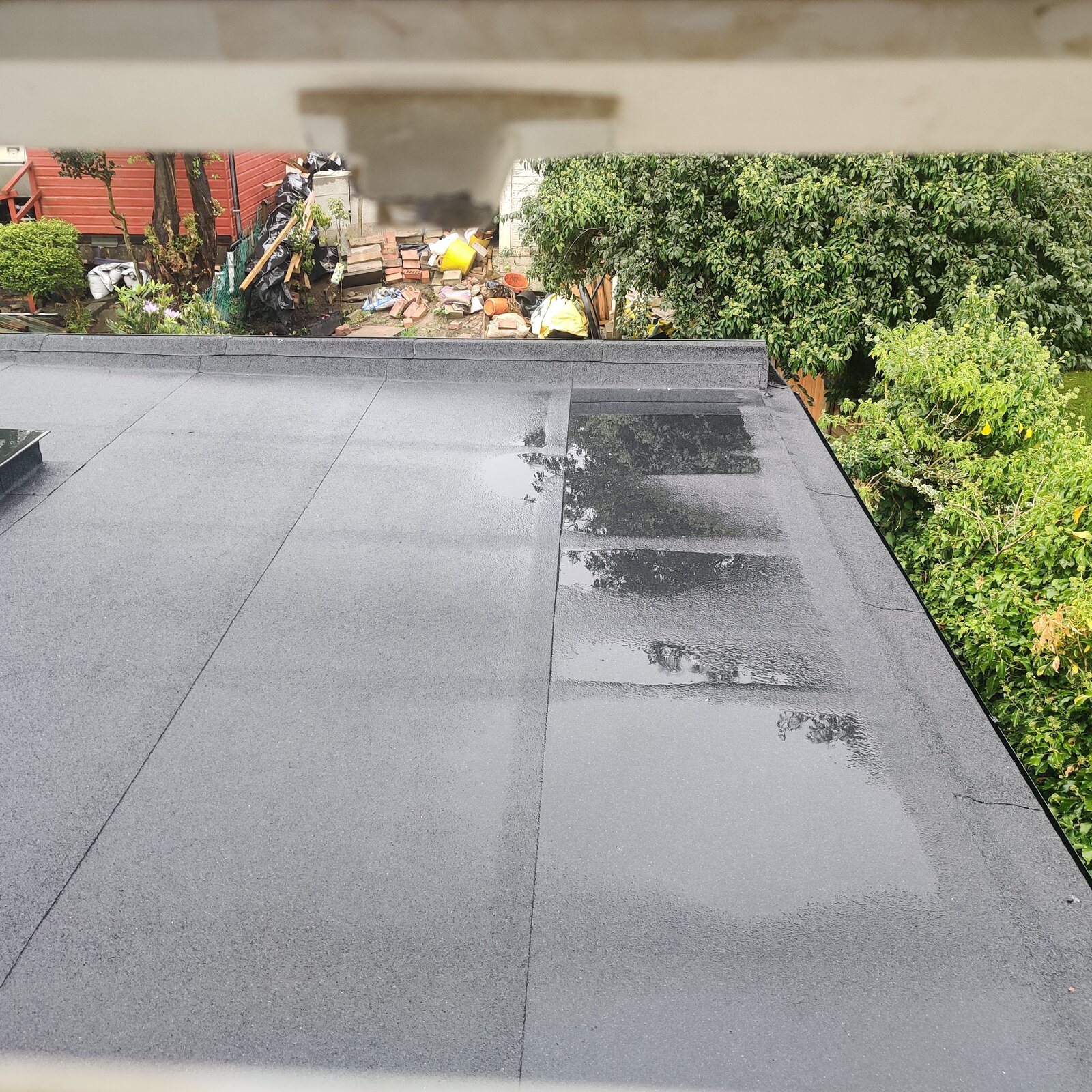

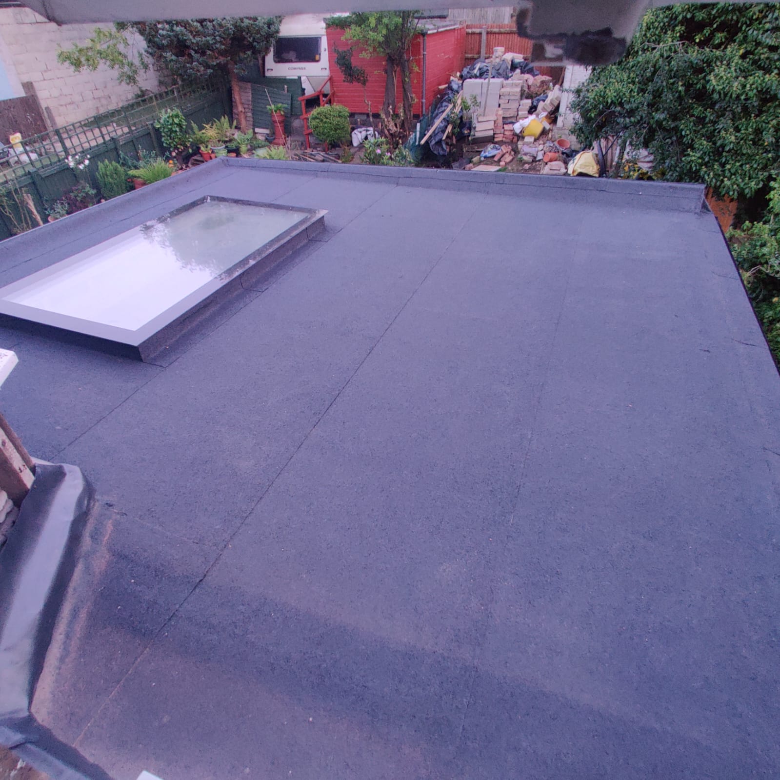

Hi everyone,
I'm back again needing some advice on my extension roof. We've got a felt cold roof installed, but the firing strips are too short, leading to an inadequate slope and water pooling.
Initially, I thought adding a channel at the edge would drain the water into the gutters, but one roofer thinks this won't work and suggests overboarding with EPDM.
This essentially means building a new roof on top of the existing felt, which would leave the felt roof acting as a vapor barrier, but the cost is around £3.5-4k.
I'm a bit confused about the best solution here:
- Would a channel actually be effective in addressing the pooling issue, or is it a temporary fix at best?
- Is overboarding with EPDM the only long-term solution?
- Are there other options to improve the drainage without completely rebuilding the roof?
Any thoughts or experiences you guys have would be greatly appreciated!
I've attached a couple of photos to give you a better idea of the situation:
View attachment 354465View attachment 354466View attachment 354467View attachment 354468
He didn't take the furring strips all the way to the ends of the joists. Common mistake.

I'm going to go against the flow, literally, I think it's not even level but slopes back. The water is gathering right on the edge of a seam. When it inevitably freezes in the winter it will push the very edge of the seam open, then a bit more every time until it finds its way through.

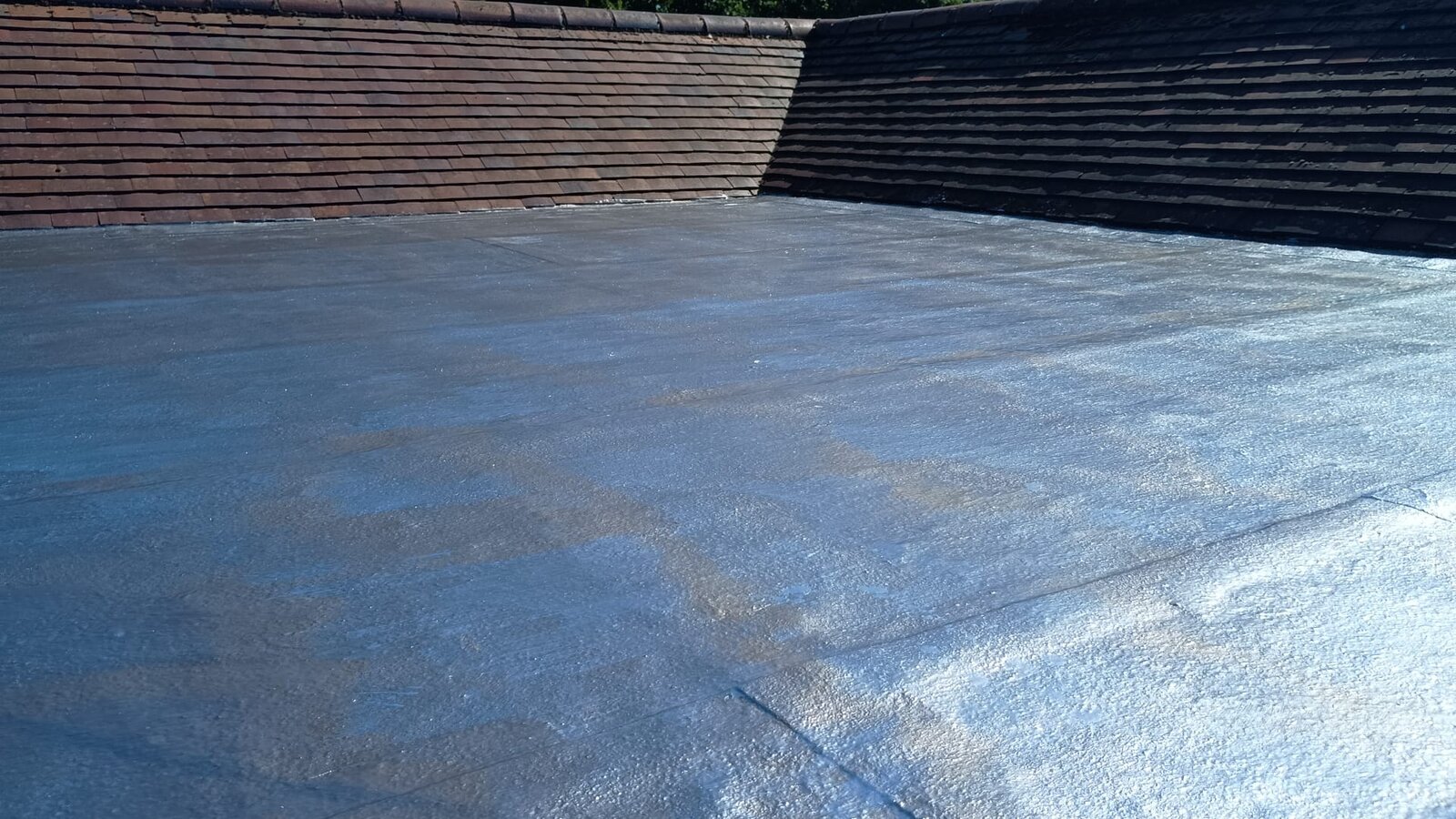

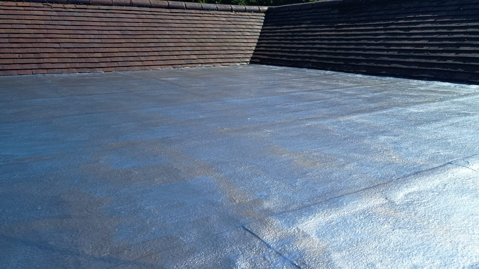

Yours looks otherwise OK though, which is why I suggested the Black Jack. It's a bitumen paint, i.e. made of the same stuff as the felt, so it bonds and becomes as one with it. You wouldn't be able to peel it off it you wanted to, it's all one sheet of a single material once done. It contains fine fabric threads, so knits itself together. When I did mine I made extra effort to gob it into the seams then finished it by brushing up the joint, leaving a smooth ramp rather than a step.
The silver top coat is to keep you cooler but also prevents the bitumen below getting degraded by heat and UV.
Mine after its recent second silver coat. The paint's still wet here, hence the weird patchy colour. It goes an even silver/grey colour when dry...
You'll also see that it highlights any dips or bumps, less so once dry. It looks like yours won't be visible anyway, so won't matter at all. But the room below was a few degrees cooler the next day, it's good stuff. That lip near the bottom isn't opening up, it's just a shadow. In about five years I'll overcoat with the black gloop again and sculpt this into a ramp.
If you were starting again then the answer would have been rubber, GRP or a pitched roof, although all options come with their own issues and nothing lasts forever. But as you are where you are you'll get decades of protection from a few tins of paint.
After 5 years since the previous paint, the silver had vanished where the water was pooling but the black paint below was absolutely perfect. Definitely no peeling anywhere, the felt below doesn't see either the sun or rain at all.

Thanks, I have had two roofers here who confirm there is a slope up to particular point then it simply becomes flat/level.
I will leave it for now, sort it structurally when it comes to re-felting.
