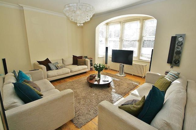

Dominoman, can you post a photo of the window area, that the err,, umm,,, "plasterer" was afraid of, saying it was "too hard to do".

This is a picture of the lounge (from when we bought the house so the big TV has gone now). The bit the plasterer said he couldnt do was the other side of the arch, and above the windows. I didn't mind about that so said OK. The walls there are already in good condition and have been papered so I was going to just paint over the old paper.
That's a lovely front room you have there , but the bad plastering that's been done means there's a lot of remedial work to get it to look right, it should be nice and tight along the skirting not all over the place I could do better with my eyes shut one hand behind my back and standing on one leg there's nothing hard in your front room its all straight forward what did he do with the arch?
