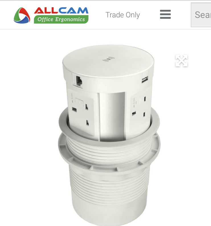

ive been looking for a pop up 13amp pole for a kitchen island, i can find ones with USB charging sockets but none with network sockets, any ideas anyone?
What exactly do mean by “network sockets”
Do you mean RJ45 as used for Ethernet networks, or something else?
Ahem
4 individually fused sockets. Don't they know plugs have fuses in them?
Just noticed fused at 3.15A. What. Your kettle! Your toaster! Wouldn't have that on a kitchen island.
fused at 3.15A suggests it uses odd size (physically) fuses ie glass fuses 20mm ?
Possibly made for a desk, not a kitchen worktop. But I posted merely to illustrate that if you Google (even a bit) then it’s possible that a solution may appear.
Over to you @markymark2406
There appears to be a standard (BS6396) for office furniture (which has recently been expanded in scope to furniture in general) incorporating sockets fed from a 13A plug requiring sockets to be individually fused and no more than 6 of them to be supplied from one upstream 13A plug, god knows why.
I would be very reluctant to up-fuse a product based on what some distributor says. Especially when they seem to be suggesting up-fusing it with a fuse that does not exist.
A MIG welder would not have a 13a plug on it if its loading was greater than 13a. If it was lower it should not matter.
I repeat:
Someone, somewhere does not know plugs are fused, or is seriously lacking in brain cells.
There’s no need to repeat. You obviously miss the reason for the fuse in this PARTICULAR environment!
Ahem
Very misleading instructions. They say you can replace the 20mm fuses for 10 or 13 amp, they then say these fuses are available to buy from them, and then they only offer 10 amp ones.
BS 646 fuses (19mm x 5mm?) supposedly only go up to 5 amp.
Would the 20mm 10 amp ones the company can supply do?
Or do 13 amp ones exist? Counterfeit or otherwise?
