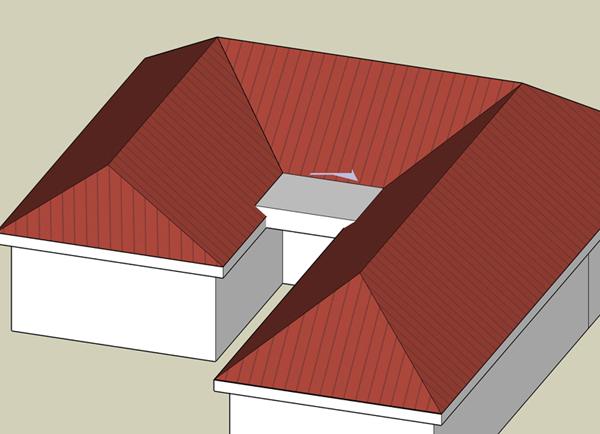

Porch Roof on Bunglaow with Big Eaves
I was thinking that it may not need joists as it is small enough to get a one piece poly sheet with three walls and a door.
Thinking about it and in the name of aesthetics, it would look best if the fascias were level.
This would mean that the joists would sit at the same level as the fascia and not up by the existing wall plate. It would still involve lay boards up the roof in order to take the flat roof material up the slope.
I'm still concerned that a flat roof, with all the other sloping roofs discharging onto it, could end up as a paddling pool :confused:
I think you are suggesting a flat roof something like this
Facia in line or not, lifting tiles etc. with a roof lantern added if I want more light.
Or is my flat roof best thought of as a big common gutter?
No matter how you tackle this the water run off will be considerable and that a lot of care will need to be taken when building the roof.
Your image shows the deck of the roof actually higher than needs be.
The (horizontal) part of the deck only need to be in line with the fascia top, but lay boards (up the roof pitch) will need to be fixed so that they weather the lower part of the rafters.
You will need the roofer to take great care when fitting the roof light.
The flat roof will slow the water down before it discharges into the continuous gutter.
A flat roof is not flat, so done properly there is no ponding
Depending on where the existing fascias are in terms of frame heights, you could end up with a low ceiling and it looking cramped and "wrong", unless the roof is raised above the fascia level
Here is how the new roof should be to keep the ceilings level

Here it is in part section

Here is it showing the fascia higher than existing

Here it is with fascias level and a slight tiled front

Another view from above
