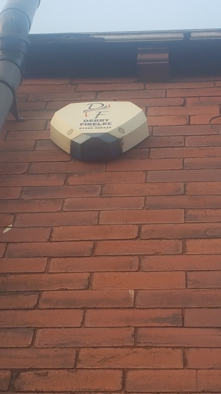

My alarm frequently chirps or goes off. No errors occur on the keypad and no known errors on sensors.
I have both front and back bell box that have batteries. Front ones fine and does not make any noise.
But the back one has been going off intermittently today. Suspect it's the battery as it's 5yrs.
Due to the current restrictions. If I remove from the alarm panel the sounder for the outside. Will this silence the alarm temporary unt I can get a new battery.
Thx
Errr no....! I think the the poster is saying the BELL BOX is chirping ? ...post picture of bell box ...I’ve known the Honeywell AG bell box to chirp when the battery is faulty or low

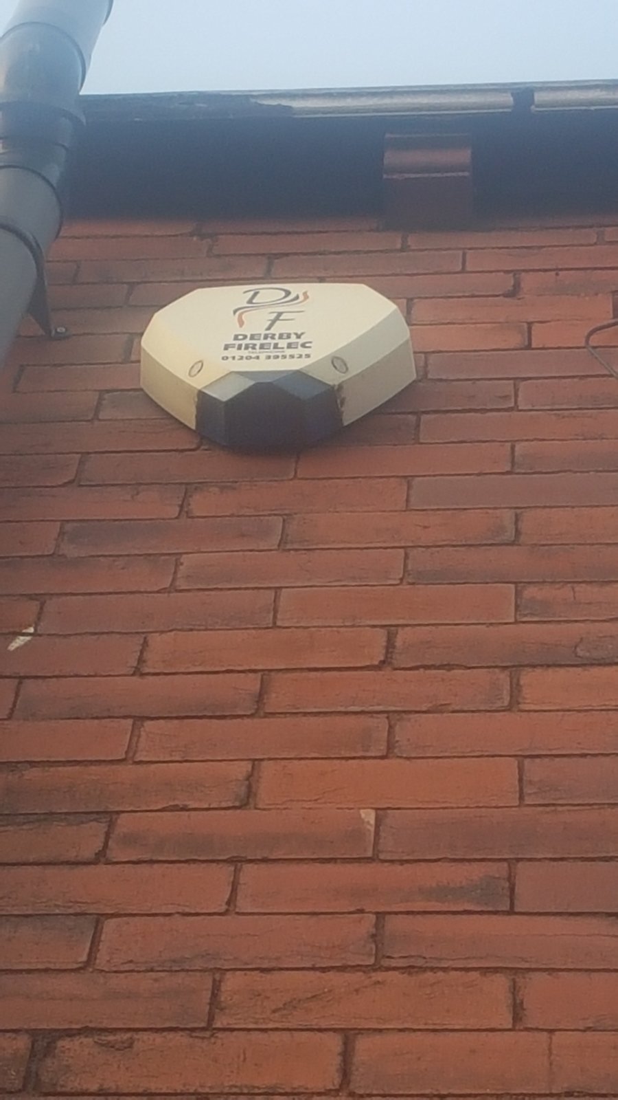

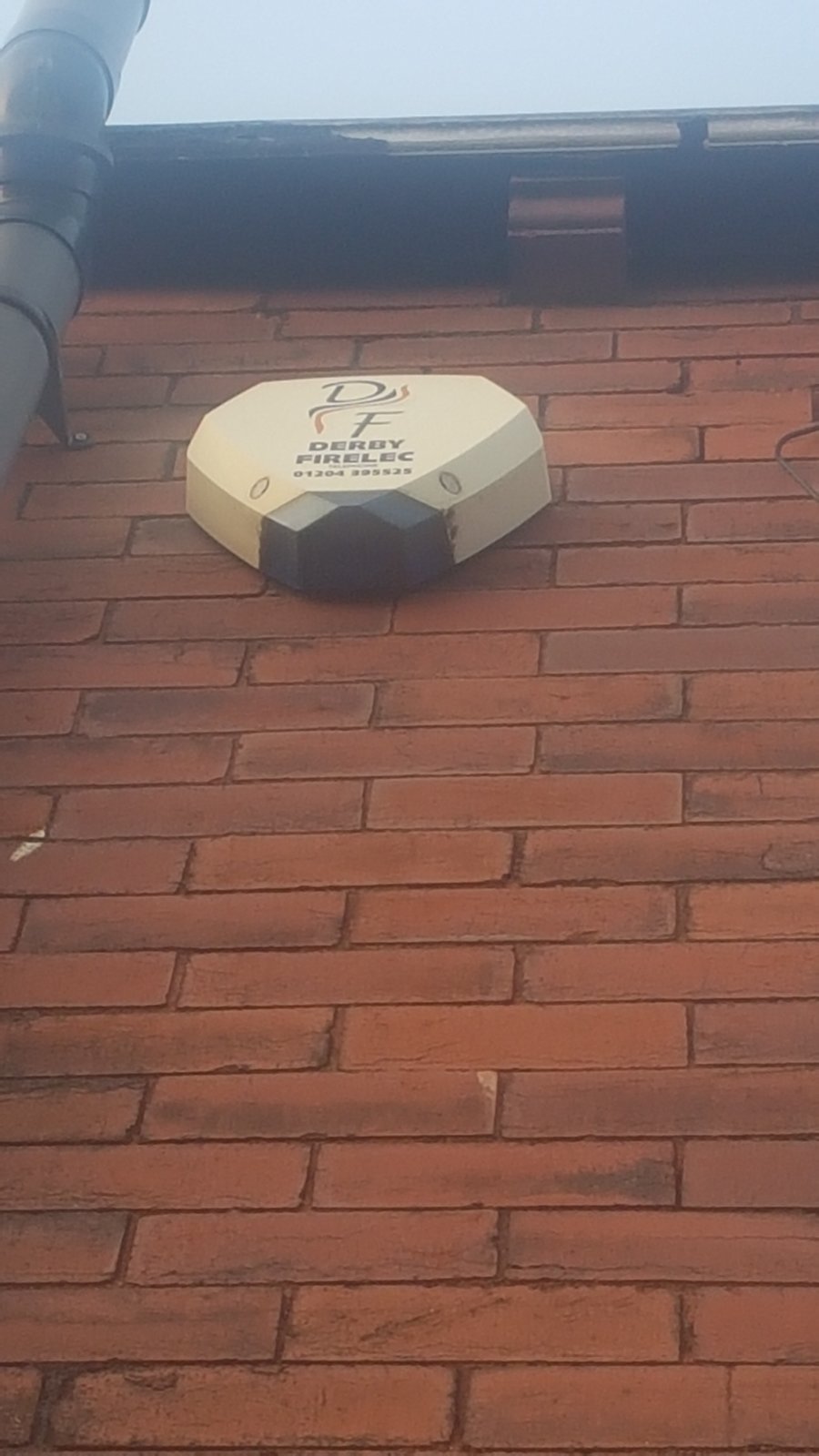

Apologies. Same here. Been on bloody computer all day. Bog eyed. Yes it's the bell box.

Not known to chirp .....unfortunately it’s a ladder job , check for water damage / micro switch adjustment and dc voltage at the bellbox ...
Super. Bit strange. Its stopped now. But I know it will come again. But I will have a look.

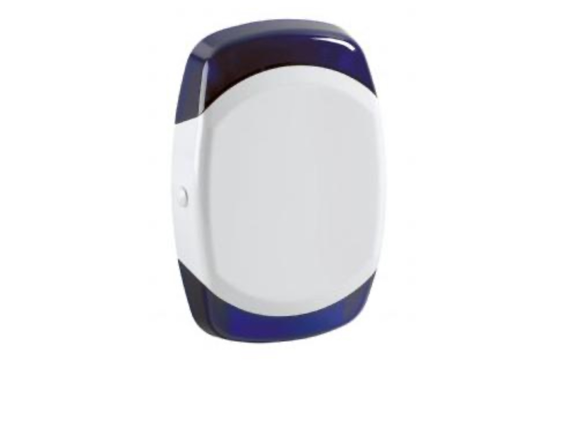

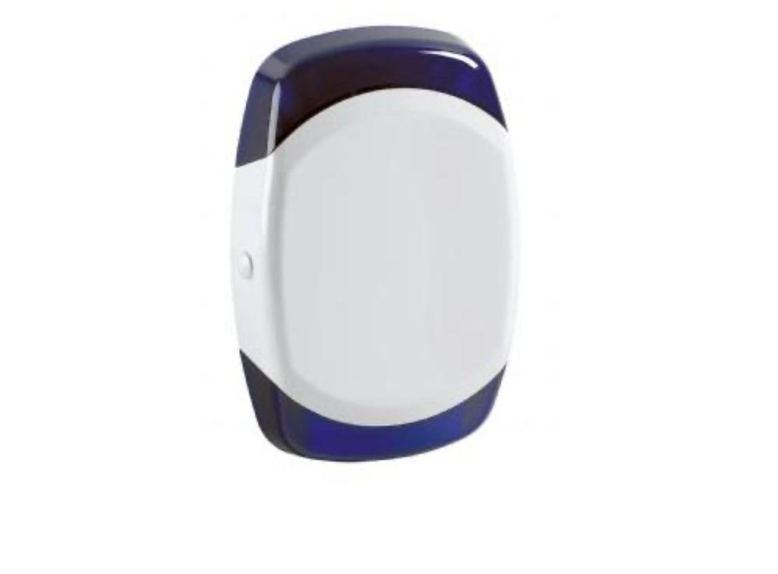

Is it one of these CQR sirens? This is the only siren I know that chirps when the battery is low. There is a ‘jumper’ to turn the battery off but personally I’d replace with new.

It appears to be one of these. Presume it's a texecom?

That bell box is not a CQR one ....it’s Honeywell ....plus the bell box has been posted and it’s a Texecom 3 series
