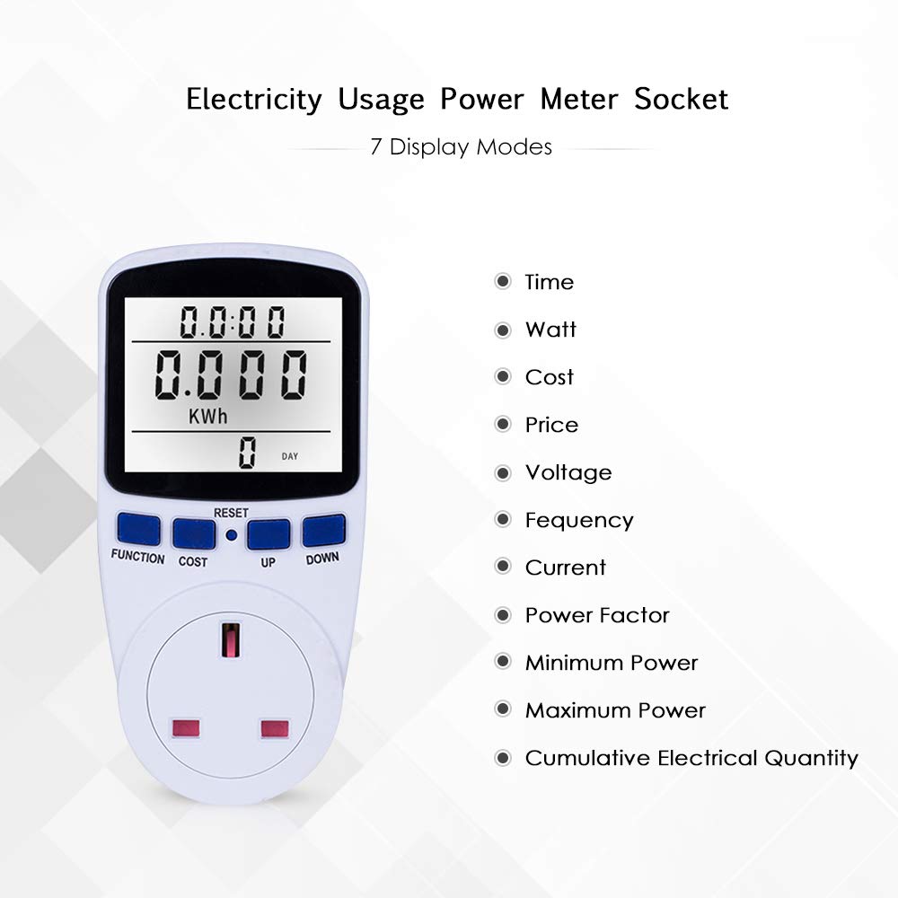

There are set limits +4% -6% so voltage can be reduced but although it may affect a shower slightly it is unlikely to affect a microwave, you can get plug in energy meters which show voltage, amps, watts and power factor so easy enough to check without the need to play with leads of a multi-meter, the item in most homes which is most affected with volt drop is fridge/freezer, and also they can suffer for thermal insulation failure so a check every 6 months is a sensible idea, and the plug in energy meter is the easy way to check.

Thanks for the replies. I'll get a voltage meter to see what it's drawing
With a voltage meter you can see what the voltage is; not the current it is drawing. If the voltage is 230 to 250 then that would suffice to indicate the appliance is faulty.
For measuring the current drawn you will need a current clamp meter just clamped over the line or neutral conductor of the flex.
This was what I was thinking about, easy to use and safe.
