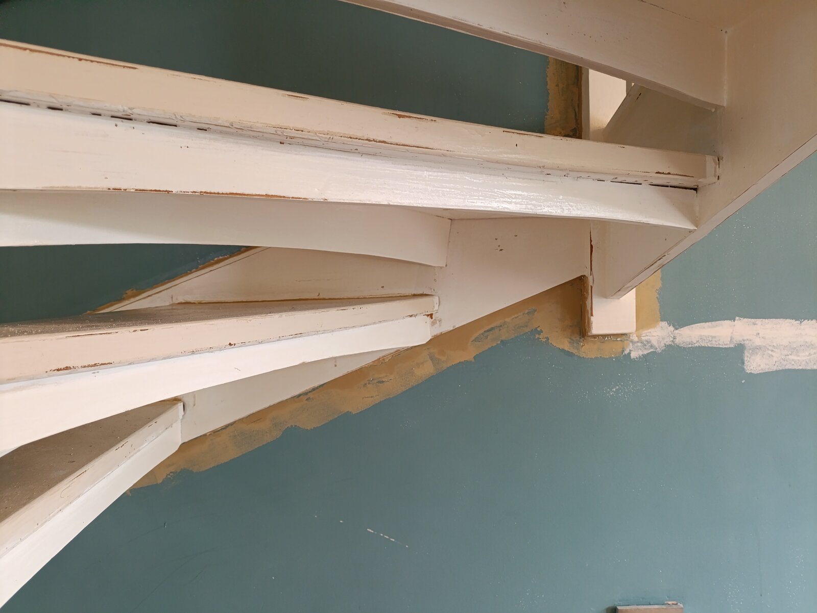

Thinking back it does seem like he didnt seem to get much done in the time he was here. He still hasnt painted the stairs, only the banister and also hasnt touched the 2 airing cupboards cupboards at the top of the stairs or the bathroom ceiling yet either, plus all of the "touching up" of which we have a whole a4 side of paper :/.
My mum told us to message him and tell him not to bother with the stairs, cupboards and the bathroom ceiling, just to redo all the other stuff, then we will pay him the 1350 still but only after its all redone properly and no more money now, which we told him.

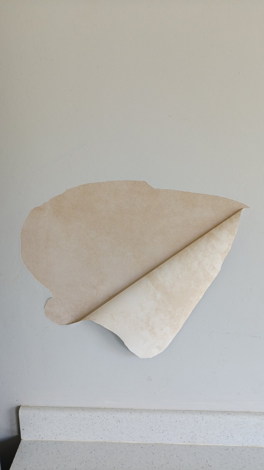

I really do not understand why he had to keep wall sanding to a minimum. Paint over gypsum plaster can be sanded all the way off. It is a different matter if the walls are the old gritty plaster. The sander will rip the plaster.

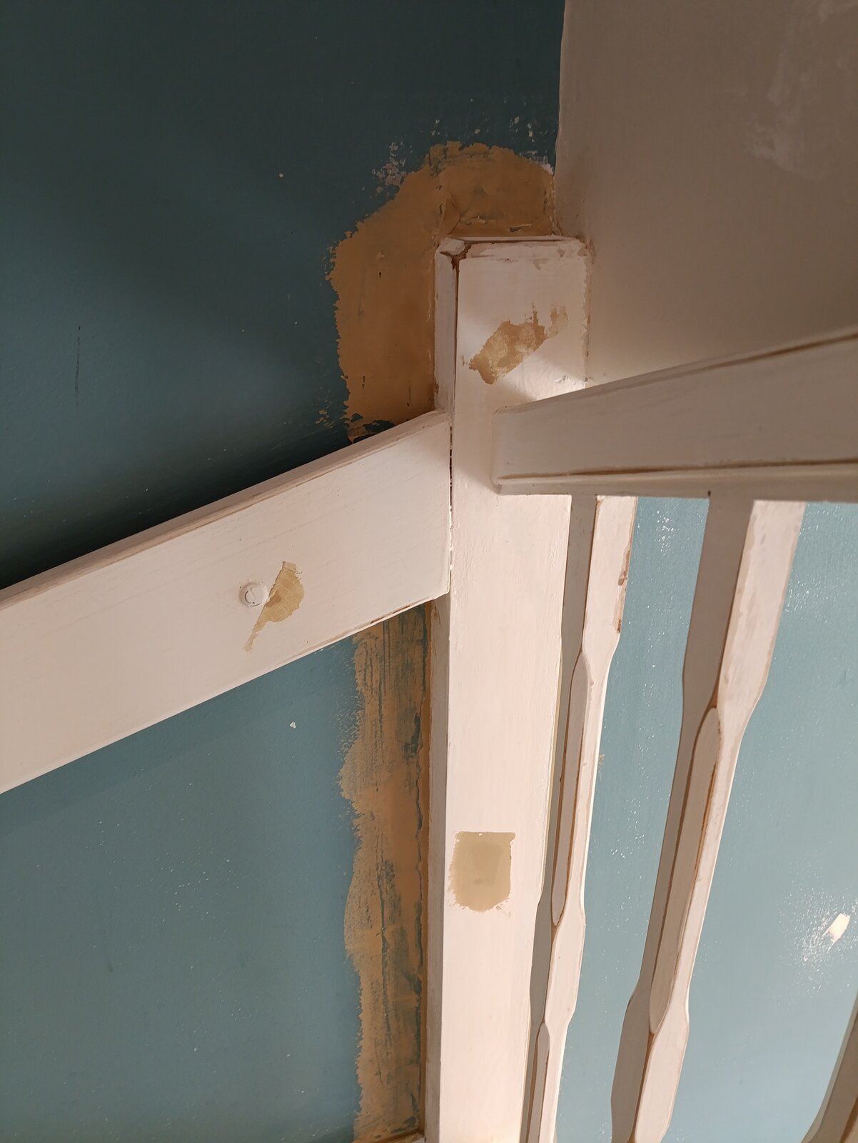

Going back to some of the earlier images that you posted, we all have days where our cutting in is below par. I explain to the customer that I will improve it the following day. I have never needed to have a customer snag it to get me to improve it. Infact, I rarely ever have any snagging, but I will have a customer ask me to add on something that they initially forgot to ask me to do.

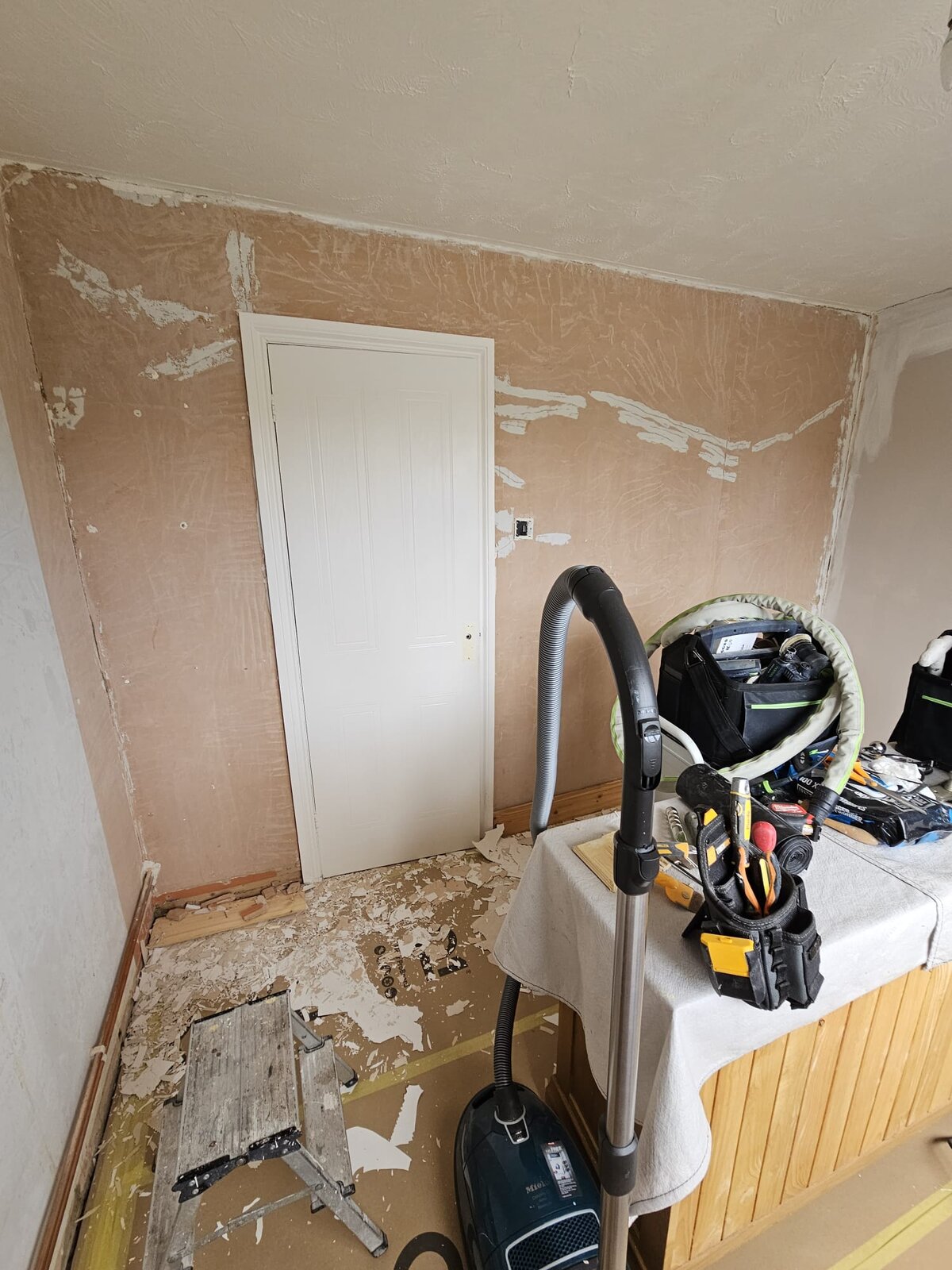

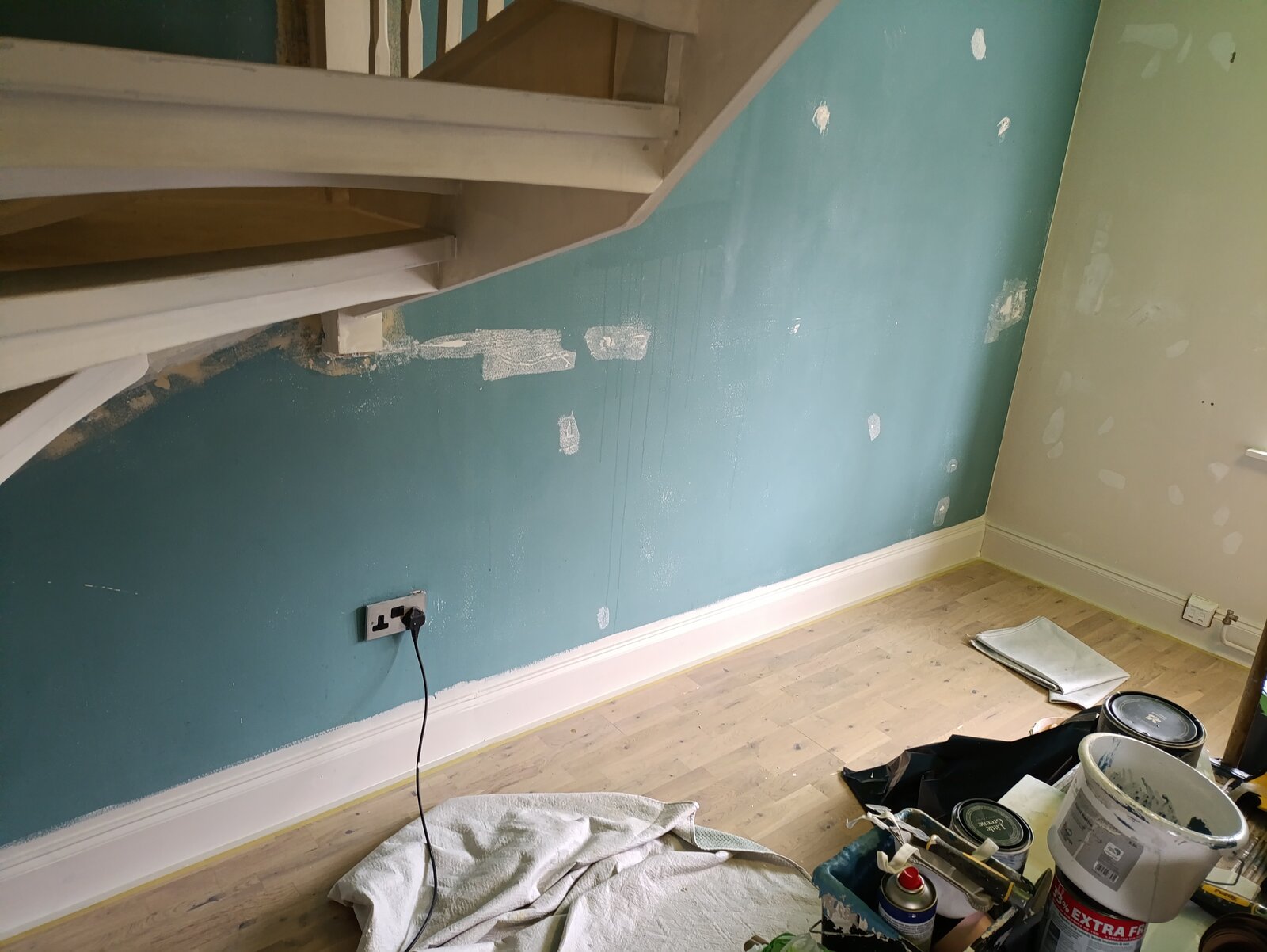

He said to us to go around and list any areas that had snags for him to do lol, even though it was almost everywhere. I have a couple of pictures I took while he was here, one of how the paint peeled off the walls and a few of the walls after he had prepared them before he painted them, also a couple of the finished rooms, they look great until you get up close and look properly.

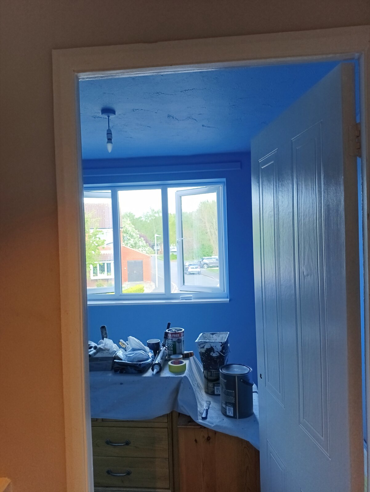

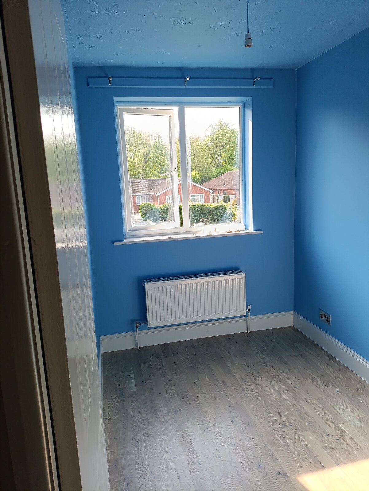

The bedrooms have same colour ceiling as walls but wen sun is out the ceiling of second bedroom looks much lighter as you can see in the picture but he just said it's the light although we aren't sure if it needs more coats, it does look same colour though when it's not daylight outside.
The room with no plaster is the first bedroom that he lined.

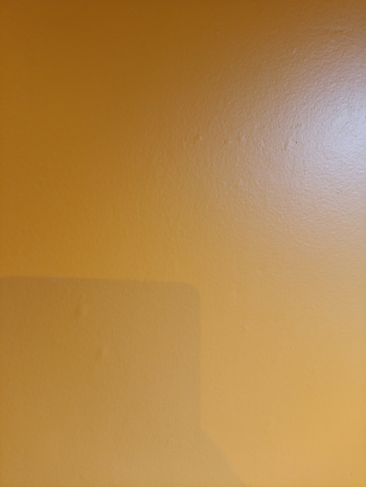

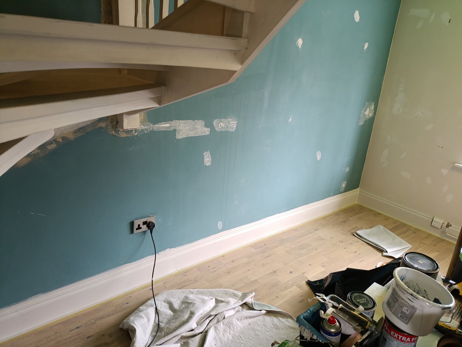

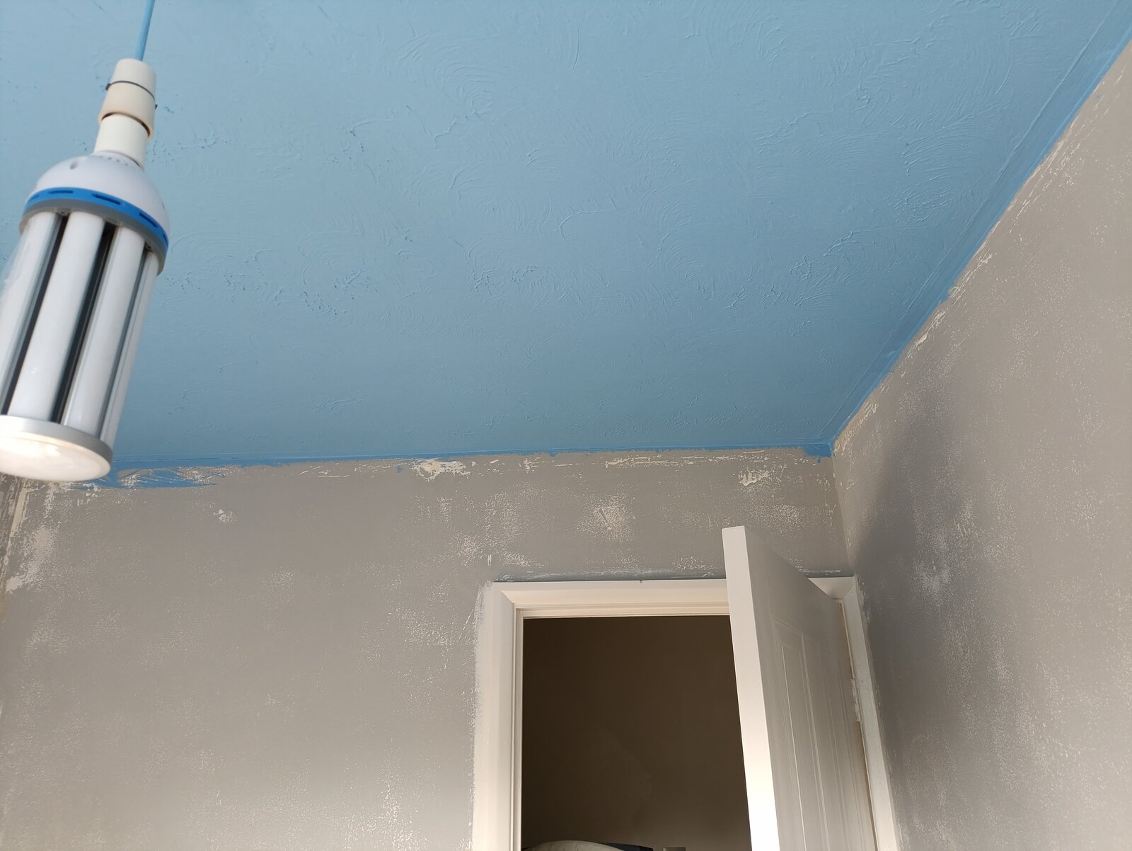

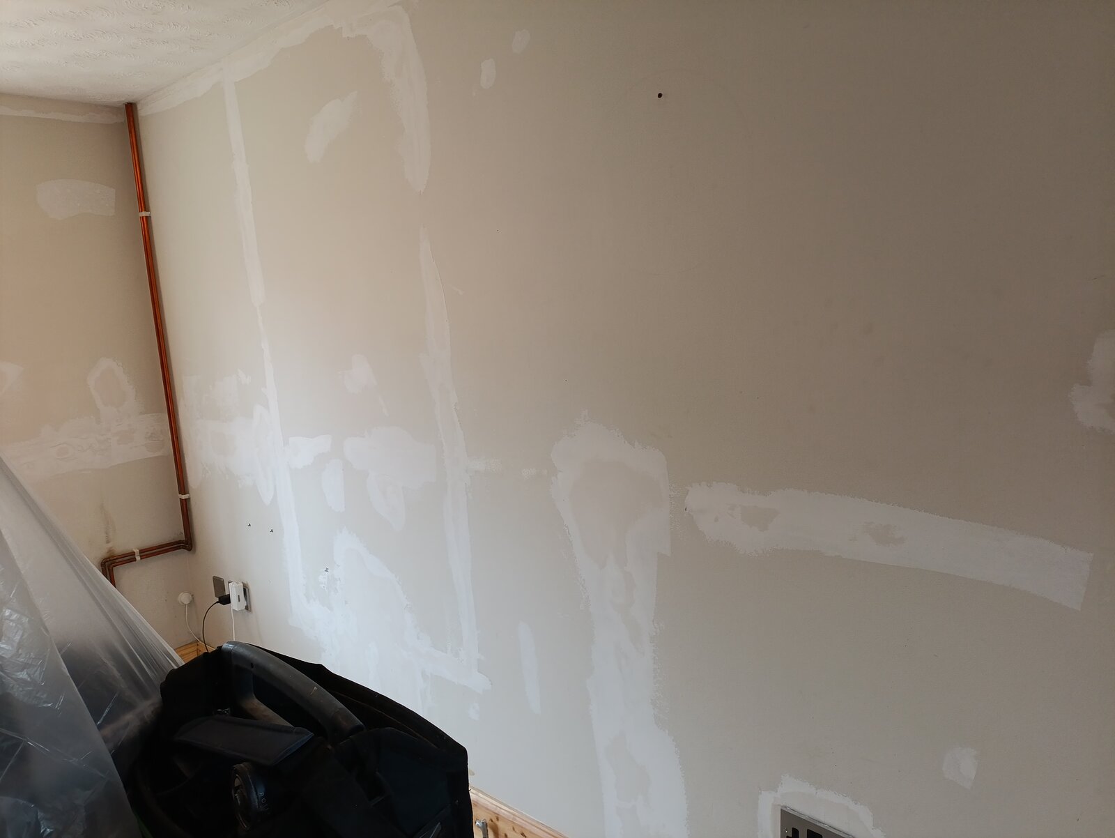

Image 9 is how the previous paint was on all the walls, 5 is the bedroom after he had fully prepared the room and also painted ceiling but hadn't coated walls, image 1 and 7 is living room wall after fully prepared but no paint except skirting boards painted in image 1
Also we never saw him washing any surfaces. The woodwork was sand, then coat with a coat of the little greene wood paint, followed by another coat a day or 2 later, the walls were filling, sanding mainly on the filler, then paint, 2 hours later paint 1 more coat, except the kitchen which he said needed extra coats
Other than bathrooms or kitchens, I rarely ever wash walls or woodwork given that I am comprehensively sanding them.
Emulsion over emulsion, on a wall at this time of the year, you can get away with a second coat in as little as 2 hours. Normally safer to wait a bit longer.

The blue room. The ceiling will look a different colour depending on the light source.
The guy has clearly sanded the walls. In his defence, you can't always see imperfections until the new emulsion is applied, but once it becomes visible, fill and sand them...

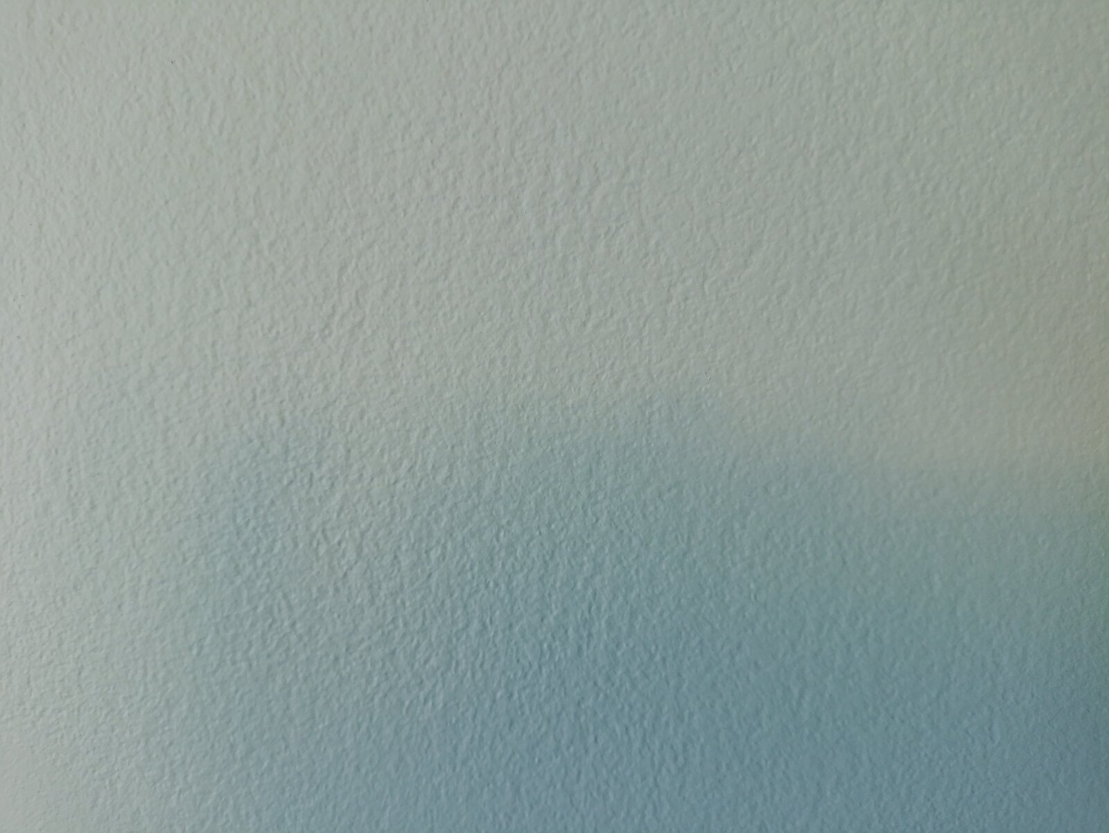

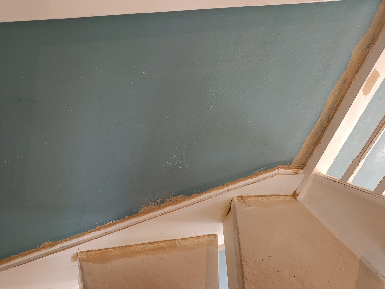

Yeah he didn't do that in a lot of places. The thing that bothers us the most with the walls, apart from the gritty paint and cutting in ect is how none of the paint actually looks flat and smooth on the walls with the exception of the lined room, how they are in this picture, although there is clearly lots of areas that need more sanding or filling ect.
First picture is how almost all of the walls are close up

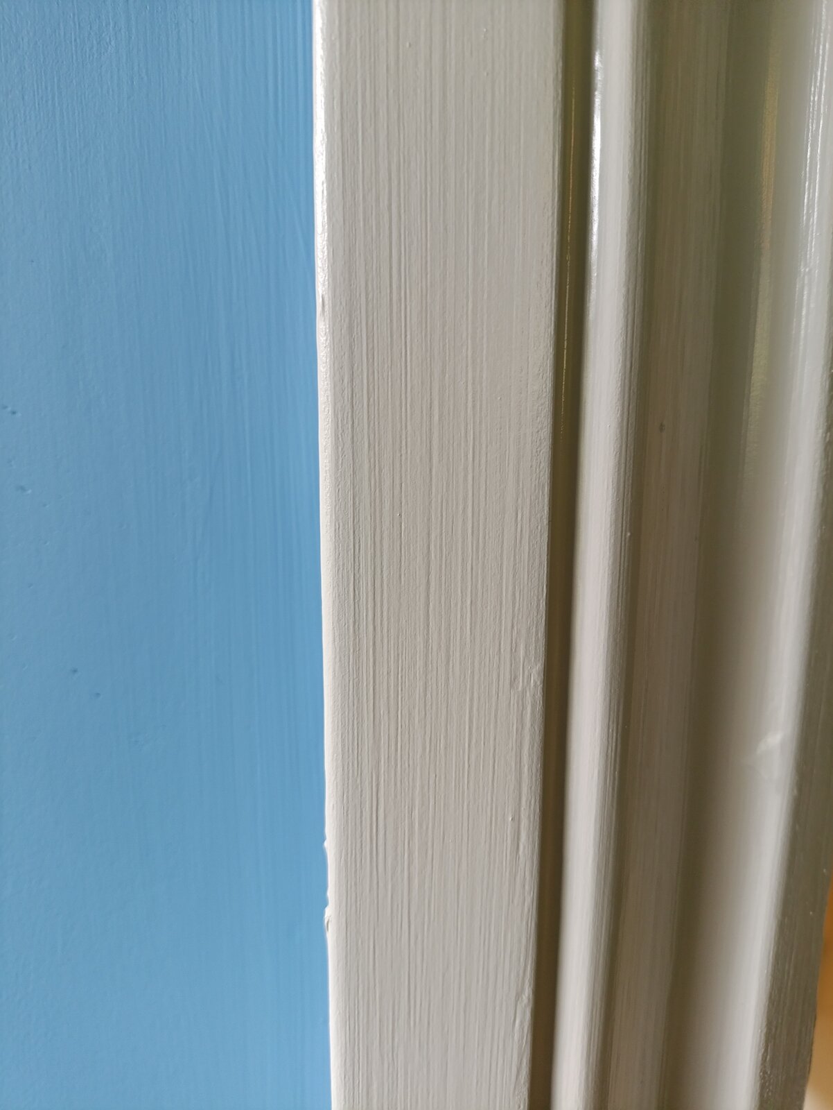

Little greene have just replied to us saying it could be he used a too high pile roller. Doesn't explain the grit in paint though. I have attached one final picture of the finish of the door frames as I didn't include those yet, the electrician said there shouldn't be as many brush lines

I asked him and he said he used medium pile and said the issue on the walls is something to do with the walls being previously painted
I am a decorator, not a lawyer.... if a customer asked me to provide a higher quality of finish, I would quote to line the walls. Materials aside, you are looking at about 8/10 hours of labour per small/medium room. The problem however is that he didn't do that when initially quoting. I cannot comment on why he didn't.
If I see excessive orange peel build up on the walls, I will recommend lining paper. If it is slight (and not vinyl silk- which gums up when sanded),I will simply sand the walls. .
I have no way of knowing how much he contributed to the orange peel effect.
