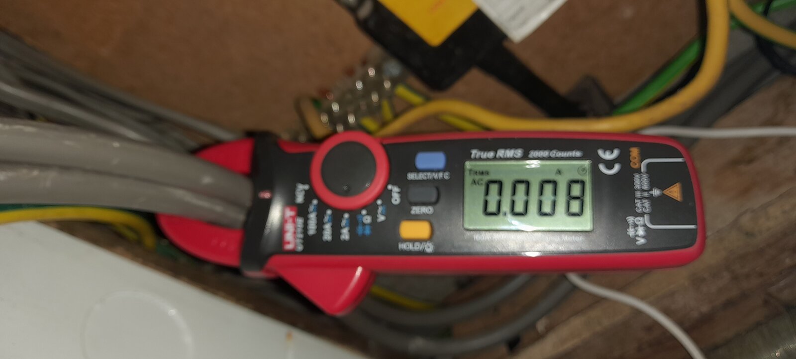

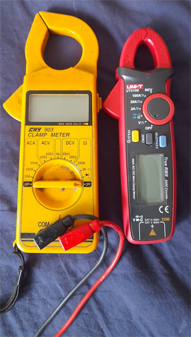

I now have a clamp on which does measure 0.001 amps, Diffrence line neutral 8 Feb 24.jpg whole house around 8 mA, however since all RCBO protected no one circuit gets near that limit, but the boiler was on a RCBO and when solar panels fitted changed to FCU without any RCD protection, so tried swapping for a RCD FCU but kept tripping, so swapped back, I had intended to investigate, but never got around to it, however odd it tripped the RCD FCU but not the RCBO.

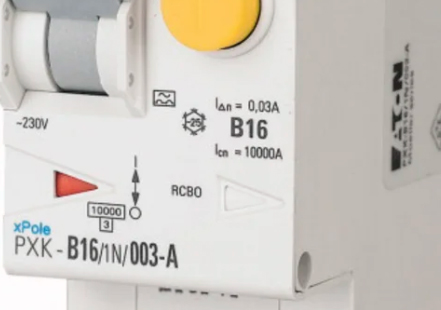

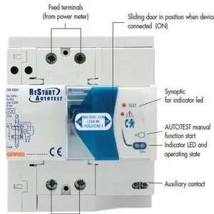

I have had it in past, RCD tripping, did test shows OK, but swapped RCD anyway and problem cured, and yes tested replacement and passed all 6 tests. I did consider fitting the
auto resetting type, or type with built in warning X-pole.jpg the X-Pole rotten name to google, get anything but RCD's.
However moved house and RCBO's seem to work great, only problem they said type B on the box, but after they were fitted realised all type AC curve B, not seen a single module width RCBO better that type A, but since the RCD is secondary protection as house TN-C-S can't see the point changing to type A now. After all type A only good for 6 mA so unless some thing trips at over 6 mA no real point fitting.
The was a John on this forum who would tell me he had two RCD's to cover whole house and he had no problems, however lost the contents of 2 freezers just before we moved due to a RCD trip, so did not want a repeat of that, so for peace of mind fitted all RCBO's except for freezers which use RCD sockets, and are on an UPS supply.
I suppose my old clamp on with 10 mA increments should still show if there is a high back ground leakage Clamp-meter-small.jpg to left, most RCD's need over 20 mA to trip, problem with insulation tester is it uses DC, and we have an AC supply, so there will always be some capacitive and inductive leaking, which means instead of needing around 26 mA to trip it, only 18 mA would trip my house with a back ground leakage of 8 mA.
