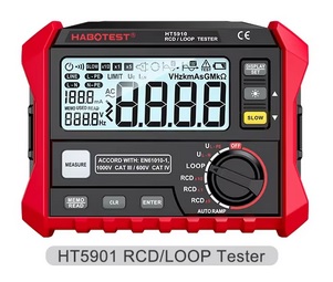

Have you got an RCD tester with ramp? Would not normally ask this, as rather expensive kit, but electrically wise your not normal. So can you ramp with nothing connected, and then with all normal loads connected and see the difference, which would be back ground leakage.
My RCD tester died, and my wife promises me a new one for Christmas Loop impedance tester.jpgI will be interested to see how good it is, as rather cheap. However before my old one failed, tested dad's house, no fault found, RCD gave A1 results, I had spares so changed it anyway, and fault vanished. My first thought was replacement faulty, but no, that also tested as OK.
Of course I have - how else do you think that I measured the trip threshold?
Fair enough. As I've said, there is very little scope for 'background leakage'. Apart from the lights, the only other 'normal loads' protected by the RCD (unless I plug something into a socket!) are three PIR detectors (Class II, with no earth connection, hence no scope for L-E leaks) and a fridge.
I've just tried several times. With all lights and the fridge on, the IΔn is 26 or 27 mA. With lights off and fridge disconnected it is also 26 or 27 mA. This therefore seems to confirm that, as expected,the 'background leakage' is roughly zero!
