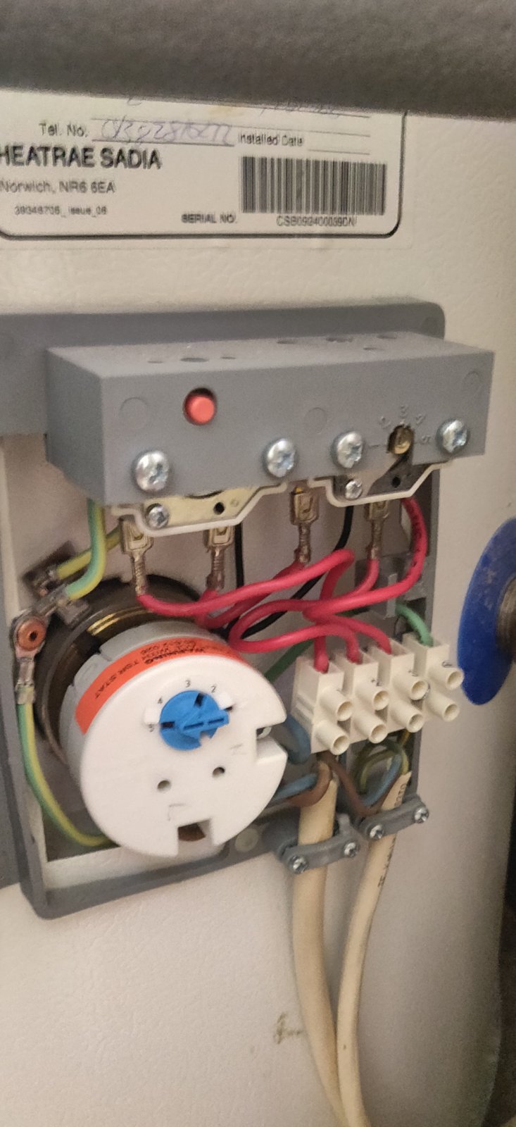

Potterton Megaflow system - no hot water
I tried the red button on the indirect cut out at the top left of this picture, no reset required.
Still struggling to get someone locally!
Hi Ian, turned out to be the cylinder thermostat. Picked one up from the plumbers merchant this afternoon. Took 10 minutes to fit and I’m back up and running.
