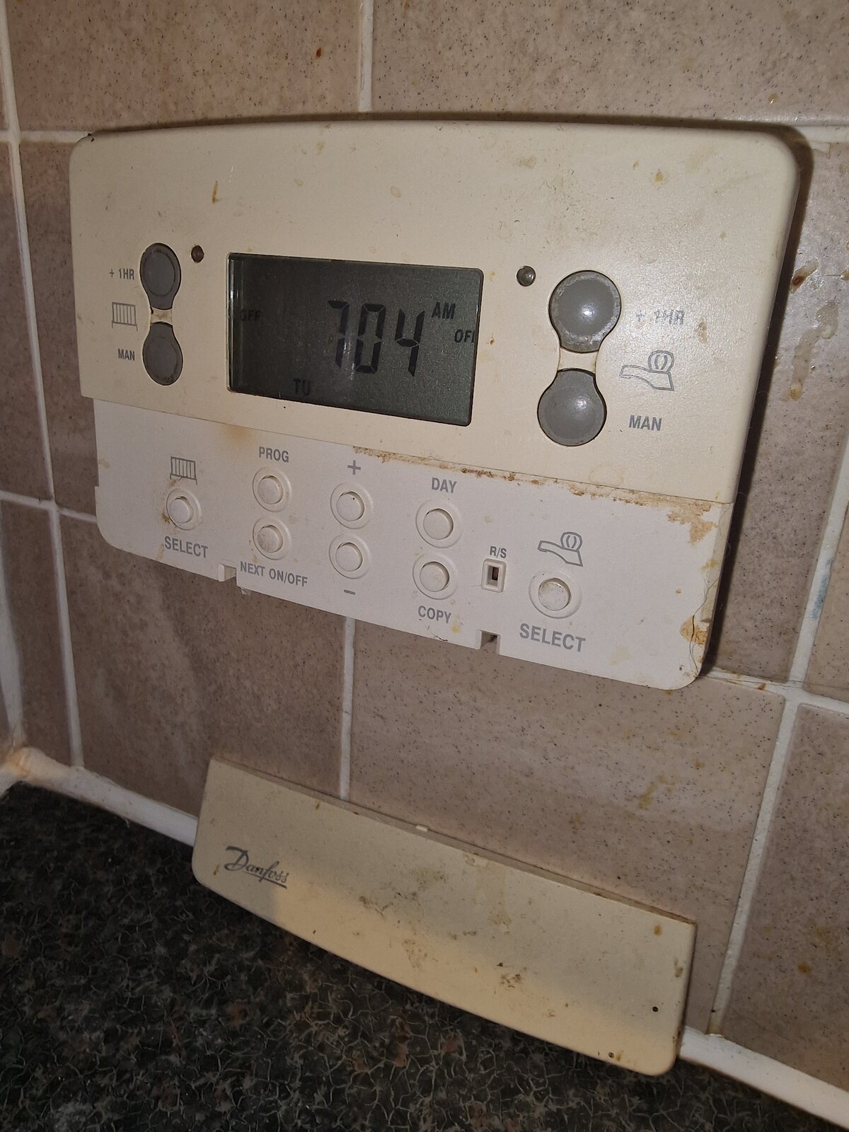

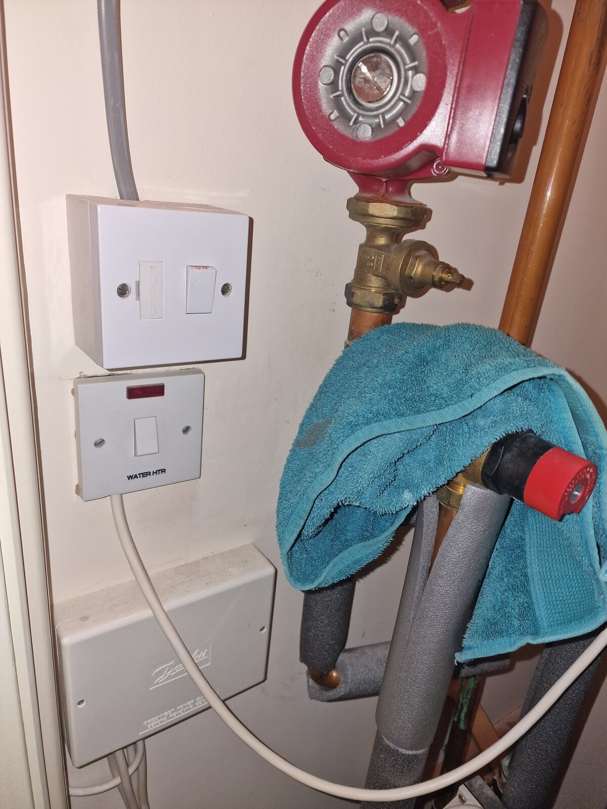

Fast forward a couple of hot summer days and I'm in the kitchen and realise the boiler is happily cracking on despite the hot water demand being off from the danfoss thermostat?! There's another danfoss box up in the hot water tank cupboard - is that likely to be it's power switch with fuse above the immersion switch? Anyway what do I need to do to fix the demand side? both Potterton PCB's seem to work fine, unless they've both failed in this exact same way? I'm more suspicious that after being turned off for a couple of weeks something has happened with the danfoss?
